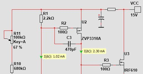

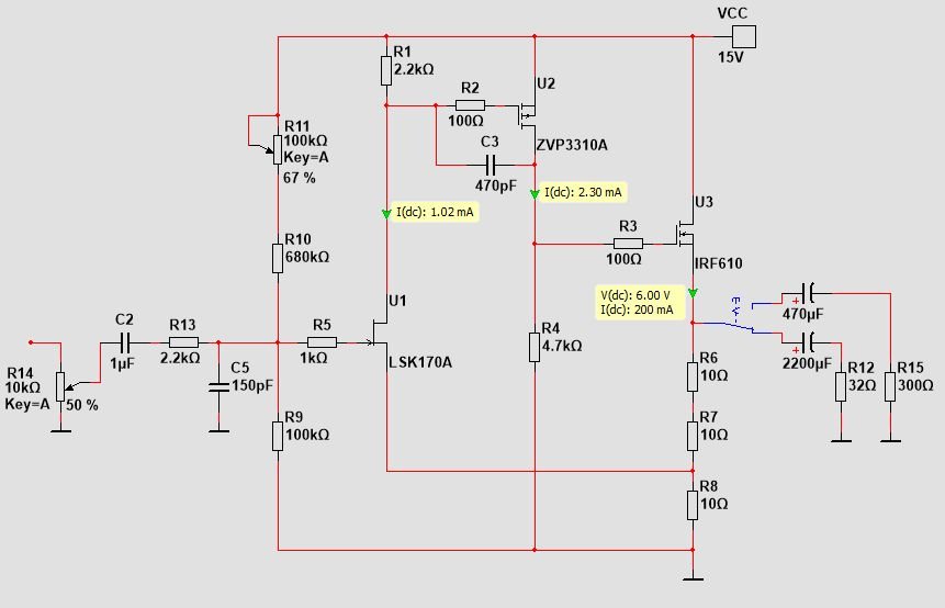

I post the schematic once again for discussion.
What is missing is a decoupling of the power supply to the input stage.
As is now it will have very poor PSRR.
The recommended supply is a LM317 regulator at 15 Volt.

Like this?

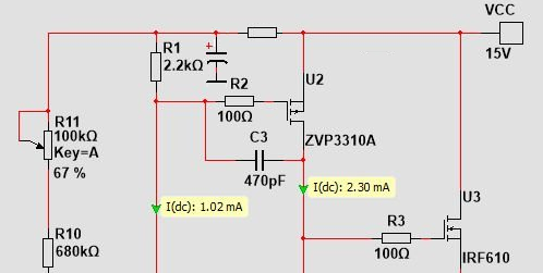

Or like this?
