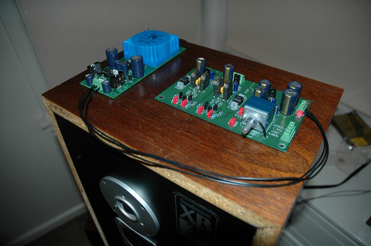

Pre3 complete

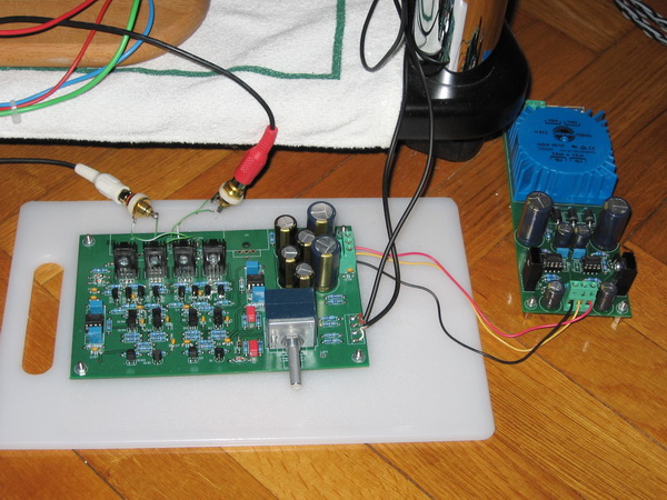

Hi Pavel and gang,
The PRE3 is all setup and driving Rod's P3A amplifier. Firstly, I found no difference with the preamp in or out of the system. It is behaving invisible to the audio chain, but providing huge gain (10X) without any hum/hiss.
This is a preamp for those who want to hear how the power amp sounds like, without adding any distortion/tone/sound signature.
I don't have the Dispre 2 Jfet with me now to compare, but if I recall, they both are almost identical in nature. Transparent and clean and absolutely quiet.

Nice work, chlorofille!
Seems you have setup full gain, 20dB, I see no input divider. Do you plan to use signal sources with lower output level, like cassette player or MP3 player?
Pavel,
That's exactly right. I have friends coming over and they want to test their tracks on MP3 players etc. My current source has a digitally controlled volume and it's output is quite low so the 10X gain is very handy. No noise at all so I guess the gain is good to have.
My new speakers (currently in building) have a sensitivity of around 86dB and will require a full 50W minimum to come alive.

I have to confirm the fact, that jfet-dispre is extremely natural sounding preamplifier. I have tested many discrete and opamp designs, but this is really what preamp should be: piece of wire with gain or impedance converter🙂
Only area where I can see some place for improvement is to add some stepped atenuator like DACT instead of Alps, or remote control relay volume controler...something like this: vicol audio : r-2r volume controller
The question is, if adding relay volume control could somehow degrade noise performance of this preamp? Output impedance variations also concerning me...

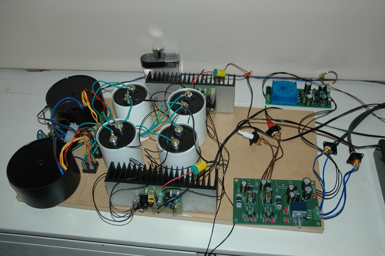

Hi supernet, your choice of components looks very similar to mine. Are those PS caps Panasonic FC's ?
Did you notice any sonic signature of the dispre2 ? I found slightly less bass(compared to Rod's P37A discrete preamp) as all the frequencies are so clean with ultra low distortion. Glad you are happy with the preamp.
Yes, the bigger caps are Panasonic FC and smaller one FMs.
The sonic signuture is very transparent and natural...maybe a bit more on warm side of neutral. Actually it suits my needs very well🙂
I agree too 🙂
BTW: It is OK that two output transistors with original heatsink gets quite hot during operation? (max 3 sec finger hold) Or should I install some bigger heatsinks?
No problems. I used the same Fischer heatsinks. They get hot but Pavel says not to worry.
Then, I was in a surrounding of 23 deg C ambient.
