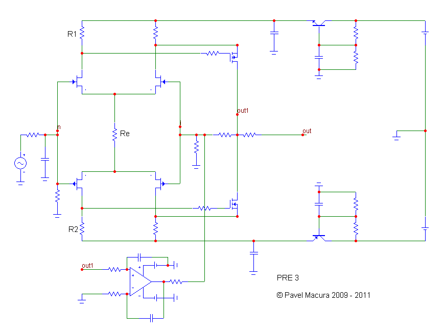

I have a new JFET/MOSFET complementary-differential preamplifier, please visit
PRE complementary-differential preamplifier
and see the attached images.
Yes simple and elegant (and good sounding), and important to mention IMHO: It´s actually a John Curl design.
R1 and R2 values have to be selected according to Idss of the matched JFETs. But the task is not very difficult, and digital multimeter is enough to make it.

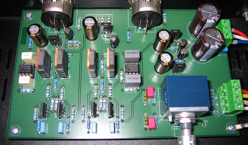

From the photographed pcb on your website I concluded that the cap multipliers are shared or am I mistaken ? Would it not be better to have separate ones for each channel ?

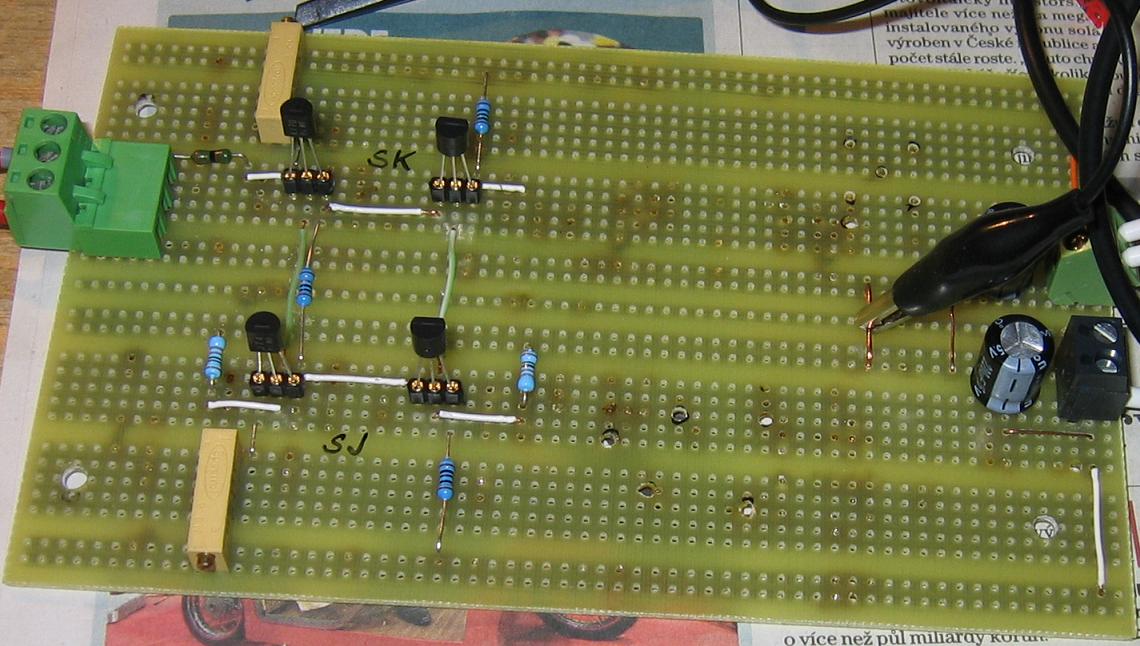

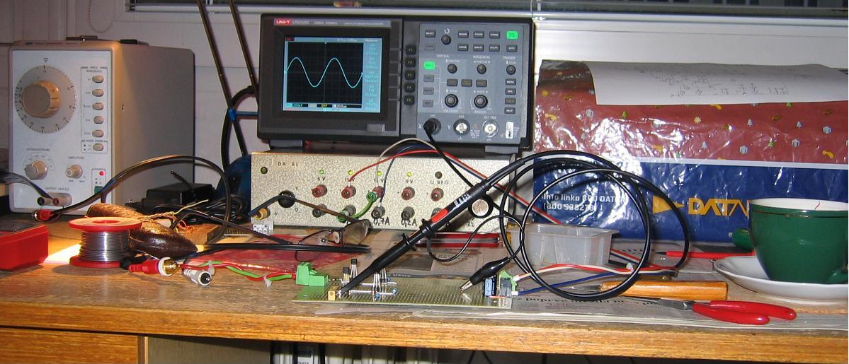

This is a setup to match JFETs 🙂

I think your pre amp looks great.
Interestingly I just built a pre amp that is similar ( based generally upon the borbelly line amp ) using J fets in a symmetrical differential at the input and with 2 mosfets at the output connected to the input in a similar way to the one you have choosen.
My measurement equipment will a lot more basic than yours but I seem to get lower overall distortion when I cascode the front end jfets.
I had not adjusted R1 or R2 but I have been adjusting Re. Have you found that adjusting R1/R2 instead of Re gves lower distortion?
picture in 1st post shows 2sk389/2sj109.

Do you use monolithic JFET or matching by hand?
Hi AMV8,
yes, because the key is to keep input JFETs in the most linear portion of the transfer characteristic, and R1/R2 serve only to set appropriate Vgs bias of the output MOSFETs. For more info, please visit
Both. The 2SK389/2SJ109 are very difficult to purchase, in fact almost impossible. For this reason, there is a PCB design for 2SK170/2SJ74, and the devices are hand-matched.
Why do not you, constructs from inaccessible parts?
