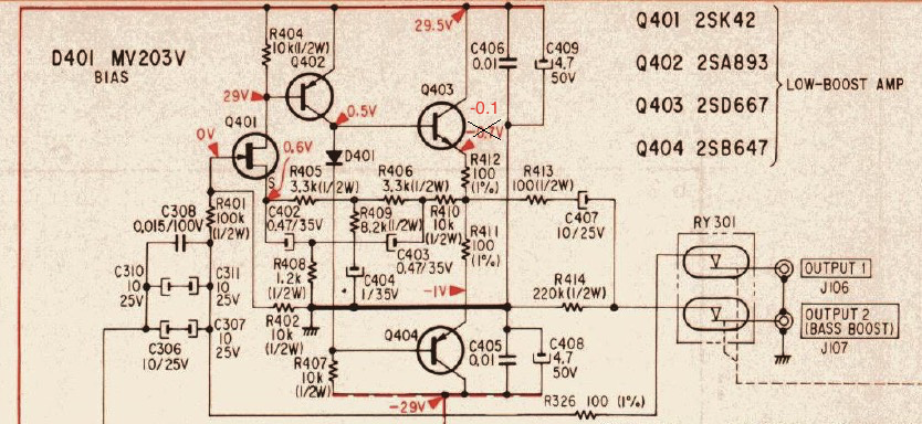

2SK42 jfet, rated at Vds 10Vdc max. Commercial application, running at 29Vdc.

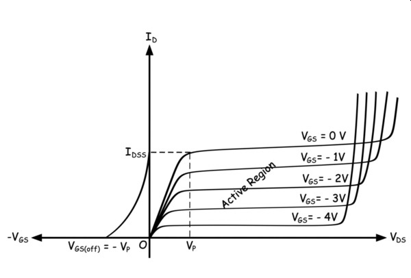

I've used 60V on a 40V Jfet but only as a cascode (or common gate) and at mA currents. This does not seem cause breakdown. But the Jfet becomes very nonlinear as the field shape becomes distorted and pulled toward the drain. -Vgs vs Id will increase but in a nonlinear fashion.
That ohmic region is most interesting, as the curves there are the reciprocals of the transfer line but 'biased' by the Vp-Vds rate. Not always clearly visible in the graphs, though it explains a lot about the behaviour of cascodes. And being ohmic, it resembles the triode output char's topsy turvy.
