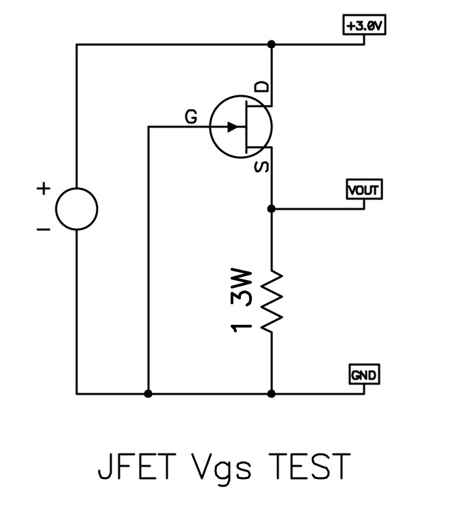

Since people are going ahead on purchasing the Lovoltech
power JFETs, I thought I would share some of my matching
data.
It's quite simple, as seen from the circuit. A measurement of
the Vgs under identical conditions is adequate for most
applications. The value is useful for creating differential pairs,
and in cascoded single-ended applications becomes valuable
when selecting a Source resistor to ground.
In the case of selecting a Source-to-ground resistor, the value
of the resistance can be used to set up the optimal load line
for the lowest distortion.

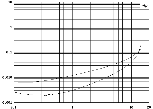

Depending on all the other usual factors, optimizing the
Source resistance in a cascoded single-ended system can
improve the performance quite a bit. Your results will vary
somewhat, and so for a given circuit design, it is necessary
to test to find the optimal values, but here is an example
of a distortion curve in an arbitrary system where the cascode
has a grounded Gate. One curve shows the untrimmed value
of Source resistance, and the other has been adjusted slightly.

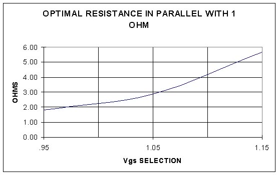

For this same circuit, here is a curve of optimal resistance
values for a range of Vgs values. Again, this is simply an
example of a single design, and these values should not be
applied in general. For a given design, there will likely be a curve
which resembles this in principle which will obtained by actual
testing.

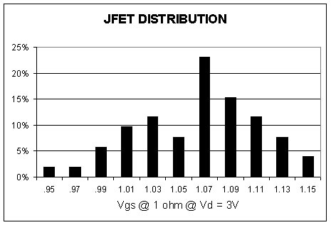

Nelson Pass said:
Here's a distribution of values of the population of a couple
of tubes:
one thing which never ceases to amaze me is that when I match a couple hundred HexFET's or Lateral MOSFET's I always get a bimodal distribution of values -- even when they come in a case of 300 or 360 devices, at least for IRF and Renesas products. I wonder what kind of "titration" is done during the manufacturing process to "effect" this distribution. From a "mean-variance" standpoint it would make the distribution look quite good, but when you do a histogram (a la NP) the utility of matching stands out.
Of course, if you use a bigger hammer the bimodality goes away.
Confessions of a parts matcher.

I received 25 unmatched Lovoltech 1014 N-channel Jfets from Grey Rollins and thought I would share my matching numbers.
The test setup is as Nelson described. 3 volt supply, 1 ohm source resistor. The Jfets Vgs ranged from 0.97 to 1.22. Out of the 25 units 28% fell in the 1.17 to 1.19 Vgs range, another 20% fell into the 1.11 to 1.13 range. Plenty of matches.
BDP
