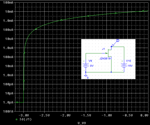

Plotting a *SPICE* model on semi-log paper, we get the idea that the Id drop-off is VERY sudden near Vp, and it may not be TOO critical what current we define as "cut off".
2N3819 and a model I found for NF5102.
Yes, SPICE models are NOT carefully checked for very-low currents like this. It predicts the simple math observed from "normal current", and rarely tries to include the low-current effects.

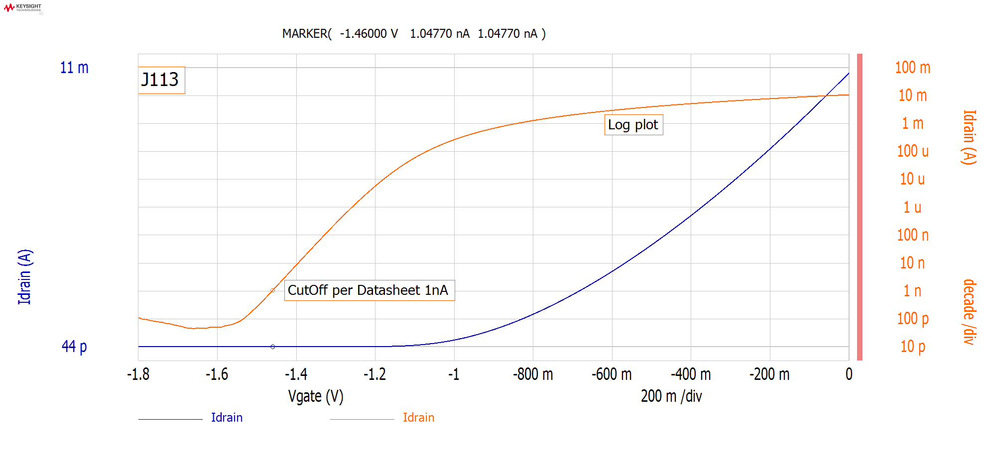

Hello,
“the top of the knee is ill-defined” is accounted for by the LAMBDA variable in the text book model.
Measurement of the CutOff voltage does not drop off nearly as suddenly as the SPICE model plots. See the attached real world measurement plot.
Thanks DT
