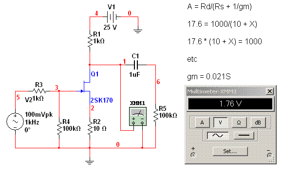

Want to measure pinch-off voltage, or gm?
