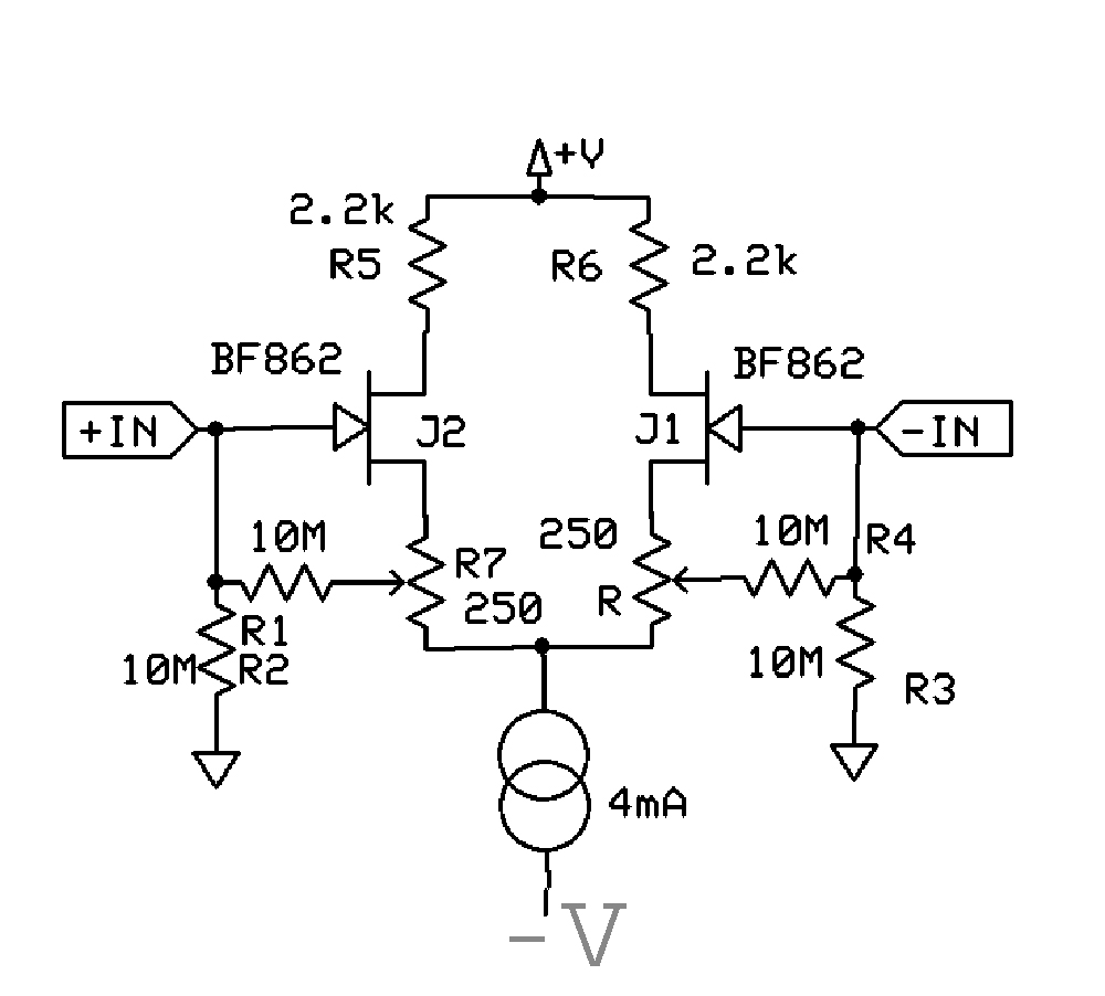

Your circuit in
http://www.diyaudio.com/forums/showthread.php?postid=1761341#post1761341
is a perfect example how NOT to design with JFETs.
Am I missing something? AC coupling means zero current into gate resistors means Vgs =~0. FET's crash close enough to plus rail so Vds is low enough for .5mA at 0 Vgs? The distortion will be very bad at this operating point.
I general Hannes I agree the case for obsessive JFET matching is overstated. The folks that claim to get only 3 or 4 quads out of a bag of 1000 are shooting themselves in the pocket book.

Hannes -
This arrangement of LTP is good for -100dB (simulation) seconds for even 2:1 Idss. Yes, J1 = 15mA and J2 = 7.5mA. Operating current must be tuned to 2mA per side. AC coupling of course.

Hi Scott,
Crazy stuff! It would be interesting to see wether it also holds up on the bench :D
EDIT: err, 10Meg resistors. Are these these little things that change resistance already when touched?
Have fun, Hannes

No, that's just so I don't have to use any dirty electrolytic coupling caps. :) 10M are the biggest RN55C's that come standard in the assortment kits.
