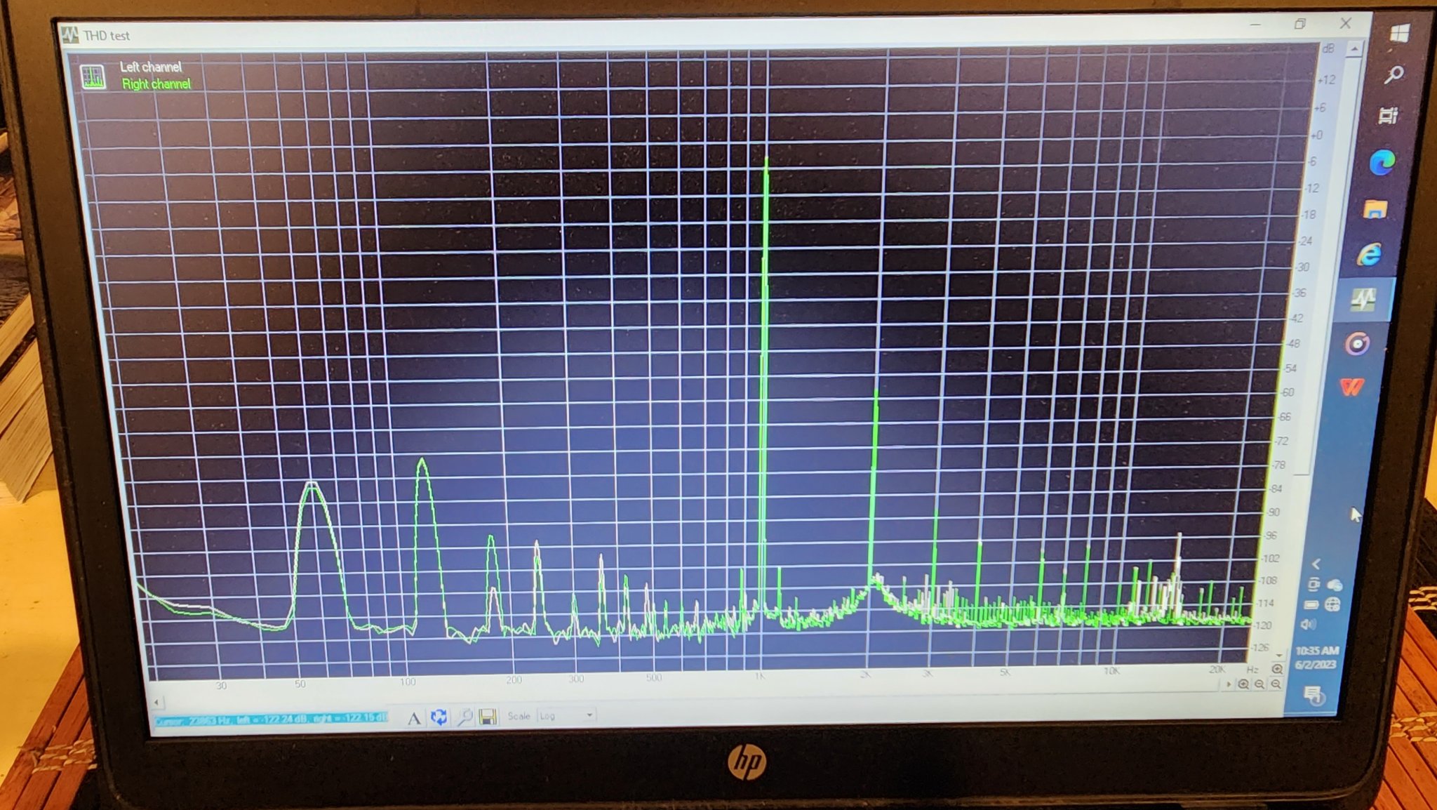

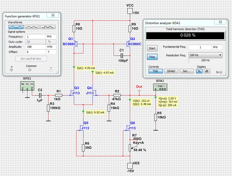

The distortion is further reduced with one P MOSFET.What happens if you replace Q1 with a 150 ohm resistor (no mirror)?
Still a lot of harmonics / distortion caused by Q2.
What happens if you replace Q2 with a low Vth (~0.7V) p-ch mosfet.
These are better in second harmonics.
Now is only THD 0.00039%
Not quite gone 🙂
But I doubt you can hear the 2nd harmonic at this low level.
Still my first post schematic is the one I believe in. THD 0.117%
Perhaps also the 10 Ohm emitter with THD 0.028%
