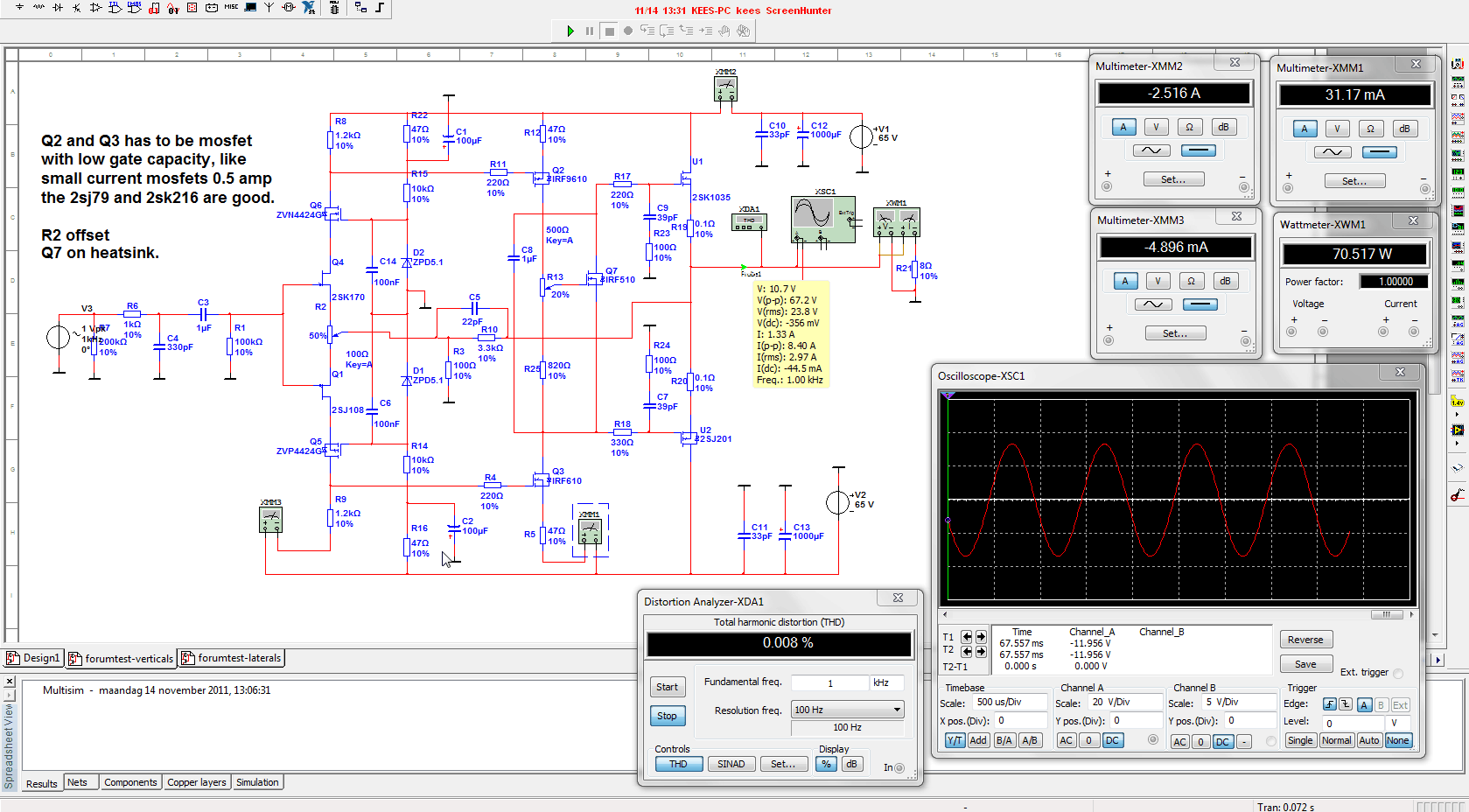

promised I put here the version of thread JFET input, MOSFET VAS, LATERAL output = Perfect! here.
I have make some changes in the jfet input and the vas, the vas has higher id of 20 mA maybe it has even higher like 30 or even 50mA to prevent distortion in the drivers in relation with mosfet capacity, vbe multiplier is not simulate properly and has to be made in real, carefull!..
I will post sometimes progres and tests, but only simulation, people here can test it in real, I do that also but I have only scoop not THD meter.
We try to make it as simple as possible, less parts better sound, oneven harmonics weh have to fight even harmonic is of less problematic because it give music sometimes a nice body.

hi kees52, what do you mean by "vertical output" in the thread's title - your schematic shows k1058/j162 which are not vertical but lateral MOSFETs ?
Also, the way you did cascoding of the input stage is suboptimal - Q1 and Q4 have too small Vds (0.2-0.3 V) to work properly. You should choose cascoding devices (Q5/Q6) with higher Vgs(off) like k246/j103 or you can raise gate potential of Q5/Q6 with voltage divider.
Not to forget, Vds(max) for 2sj108 is 25V and Q6 in your schematic works with Vds of about 35V - a risky strategy...

Hi all
I have post the wrong schematic, and I now that the resistors are differend for both fets, but this has to try en measured in real time.
The cascode of j fets has advantages lower miller and more voltage, until now we have to keep voltage low, but I think we have to make the design more complicated, and put some fets in work, mirrors, ccs?
The j fets I have in schematic is because i have not much choice in multisim, the higher vgs jfets are not there, I will put them in and try the simulation again, and post itm or use enhanced mosfets with deviders as replacement..
Hmm be aware, I am not a scientist, but hobbyist like the most here, praktice do it not the school calculations is my experience..

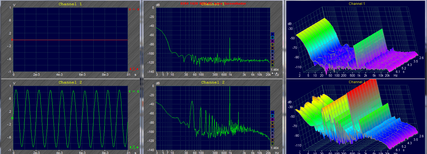

Hi her a new version who has not the mentioned disadvances, the j fets get now a lower voltage and are cascoded with higher voltage mosfets, we call it version 2, it is nice playing with it, but make a amp very simpel with low distortion is not easy, maybe not possible.

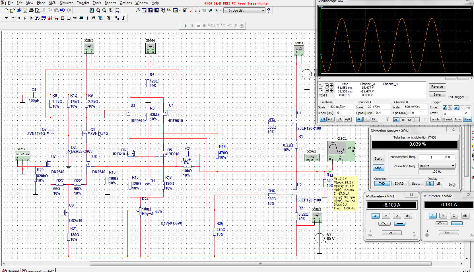

The final one to try, I have a lateral and vertical version, lateral schematic is on lateral perfect discussion.
Here is only the vertical version, I do make this one,s pcb if I have time and that is almost there.

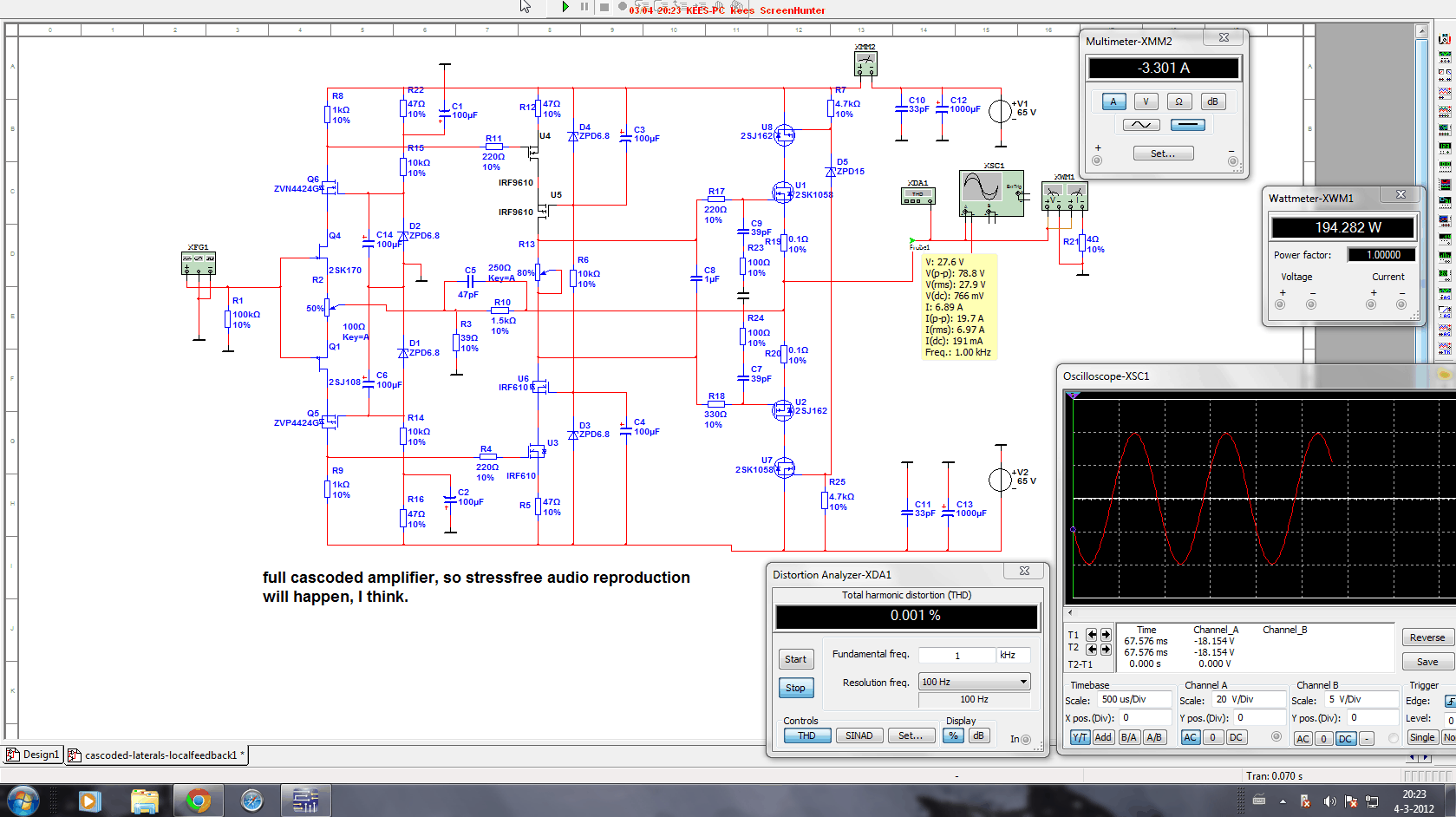

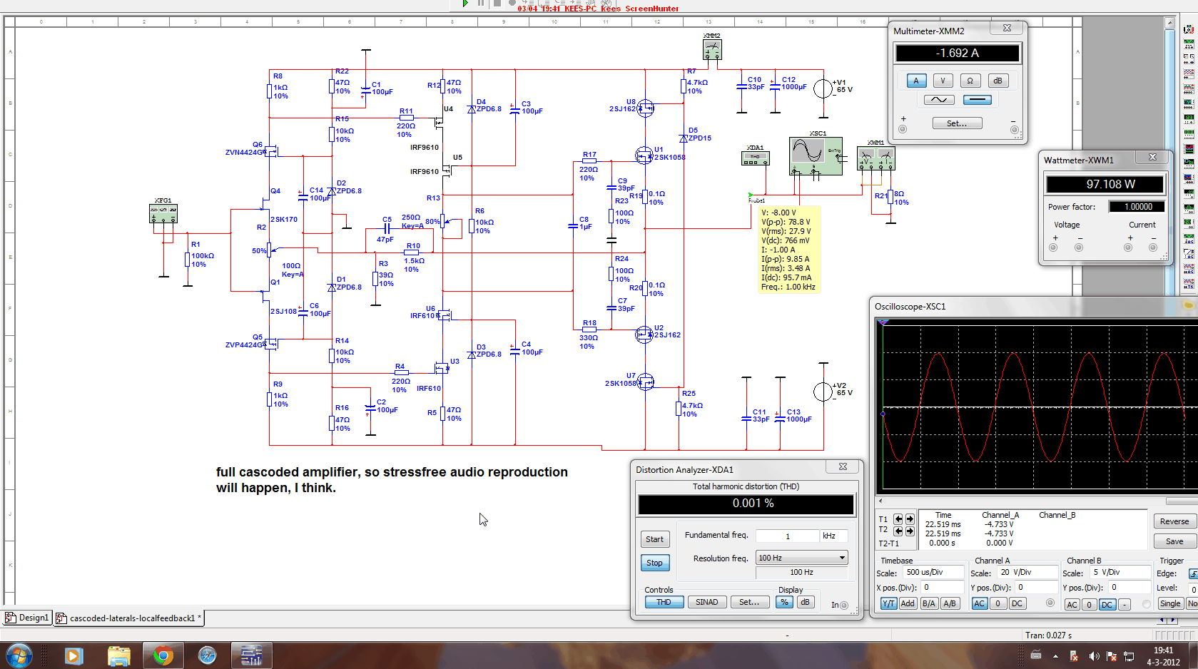

Oke, I have did some experiments with the pc, and maybe you laugh all her, it healthy I now.
but see and let me now your thoughts about it, maybe it is already here somewhere, this idea is also candidate for hybride. canceling capacitance reduce distortion considerably.
There a two schematics, one with 4 ohm load and one with 8 ohm load, the 4 ohm 194 watts, (watch distortion), but in real don,t try that, mosfets get stressed.

Kees,
This is a fully symmetrical, fully cascoded PP AB power amp, using fets, mosfets and latfets throughout, but aside from competent design, high loop gain and low THD I can't see that it would sound much different to lots of other designs built with similar components. I'm also fairly sure it would have no image depth because of mosfet VAS and global feedback.
I guess these are obvious comments, but given your interest in tubes, why not stick to your original idea of a hybrid, and try to reduce the active component count?
I believe that the more complicated you make a circuit, the less DIYers build it. It reminds me of the inaccessible oil filter in a crowded automobile engine bay; it doesn't get changed enough, too expensive and difficult. A beautiful engine then gets a bad reputation for durability! Use NP's approach, keep it really simple, and put your effort into correct component choice and very precise dimensioning.
Sorry about the long post, didn't have time to write a short one!
Hugh

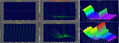

you can see distortion here.

Kees,
From where I stand, I think you have an open mind, and good electronics skills. I'm just trying to convey my general ideas, forged over a few decades and a lifelong interest in design.
Cascodes are generally used to extend HF response. In audio, they are useful to permit use of low voltage jfet input stages. I'm perplexed why you think they remove compression, but this is your experience - but it must be said they really increase the component count and can, with VAS circuits, reduce rail efficiency.
Designing for DC coupling is a good idea, but it can be taken too far, as again it can radically increase component count. We must keep our circuits simple, only when simple will they be built. And to make them simple takes more time, more care, and more inspiration, but the results can be very elegant. I'm a big fan of Jean Hiraga, Le Monstre is a masterpiece.
I have found that some people like single ended, even order distortions, some like symmetrical designs with predominating odd order, but few people like both. I prefer the SE approach; Borbely, as you rightly point out, preferred the fully symmetrical, complementary approach. We build what we like, that is certain.
On the tube front: Try using a simple plate loaded triode, direct coupled at the plate to the grid of a cathode follower. Use a double triode like an ECC81, since mu is around 50. You will find this sounds very, very good, has sufficient drive, and the sound quality can be manipulated slightly by increasing the CF tail resistor one standard value over the plate resistor. Power supply is not too critical with this approach since the current draw overall is fairly constant with signal.
I hope this is some help to you, you are a fine designer,

Maybe you have to read this (see downwards and pdf) signal compression is what we have to care for, so high impedance nodes maybe. See also in pdf. the amp down the pdf I have made in mosfet form. here I did get my idea from, so not completely mine.

Hi Hugh, I think you like this more, it is quasy because I was a little curieus about semisouth, it need a big drive but this schematic go to 400 khz, easy, unfortanely it has a little feedback. And af course I have use dn2540 in the input, or other depletion fet, only the ccs needs adjusted then.
also this one I have made some weeks ago, not anymore because I am busy a lot with the tube hybrides and tests..
