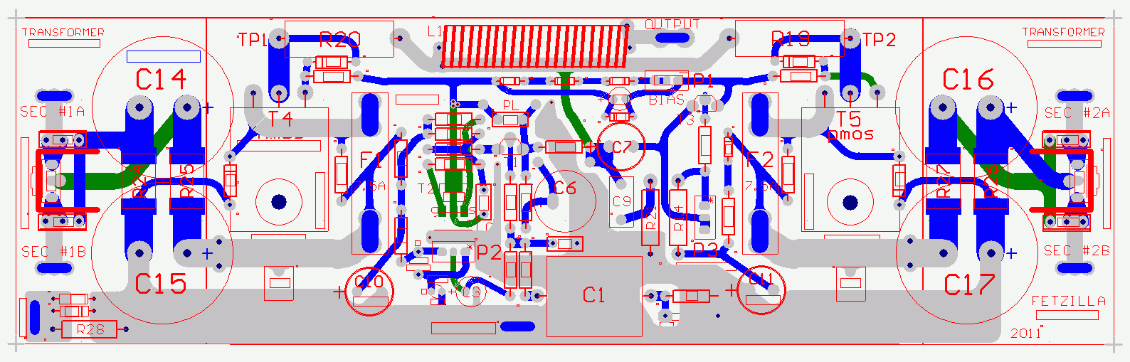

JFET input, MOSFET VAS, LATERAL output = Perfect!!
typical British style without Cdom (Self) Miller comp across VAS.
Note, in addition to the input filters and the isolating resistance on the output there are 4 other compensation schemes to make this amp amp work. Crimson and Sugden do similar.
Kean,
in the next version the R10 changed to a variable resistor and was "tuned" to best shape of squarewave. JLH claimed this gave best sound.
I do wish he had wired RV4 correctly, but a pnp for Q8 would sort it without having to change the PCB.

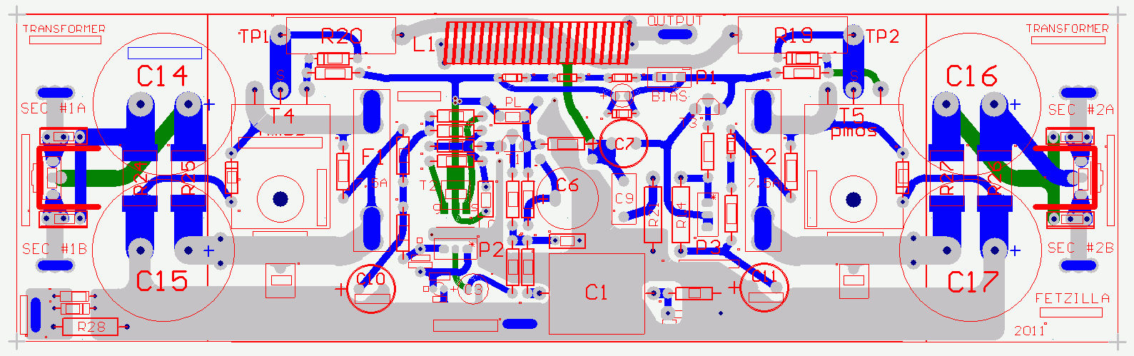

Pcb amended with output inductor now onboard.....
Dimensions are 230mm x 69mm.
Hugh

Ah, KT, that's an artefact of gif conversion from the original protel .pcb format. Nothing more.....
