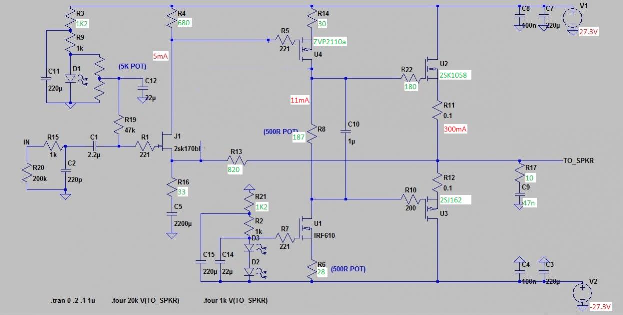

I have 22ohm + 1000UF rail filters on my PCB. I did not redraw Greg's schematics, I just use M$Paint to change some values.
BTW, I am not using any compensating capacitors (C6 & C13) and the amp seems to be stable.
I found that Farnell stocks ZVP2110A (TO92 version) & I will order that to try out. I am running 20mA thru the VAS and the IRP9610 is only luke warm.

The one to get is the zvp2110g, not the a version, as it has a higher power rating. The only problem is that it is a surface mount device which makes mounting a tad more difficult.
If you want to use a to92 device the zvp3310a sounds very good and is cheap from digikey, though the 2110a will probably be even better given its higher transconductance.
With any to92 device you will need to drop the current to 5-10ma, which still seems perfectly adequate.
Do you agree that the 9610 sounds better and better with higher and higher vas currents?
Look forward to your listening impressions with a zetex vas device, whichever one you decide to use.

Hi Greg,
I received my ZVP2110a today. I chose this one because Farnell got it & free local shipping. I installed it & the first impression was good. The treble sounds livier and the good bass & sweet vocal signature are still there. It is a bit late so I only listen in low volume. I have not done any stability tests.
Cheers, Stanley
Great to hear Stan. This is very good news. Many thanks for pursuing this design and raising your soldering iron. How are you feeling about the sound compared to any other amplifiers you have heard?
11mA in the vas is probably a bit much for the zvp. I would drop it to under 8 as your dissipation is quite high for such a small device. Believe it or not, 8mA is plenty enough for the lateral fets and will still drive a near perfect 20khz square wave.
I am especially glad that my listening impressions are being supported by yours given that I have built, fiddled and tweaked with over 10 versions of this circuit, and often was relying on my memory rather than direct a/b tests.
A few hours of run in should improve things further for you.
I would definitely check stability at a range of power levels and loads as the zvp makes quite the oscillator - far less gate/source capacitance and therefore less inherent miller effect. You may need a larger gate stopper and/or a miller cap.
I think now that you are using a sub 1W device in the VAS you might find additional improvement by using a higher q device in the CCS too. One option is a simple BJT ccs using dual BC550 transistors as I have previously posted. It should work very well. Better yet is a simple depletion mode MOSFET ccs.
Well done and keep up the good work!

Hi Greg,
I listened to the Fetzilla (ZVP2110a+IRF610CCS) for a couple of nights.
My Goldmund Mimesis 3 clone (JFET+BJT+Lateral FET) has got silkier treble. OTOH the Fetzilla has fuller bass.
The NS LMe49830 with two pairs lateral FET & higher front end power supply is more detailed but it sounds sterile and dull.
I also had a couple of Blameless amp but they sound boring.
The Fetzilla sounds musical & engaging; it sounds a bit aggressive at high volume. Overall I found that this amp touches all the bases & has the potential for further development. Please note that I only used the passive components that I found in my parts bin & I did not use any exotic parts.
I did two small changes - I bypassed the 0.2R source resistor (I only installed one on the N-FET). I changed the C1 from a 10uF MKT film cap to a 1uF MKP film cap (EPCOS|B32654A6105J|CAPACITOR, 1UF, 630V | element14 Australia) & hopefully it will improve the treble.
I think that the LED+IRF610 is a good stable CCS and I reckoned this will help to stabilize the amp. I had experience with the Goldmund & that amp was under-compensated. I stabilized that amp by changing to transistors with bigger input capacitance on the CCS for the VAS.
BTW, I am running 11mA thru the ZVP2110a and that is not even warm.
I may increase the supply voltage as I am running a higher gain (25x) on mine & in the mean time I just listen & compare with my other amps.
Cheers, Stanley

high gain and low rail voltage makes me wonder if the "aggressive" is simply clipping the output?....The Fetzilla sounds musical & engaging; it sounds a bit aggressive at high volume.............
..............I may increase the supply voltage as I am running a higher gain (25x) on mine
Hi Andrew,
I guessed that was the cause. I got a 40V PSU but I have to order some suitable capacitors to replace those on the Fetzilla board. I will listen for a while before doing this change. The reason that I used a higher gain because it is hard to do A/B comparison when the other amp has got higher gain.
Cheers, Stanley
wow - my gain is set to 11 ( where clipping becomes impossible with a 2V digital i/p ) and I half the signal before it reaches the amp and I still have to substantially reduce the volume with nearly all media.
