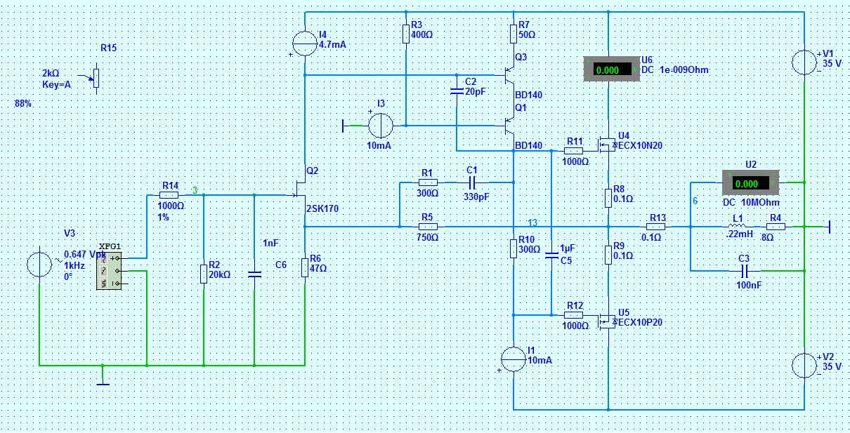

Mike, 200R of degeneration seems a lot. If the VAS runs at 11mA, then re is 26/11 = 2.3R. In my experience, ten times this resistance, near on 22R, is sufficient to swamp the non-linearities of this intrinsic emitter resistance, and further degeneration creates too much current variation in the first stage, detracting from its linearity due to Vbe/Vgs changes on the input device
Thanks for your feed back Hugh - As someone who never had an electronics lesson in his life I am aware that there are gaps in my knowledge so I have to confess I have no idea where your 26/11 calculation comes from. If 11 = mA what is the 26 ?
I wish I could build this thing now but until my things arrive form USA this is not possible so I am playing with this only in spice . . . but the extra degeneration in spice appears to bring only advantages - I will examin i/p stage current variation with different VAS degeneration for now and make & listen to this later.
However I think I can squeeze a jfet current source in there with only 50 ohms VAS degeneration 🙂

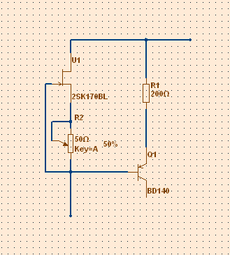

Mike.. have been looking at the JLH-amplifier and to me it looks like his DC-offset solution lies in the bottom.. you propose a current-source in top..any particular reason for that..??
In his diagram the solution is built into the CCS connected from the pos rail to the i/p device emitter.
In our ( reverse polarity ) design here, in it's current form the i/p stage does not have a connection from source to the the neg rail ( which I think is a very neat ) so as a starting point I just applied the principal that he uses which is that you add a similar device to the i/p device in a position where in tends to cancel the i/p device DC drift with temp.
How well it works in real life remains to be seen but I think it will be better that nothing ( and at the time swordfishy seemed to be looking for a bit more gain which this mod also provides )
mike
Mike,
The intrinsic emitter resistance of a bipolar device is 26/Ic, where Ic is the collector current in mA.
The 26 comes from the solid state physics formula behind this phenomenon and incorporates the Boltzman constant.
This implies that as the collector current increases, the Zout of a bipolar emitter drops assymptotically - a hyperbolic relationship which clearly is not linear.
Since the emitter degeneration resistor is in series with this intrinsic value, then it makes sense to 'linearise' the combination by swamping it with emitter degeneration.

This measure lineup suggested may help a lot with DC offset on a DC linked version
Not quite what I meant, mikelm.
See diagram below.
Where a JFET is used as a varible current source.
This replaces your potentiometer.
And this tweak does not help with DC-offset.
But it is a tweak for lowering the load of the input JFET and lower THD.
JFET will see a current source instead of a resistor, trimpot.
In fact this tweak may, for you, make DC-offset drift worse.
Better stick to your potentiometer and leave this tweak
to those that not use DC linked version.
Regards 🙂

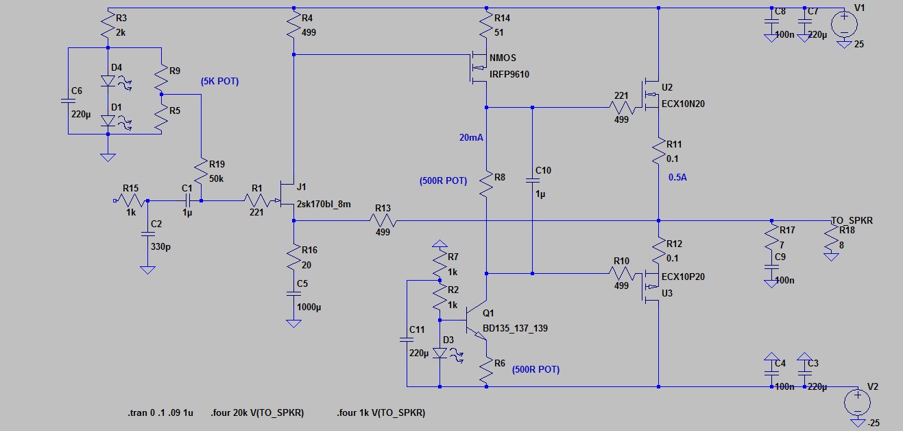

Ah, then I think you may like this variation
@ 10V in 8ohm this essentially has no distortion
and it seems stable into tricky loads also
enjoy 🙂
p.s. I did not put variable resistor in CCS on purpose. I have strong views about resistors - I think most of them sound horrible and variable ones sound even worse so I prefer to have dominant current via a fixed resistor 🙂

. . . but I did notice that my spice square wave ringing & swordfishy's real world square wave ringing with varying capacitive loads were very similar which is quite encouraging.
Meanwhile, Swordfishy appears to have gone to sleep and left us all hanging here to see his final circuits . . . 😉
That's what I did and with a 1k ohm & 1nF i/p filter this high OLG version works just fine
Using cascoded BJT's gives about 25db less OLG at 4meghz than using a mosfet VAS so in comparison stabilisation is fairly easy.

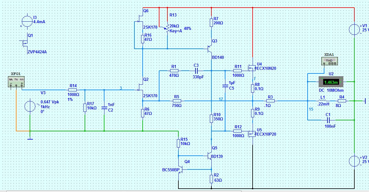

This is it!
All,
I present to to you, the ultimate, the best, the penultimate. It does not get any better. Take every good comment I have made about sound, add them together and you get this.
Not what you expected me to post huh? Thanks to lineup for coming up with almost the exact circuit without even lifting a soldering iron. And to Hugh for the CCS and DC offset tweak. This is it.
I move on to PCBs now. I see no need to experiment further, except maybe to find a better FET for the VAS.

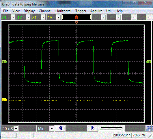

Stable? Check out the 20kHz square wave....the best yet.
I will post the long story about how I got here tomorrow. It is all about OLG. The JFET does not have enough so we needed more from the VAS. Mikelm, I bet you're rolling your eyes now aren't you 🙂
Edit: oops, please ignore the "NMOS" text...it is of course a P channel device.

SWF,
Congratulations - this looks damn good. Excellent 20KHz square wave too....
Do you know loop gain? With low gm 1st stage, and high gain VAS, I'd think around 60dB? Nice CLG, too, no less than 26, very nice, around 28.3dB.
So I'd estimate about 6mA in the input stage? That's 150mW dissipation in the jfet, within ratings. Should be reliable.
That's a very big VAS current, particularly for laterals, and a mosfet with 51R of degeneration, no miller cap! WOW!! What is the voltage across R8, Greg?
And only half an amp of quiescent - that's 25W of heat, manageable, only 12.5W per device, that's about 4W in Class A, AB from then on. Where does it clip? Symmetrical?
Finally, a good 2V or more across C1. Input of C1 should have a ground ref resistor, I'd say around 220k.
Brilliant, Greg, would you like my input with the pcb?
