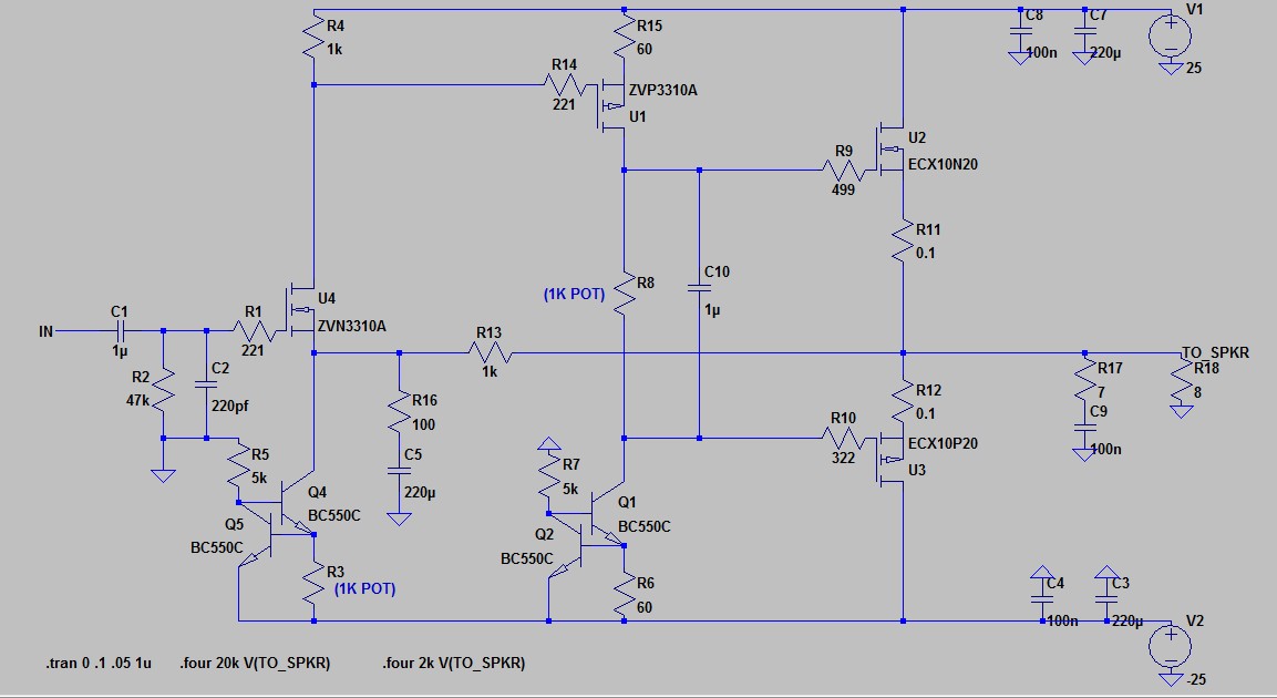

Here are the figures. It would seem that the sucker cap helps at 2kHz and is detrimental at 20kHz. Note these figures are at about 22v p-p output. Seems it would be worth using one in that case as I can't even hear 20kHz. Maybe there's a measurable reason for why l prefer the sound with it in after all.

Dear swordfishy,
could I possibly suggest You look at the gain structure through Your circuit?
That should potentially give a good indication of why You seem to have 3rd harmonic as dominant at 20kHz? I know it's out of most of Our hearing ranges, but it does affect the perceived transient performance in the upper registers...
Your chosen classic (American?) VAS resistor loading, might not be particularly good, with a very highly impedant and voltage controlled Vert. MosFet?
It is normally used in current controlled BiPolar designs, to my humble knowledge.
The resistors will load the VAS very hard and this could result in increased distortion especially at higher frequency's, where the capacitances of the Output MosFet's, is also coming in to play, with their loading.
Otherwise the remedy could be more current and therefore a higher power VAS Fet...
I would though personally recommend to shy away from IR's and the small TO-220 Hitachi's for this purpose - I tried them for this application and did not like the produced sound much...
To 'Screechy' comes to my admittedly (lycky in this case) fading mind...
I think there to be something in odd packages though - TO-92L, TO-251, SMD and what have U - Toshiba has one in TO-220F that might work, but I have not tried it and am therefore not able to comment on suitability? Seen them available on eBay though. They should have a reasonable low threshold Vgs Voltage as well?
Be aware of not to high input capacitance though - that will adversely load Your 1st stage at high frequency's as well, so You potentially forward the problem here...
Other remedy could be to re-invoke a current generator here, instead of the resistor network?
Could of course change VAS for BiPolar, but that would somehow defy the object of an all Fet amp signal path somewhat - oder?
Hope this is of the intended good help intended with best regards

Hi mike and swordfishy as well,
have You guy's tried capping the 1st stage source resistor and/or the VAS degenerating one, for HF compensation and stability?
Much better there, if You can make it stable, than a large 'miller cap' on the VAS or directly in the FB - those will severely limit the OLBW and thereby the available FB gain for HF distortion reduction, to my knowledge and loads of test's...
I'm also 'seconding' Miib's point re. lateral source resistors, by the by - could be maybe just 'a Danish thing' though?
Best
DocO
DocO,
Thanks for your input, it's most appreciated and you have raised some valid points.
You are probably right about the VAS. It may indeed be worth going back to a CCS for this stage. In fact, that was the original plan but we dropped it for the extra simplicity of the bootstrap VAS. I will try to solder up a revised board with a CCS VAS over the coming week, though I am rapidly running out of parts and my perf board looks like a jungle.
As for the degen bypassing....good idea, will try it.
I decided last night that I wanted enough gain to make the amp clip with the input from an ipod (not that I would ever use one as my primary listening source). So I upped the feedback resistor to 1k again....oscillations were back. Tried bypassing the feedback resistor with up to 330pf of capacitance. No good. This thing just loves to oscillate. Anyway, what I am trying to say is that any suggestions you have for improving stability are most appreciated and I will try them all.
Source resistors will come out once the final design is settled on. In the meantime they are a convenient way of measuring Iq.
Thanks again,
Greg.

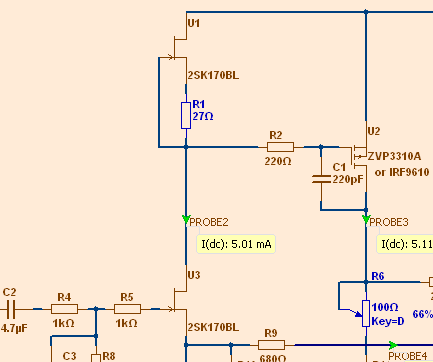

Here is another improvement.
Replace the drain resistor of the 2SK170
with one current source CCS in form of one JFET.
Gives lower distortion.
Note also the increased value of compensation cap: 220pF
It looks as it at least should be 100pF, like danspy uses.

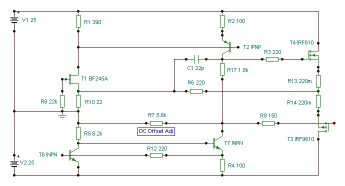

Hi All,
As was suggested earlier, I have gone back to the CCS VAS. Lineup will be laughing to himself as we are now back where we started the thread! Guess you can't improve on a good design. Anyway it is a worthwhile improvement, amazing actually. Here is why.
1) As docO predicted, the amp is more stable. I was not expecting this as I have had issues with oscillating CCSs before. I was able to increase the gain to something more useful with no oscillation problems. Still with no compensation of any kind.
2) The performance. Square wave performance is improved....though it was pretty amazing to begin with. This amp eats a 20kHz square wave for breakfast.
3) The sound. This amp has gone from sounding great to absolutely phenomenal. Some of the warmth is gone, but the detail and clarity has improved substantially. This amp has the potential to ruin me as an audiophile. Can it really get any better than this? It sounds absolutely amazing. Some of the warmth is still there (just a bit), but the separation and transparency is vastly improved. I can now see that the bootstrap was adding quite a bit of coloration.
I prefer the amp this way, but some of you tubeophiles might like it more with the bootstrap VAS.
Have no fear, even with the ccs VAS I guarantee you will be tapping your feet!
That said, the extra stability and extra gain it allows is a big plus!
Anyway, here is the current schematic:

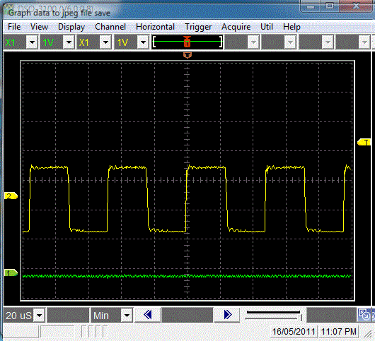

Square wave
All,
Here is the 20kHz square wave at 20v P-P, with 500R gate stoppers on both output fets. Could be even better with smaller gate stoppers I guess, but this is plenty fast, and nice and stable too!
Wuyit, I will be replacing the input fet with a 2SK170 as soon as they arrive. I ordered them a week or two back.

Ok well it seems that 500R gate stoppers are the best compromise between ringing and rise/fall times. The rise and fall time of the old bootstrap ccs was better, but the corners were a lot more rounded. I think given the simulated 10 fold improvement in distortion of the bjt ccs vas it is worth sticking with it, despite the slightly slower performance.
