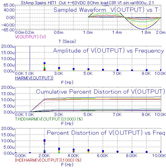

been a while since I last participated in this debate. Thought I would upload a little simul from the status of me own little 'chestnut baby'... It's playing and in the words of others: 'Very, very cleanly'...

10 micro percent THD at 60V peak, wow!😱
are you sure this is not the input signal's THD that you are seeing..
Is it 0.00001% (or 0.001%) at 60Vout? Yeah, for this fet topology its too good to be true. But you can still have smaller number if the amp doesn't operate well, e.g. insufficient drive.
Sometimes I think why we should display the chart at all as it is not sufficient to describe the performance of an amp (it is useful for the designer because he know it in conjunction with other numbers). But everyone do it so I do it also 😀
Surprised to see you following the crowd, Jay?
Hugh
Hehe I've simmed and built many circuits (and its derivatives) from this thread. I have been thinking that 3-stage amp is perfect. And I think 0.0001% is the standard of good achievement here. Without the "%", 0.0001% is equal to 0.000001, is equal to 1u THD.
Previous chart shows 10u THD. If that means 0.001% I think it's normal and acceptable. But if that means 0.00001%, it is way too good. Possible, but I don't think it is good sounding.
Yes, I know, we are all seduced by low THD. It is universal, difficult to argue against. But I prefer to examine the harmonic structure, not worrying too much about THD. Perhaps a better measure would be THD for H5 and beyond. That's where I like to see less than 0.001%.

10ppm 2nd harmonic THD @ 80Volts pk
Hi Nico,
it's actually at 80Volts peak.
Don't forget that this is just a microsim, as You so self indicate, but as You also say - microsim is actually amazingly accurate.
I have measured a previous version on an HP35665A DSA (Dynamic Signal Analyzer) I use to own and the real 2nd harmonic for that version was below -80dBs... 3rd just visible above the more than -90dB down instrument noise, with the rest of the 'products' well berried there.
These Sim results are for the improved more stable version and it is playing in real life. There ain't much 'amp-sound' left here, but it has not gone sterile either - just 'Natural Power Fidelity' really...

10 micro percent THD (that is -140 dB) at 60V peak output, besides that it is 2nd order dominant WOW!😱 are you sure this is not the input signal's THD that you are seeing. Mind you I trust MicroCap also.

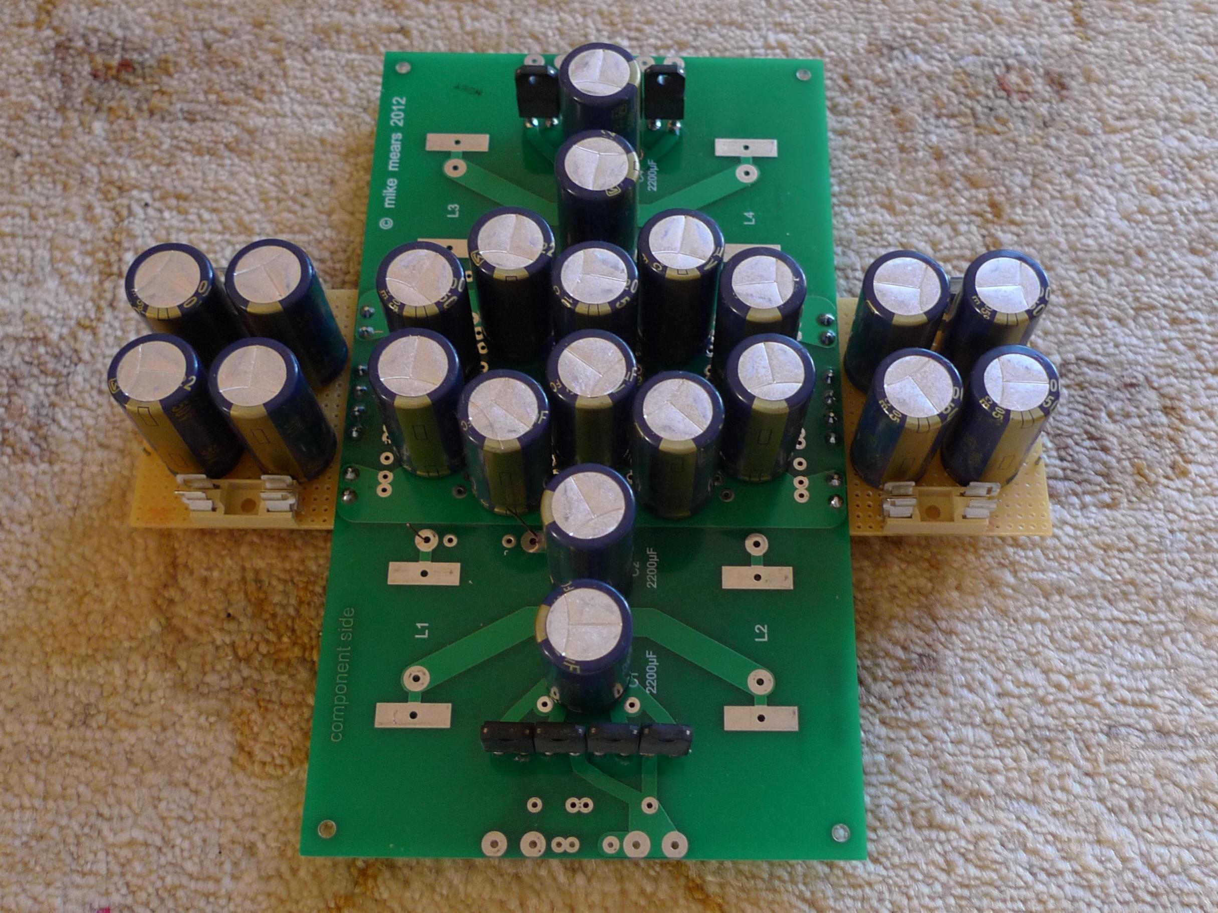

Hugh,
Great to have you back posting on the forums. I knew that post of Mike's would spark your interest! I also agree with the low OLG approach for most types of music and the notion that the basic three stage fetzilla style topology is ideal. In fact, as you know it nearly destroyed my interest in DIY amplifiers because no subsequent topology I have attempted has been as versatile.
One place I think it falls down is in complex music with massive punchy transients. When I can have punchy, competent, liquid, detailed and smooth all in one I will be content. Haha, not likely huh?
Will send you an email soon, good to have you back!
I'm hoping that a low impedance supply will help with this. Right now I'm working on passive supplies but active supplies are designed & waiting to be built.
Here's my latest effort on the passive front:
- JFET input, MOSFET VAS, LATERAL output = Perfect!!
