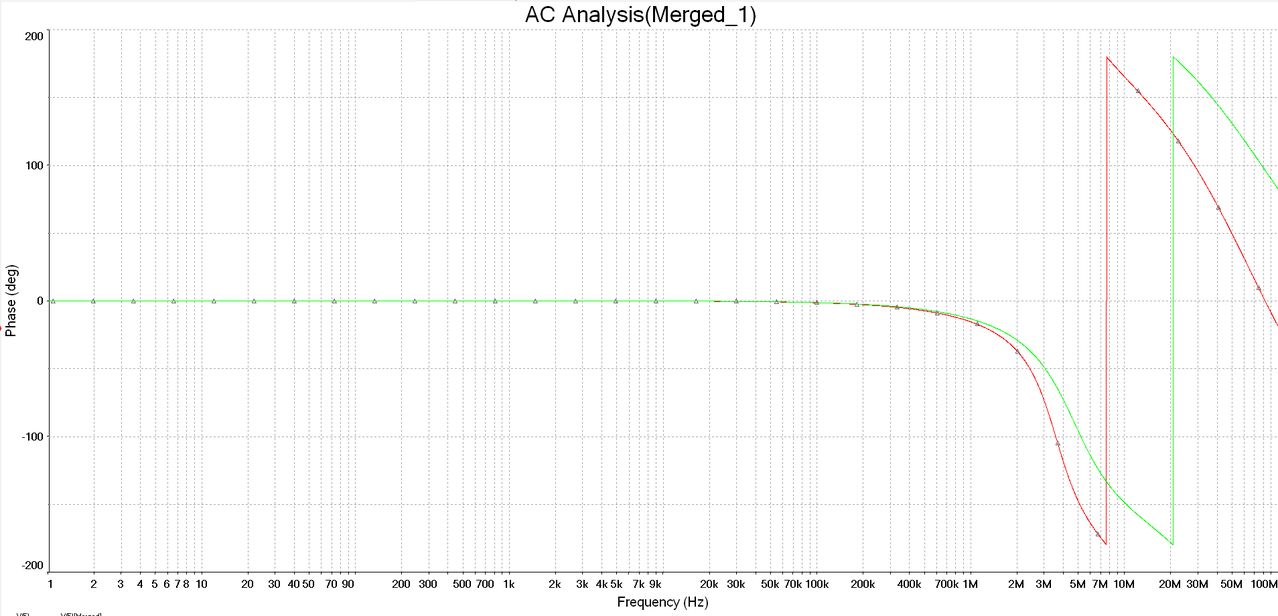

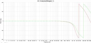

Hugh,
I just rechecked in spice the mods I recommended but this time using 47R degen value.
Without the 500R in series with the miller cap and with 47R degen spice showed the 180 degree frequency at around 7.8 meg hz
With the 500R and with no degeneration the 180 degree frequency increased to 21 meg hz
Now, we know that these figures are not realistic because spice is way too optimistic in this regard but never-the-less I think the relative difference is significant even if the absolute values are not

Mike, how's it look with with 50r of degeneration and no compensation whatsoever (my setup).
