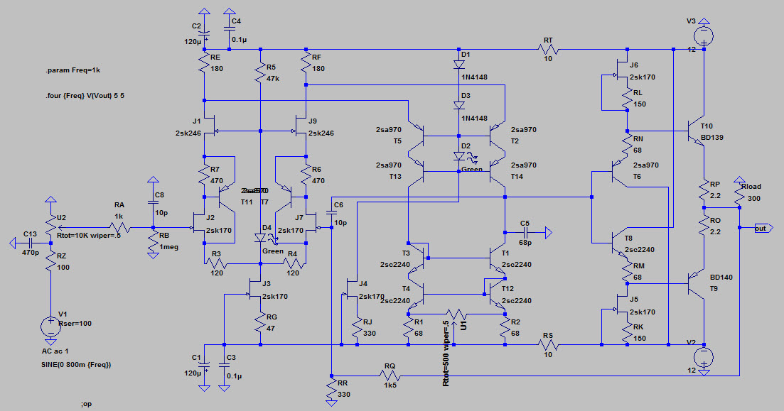

Jfet folded cascode with diamond buffer opamp

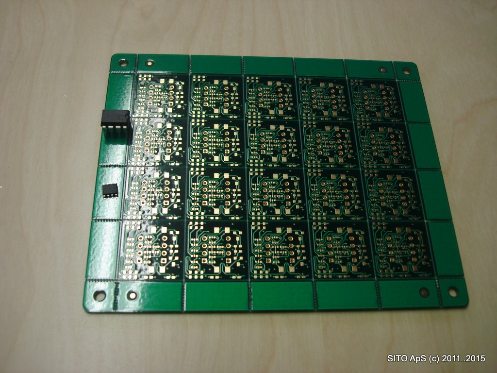

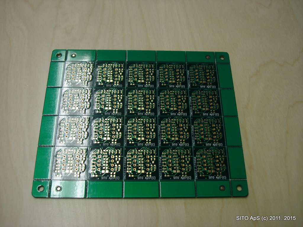

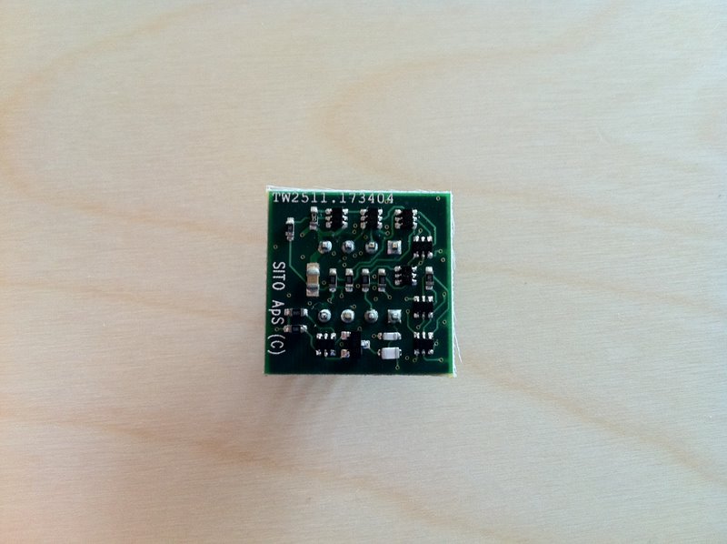

Here are the boards. I dont think i will be able to assemble them before next week :/
You can see an DIP8 and a SO-8 on one of the pictures for comparison.
Okay, the problem with the offset is due to a poor vgs matching in the PMBFJ620 . At id=~3mA the is a difference in the package of 430mV..
Sadly enough there is no matching jfet with the same layout... Also no dual npn bjt with the same layout.
So they are for scrap... They work, but the have the hugh DC offset...
The fix for this module is a trimmer between the rails with a series resistor to either in- or in+.
Or add an external servo...

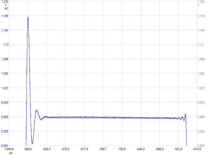

After a long period have had sparetime to test the modules.
The attached measurement show a well behaved THD.
No load, the 2. harmonic is the only present distortion. 0.003% or as low as my equipment goes.
into 220R load 3. is present at 1KHz and 3. and 4. harmonic is present at 10KHz.
The same circuit will be no different with an bipolar input (SSM2212 from analog devices).
More to follow.

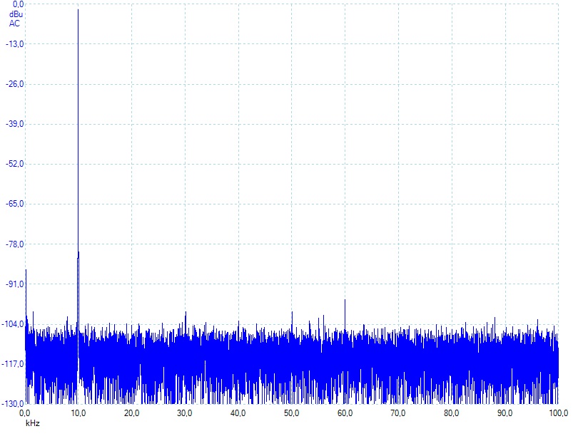

I have tested the JFET opamp with NPN pair instead of jfet's.
Some of the data is:
  • Less than 2mV input offset
  • less than 4uA input offset current
  • Distortion 10 times lower at 10KHz into 220R load
The picture below is as with all the other measurement
  • 47pF compensation
  • 680mVrms out
  • 10KHz Sine
  • 0dB gain
Distortion is 0.0018% - Generator is: 0.0013%
still the post1 schematic?
No, it is changed a bit.
See attachment.

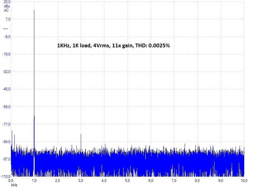

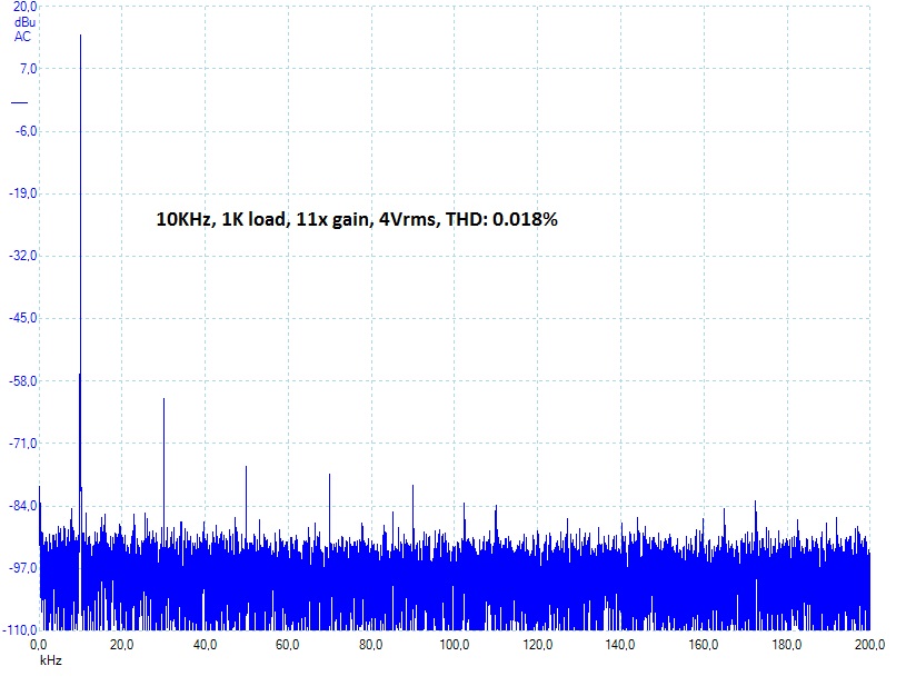

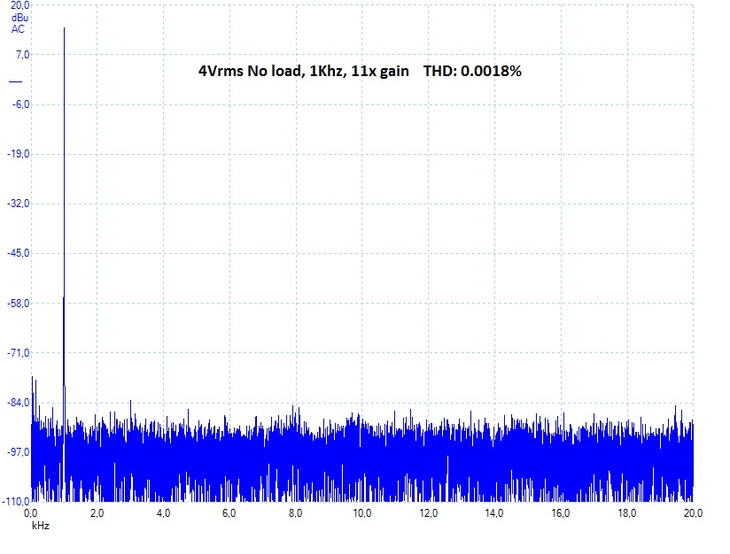

instead of folded cascode, i use current mirrors now. But performance is exactly the same.
