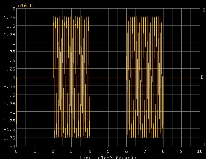

It is a trade off: the transition can be made arbitrarily fast, but then it won't be clickless anymore.however I fear that the switching time will be a bit high (~1 s for full mute). During on-to-off or off-to-on transition the signal might be seriously distorted, which becomes audible at such long transition times. Can R5 be reduced to something like 100k without compromising on-performance?
With the original values, the total switching time was 200ms, with the transition lasting ~80ms.
Here is an example where the delay is shortened to 1.5ms, and the transition time to several µs.
This will cause an audible click, particularly if the audio signal has a high bass contents.
I presume a meaningful transition time would be around 20 ms. What's 10 Hz distortion (on-state) under these conditions?

The following version switches in ~20ms. The distortion at 10Hz is unchanged.
You can play with the capacitor values to obtain the optimum trade off between speed of action and audibility.
