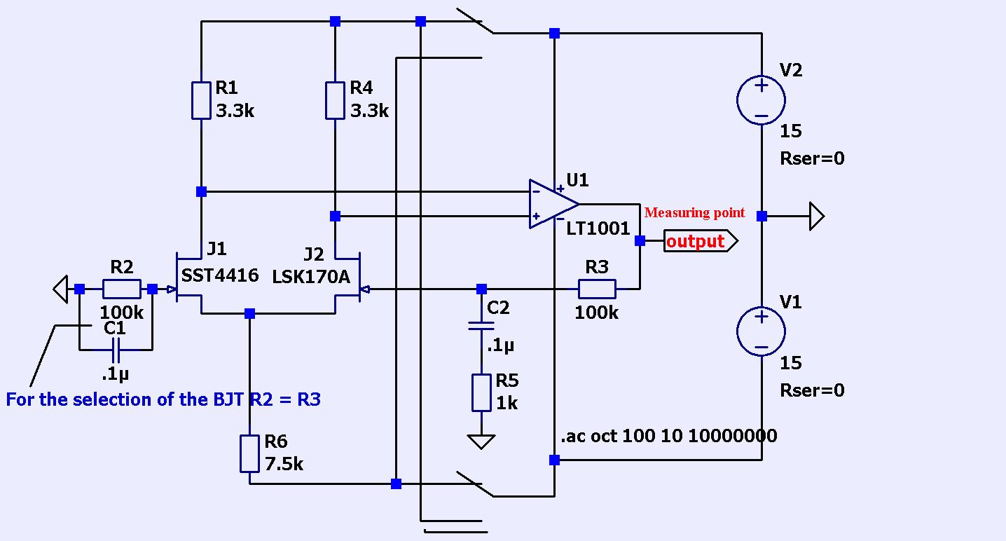

Replacing the BJT to JFET can improve dealing with the Input Bias Current, but degrade the Input Offset Voltage due to variation of the JFET Ugs, and generally worsen the situation. In addition, it may decrease the gain input stage for voltage and depth of feedback that will increase the distortion of the entire amplifier. You've got to be careful and know what you're doing.
For semi-automatic selection of matched pairs of JFET and BJT.
The idea is that the OpAmp drove the J2 and balanced currents J1 and J2. In place of the J1 and J2 through connector placed a pair of JFET or BJT, and the output OpAmp to measure the voltage of the error and pick up a pair of JFET or BJT at the lower value.
For the selection of the BJT R2 = R3.
You can choose OpAmp any cheap device.
