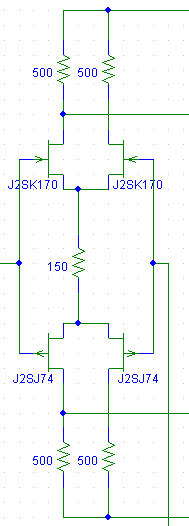

If you're going to use a fully symetrical jfet input, you might consider the attached configuration. This showed excellent constant current in real world and reduces part count heavily.
Don't forget to cascode them, the sj74 has max vds of 25v.
Mike
