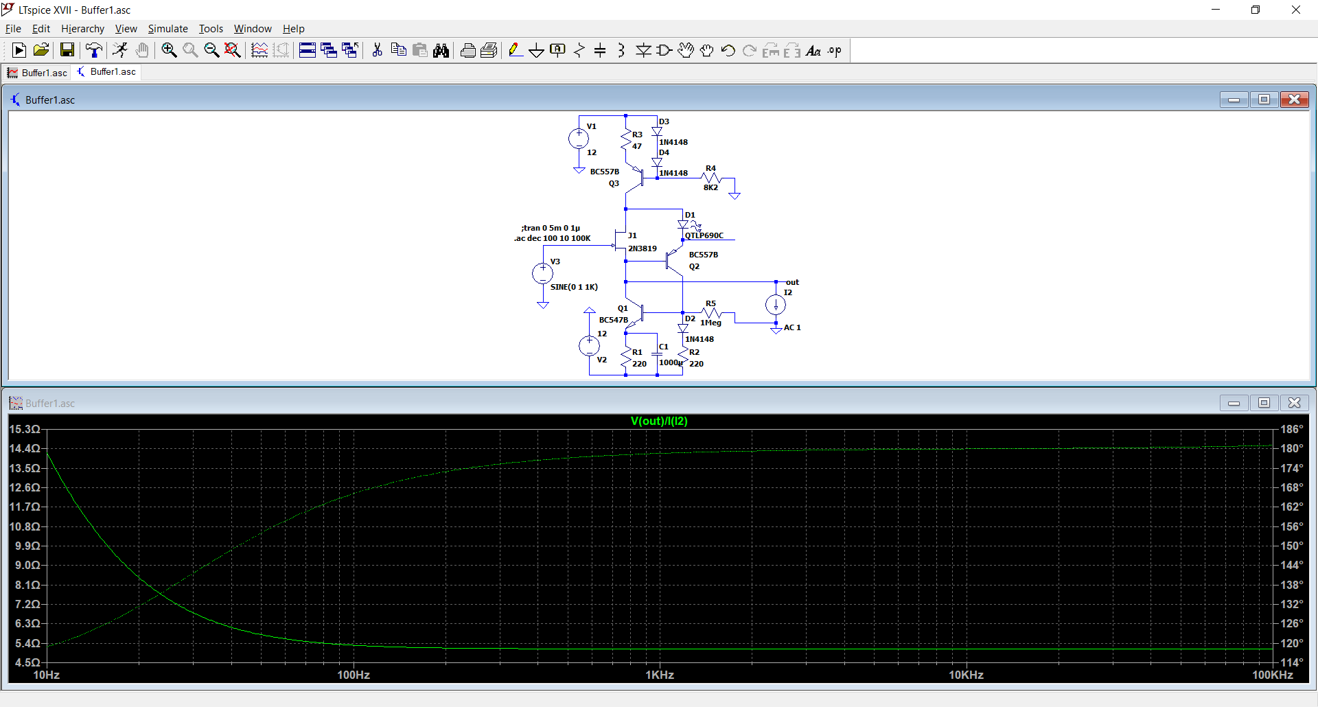

It is probably possible to simplify and improve it at the same time by including it in a Taylor/White style scheme.
It would spare one or two FETs whilst improving the stasis-derived performance
Here is what I mean: it is just an inelegant and clumsy attempt only meant as an example, and to make it work (sort of), it includes a cheat: capacitor C1.
attachment.php
It could be refined, redesigned to achieve better performances without capacitors, but in its rudimentary form, it already reaches an output impedance of 5.4ohm, one order of magnitude or two better than a plain-vanilla source follower (it would be 1/Gm).
The linearity performance should be improved in the same proportion.
Since the bootstrapping transistor Q2 doubles as a Taylor engine, the transistor count is 4, of which only one is a FET

Elvee,
Now I see what you mean with Taylor/White scheme. Thank you for taking the time to draw the schematic and run the sim. One reason that got me interested in the Tek buffer is PSRR (and no P channels, otherwise the Pioneer is just fine). One application I have in mind is as input buffer for an ICEpower class D amplifier where the supply rails are taken from the switching circuit. The White follower is probably not the best performer in this department but your circuit seems to be better.
