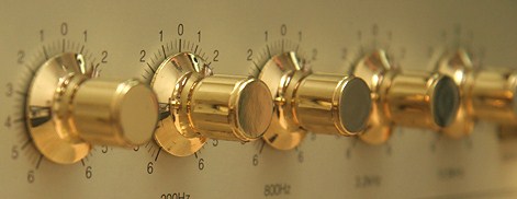

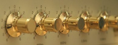

Look Ma, real Gold.
Only 50 Thou Dollah in Japan and believe you me, no opamps inside.
Cello's is the first and only EQ I think of whenever someone brings up tone controls in high end. Never heard it myself, but it received a great review.
It got some remarkable reviews in German audio mags, too. At first the reviewers were quite prejudiced and suspicious about the tone controls, but quickly got excited about the preamp qualities of that device. Nevertheless they also played with the controls. Just in "homeopathic doses" of course.
I heard that device later on Berlin Funkausstellung. It was part of the Guiness World Record "Most expensive HiFi system" (including Wilson X1 Grand Slamm (first version), Mark Levinson amps, Transrotor Quintessence and so on). German Hifi journalists Joachim Pfeiffer and Marius Dittert made a wonderful job there. It was a great pleasure to talk to them. But that was nothing compared to the system's performance. It was just outstanding!

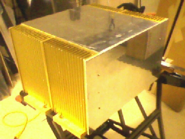

Those heat sinks look familiar--Apex Jr. ?

It's an equalizer by FM acoustics in Zürich.

Apex Jr. ?
Oh yeah! Best deal in town, if you have time to remove the board that comes with it and the 1000 little screws that hold it together!
No kidding!! I find the screws useful in other projects, though. I bought 12 of the little critters. Best deal in town until Steve ran out...

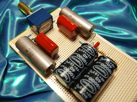

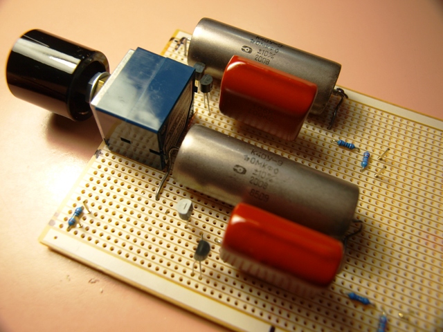

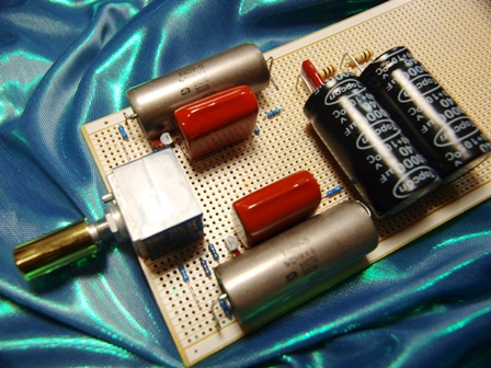

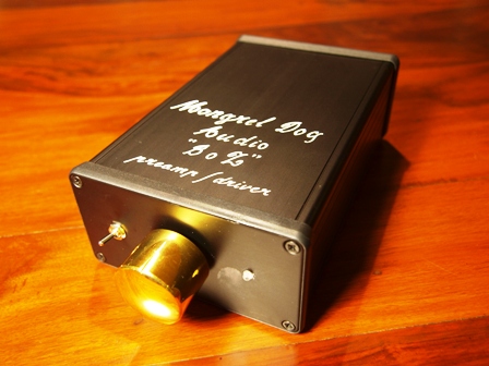

My attempt at the simpler BoZ
BoZ cct. brd.completed.
See imges below. Once again I used the Russian 0.1uf PIO, and 10uf poly (input cap and output cap respectively) (snubbed with 0.1uf ploy). All on vero-brd. spare central tracks shorted to ground to act as a gatherer. Alps blue velvet 25k pot and slim solid brass knob.
PS: 1R0 to 10,000uf cap, 10R0 to second 10,000uf cap. 5% WBT silver solder used. This will go into a Hammond anodised Al case.
OK it's off thread but strangely related. See my B1 image (last image, now finished and very enjoyable). See B1 thread for more info.

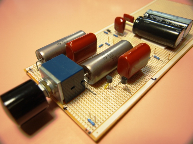

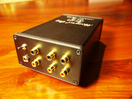

Once more the Hammond anodised Al cases. This one shorter than the B1. I upgraded the knob to a 4oz solid brass job. BUT down graded the rear RCAs. Still gold plated but no need to insulate from the case. Switch at the front is a mini on/off, switch on the rear selects between the two sets of inputs. Volts feed is meant to be 35V. Currently I'm running it on 34V of lithium batteries until I can get the hum out of one DC supply.
On an early listen bass may be weightier and just as extended as the B1.
I'm yet to get a decent listen but the day is comming.
