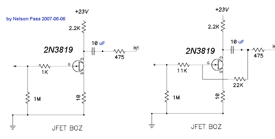

This morning before going to the office.. I switched the 2Sk170 for 2N3819s ..and measured the THD adn Voptimum.. I tried a few.. .. I did make a small change to the circuit so were njot able to make full comparisons..

Results for 4 samples of 2N3819 1 Vrms out at 1KHz:
sample 1]
0.18% THD, pure H3, Vopt = 21 Volt, gain=18dB
sample 2]
0.15% THD, pure H3, Vopt = 23.3Volt, gain = 18dB
at 300mVrms THD was 0.02%
sample 3]
0.127% THD, pure H3, Vopt = 26.6Volt, gain 18dB
at 300mVrms THD was 0.015%
sample 4]
0.120% THD , Vopt = 24.5Volt, gain was 19dB
Using sample 4 in the shunt feedback schematic I got these results:
gain = 3.1dB
Vopt = 24.1 Volt
THD at 1 Vrms out was 0.039%

I haven't done any listening tests.. but it seems that the 2N3819 follows the same square-root transductance law as the 2Sk170..
Besides that lower gain (18dB v. 26dB), you can expect more noise.. but nothing to worry about... I would say the 2N3819 (selected for Idss => 8mA) would make an excelent low-cost alternative.

Hi lohk,
No, i didn't select the 2N3819 jfets at all.
After the tests I measured the Idss of the last two JFET (sample 3] and 4]. The Idss of two fo them were:7.39mA and 8.53mA, optimum Voltage supply was about 25 and 27 Volts.
Yesterday I measured them again in the exact same circuits as I used for the 2SK170 (the original Nelson Pass JFET BOZ), so with two 2K2 resistors:
They had the same THD as the 2SK170 with Idss = 8mA, but need a higher voltage supply (22.3Volts for the 2N3819, 16.3Volts for the 2Sk170).
I don't understand why the 2N3819 isn't regarded as a fine alternative for the 2Sk170 in line applications.
Although internal resistance is a bit higher, transductance is a bit lower, noise is a bit higher... the 2N3819 works absolutely fine in this application.
