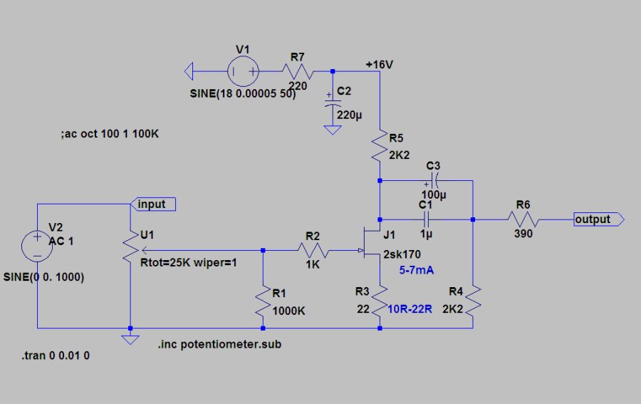

This week I had the pleasure of putting together this preamp. Fired it up today .😀
Been trying it on my wife's setup (no research in the living room....). Certainly did bring life to the sound.
The living room setup is JBL Sovereign speakers, a class a/b power amp(http://www.diyaudio.com/forums/showthread.php?s=&threadid=65286&highlight=) and a low/mid-end Sony cd-player. Other sources are a Pioneer tuner and the TV. Preamp is normally a Doxa 012(Norwegian).
This JBoz's impact on the setup is incredible.
Attached is the circuit with the built resistor/cap values.

yggdrasil : welcome to the JBOZ lovers club 😉
refering to your schematic, may I ask you with which value of Idss/Rs
you did get the sweet pot?
Manu
Manu

Manu said:refering to your schematic, may I ask you with which value of Idss/Rs
Well I haven't really done much measuring, nor have I done any hunting for the sweet spot.... Yet.
I got ~7V at the drain, and 100mV at the source of the jfet. Then it was time to start listening.
There was some variation between the channels, so I'll have to match some devices before next run.

100mV?
yggdrasil said:Yep: 0.1V
I see. You mention a range of resistance in R3; which did you end up using?
