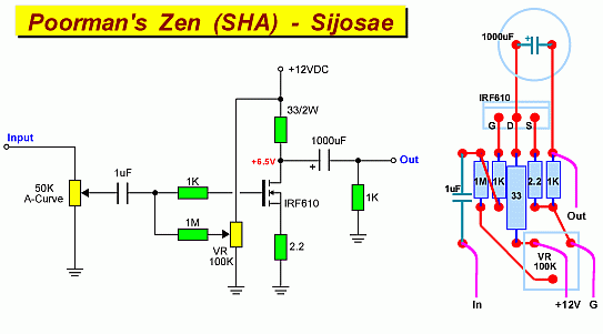

Reporting in:
I tried and tried, but I couldn't get satisfying sound out of this - I built 2 layouts and protoboarded it, but I think it needs to be adjusted for each specific setting according to the rest of the system.
I did find that the zhaolu 2.5 dac puts out a much larger output than my dvd player :xeye:
Testing:
Trace layer - there is a trace missing between PSU Cap + that was fixed:
Top layer:
CMOY killer version - next to some 2SK389V and 2SJ109BL:
I haven't given up yet though, just taking a break - I'm planning on building a version with cermets in place of some of the resistors so I can tweak on the fly :smash:

Back on topic :bawling:
Jfet BOZ deceived me! :bawling:
When I built it, I was testing it with amps that do have some voltage gain. With F2 lite, Jfet BOZ was working fine, very clean and musical as well.
What happened? I modified F2 into "Ota-one transistor amplifier". For those that didn't read that thread, that's simply a follower-no voltage gain. So I had to push Jfet Boz more...and then it distorted...:dead:
I cut one of 27 ohm source resistors. Became a bit cleaner, but not much...Ok, at low volumes it still sounds wonderful, one of the best combinations ever heard (jfet+ota). This made me want more...but Jboz distorts!
So it seems that it is not capable of swinging enough voltage, or maybe I need to experiment more with resistor values. Or, add two batteries more, and make it 36v supply...:scratch:
Vix
The circuit has a sweet spot, but outside of that, it won't work
as well. More supply voltage will increase the distortion.
You will need a more complex circuit, or one whose JFET better
fits the characteristic you want. Offhand, I don't have a
suggestion for that part.
Suffice it to say you will need a more complex circuit than that
to do the job.
