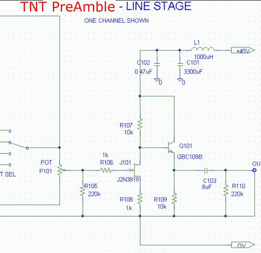

Shouldn't it be interesting to compare the JFET-BOZ with the TNT Preamble?
My understanding of FET stage gain calculation is poor, but could this circuit not changed for more gain? (The low impedance output follower seem also helpful to me).
