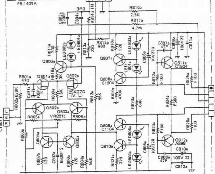

Luxman L410 schematic
Hi folks,
finally, I got the schematic from my friend and scanned the interesting part. It is the line stage, which works together in one part with the power output, so the biasing and the power transistors are missing.
BTW, the light emitting diodes are shown the wrong way round, the JFET is a N-JFET, and all transistors not marked differently are 2SC2320 or 2SA999. The minus voltage is top, the plus voltage bottom.

Sonny, I just checked the schematic. The input stage with JFET's seems very
100 ohms in drain resistors and 2 kohms at the sources???? OK you have a folded cascode but still?
In order to get low noise, shouldn't R1 and R2 be of a low value or just a wire?
Yes you are right. I will go for 100R - 200R myself.
I cant remember why it was set at 2K.. it must be an mistake. I do not have the board right here, but i do think i have set it for 200R => GPBW of ~8MHz.
