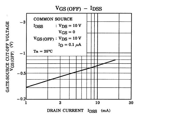

I am trying to build a spreadsheet to help me design the bias circuit on a simple jfet gain stage but I did not understand correctly how to read 2SK170 pdf.
Looking at the ID - VGS graph, for a jfet with Idss = 4.1mA I read Vp (VGS off) <> -0.33V
But looking at the VGS(off) - Idss graph, I figure for Idss = 4.1mA, VGS(off) would be <> -0.48V
I am quite confused now so any comment would be a great help.

The graph on the left is asymptotic to the axis and just not drawn well enough nor has the resolution to be accurate for finding Vp. The graph on the right picks an arbitrary current (.1uA) to call "0".
Take a real FET and record Id and Vgs over a reasonable range, you can then use the basic JFET equation to find the Idss and Vp that is a best fit. Even two points like 1mA and 5ma gives a surprising fit. You could try it with the left graph using Vgs = 0 Id = 4.1mA and Vgs = -.1V Id = 2mA and see what Vp best fits these two points.
EDIT - Just use eqation 7 in your reference. I get -.34V for Vp in that graph at 4.1mA Idss. If you plot the whole line with those values it will lie on top of the datasheet graph.
Indeed... Thank you for the tip scott
Or just measure Vgs with a >=1M0 resistor fitted to the Source.
Thank you Andrew.... so you mean maximize RS to get the lowest possible current and fake pinchoff.
