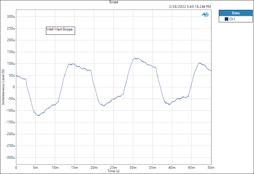

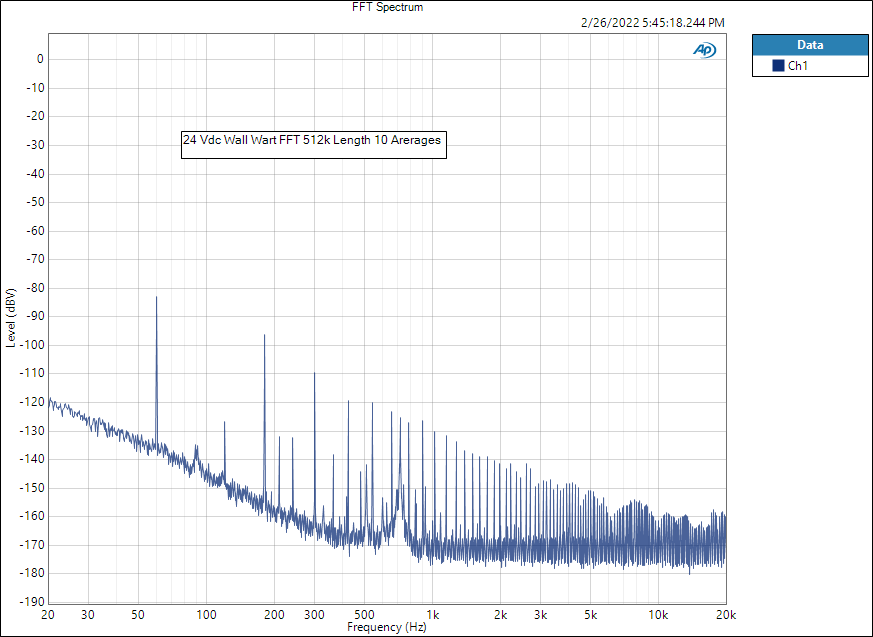

Hello,
While Waiting for some Vishay / Dale RN55 resistors to ship I fabricated the 6-24 Power Supply filter section and connected the recommended 24 Volt Wall Wart.
The wall wart and filter are much more noisy than I expected.
See the posted AP FFT and Scope plots.
Thanks DT
Thanks DT
When these are back in stock try it, you will be very pleased I suspect - https://diyaudiostore.com/collectio...s-dc-filter-p089zb-kit?variant=39297638465609
I do not know if you noticed, the plots above include the wall wart and the 6-24 PCB CRCRC filter.
It looks like there may need to be a regulator as well.

Hello All,
I looked at the TRI-AD wall wart plus filter again.
Typically when you speak of noise the reference is the random stuff that fades with averaging. Most of what we see in this plot is recurring switching spikes.
The dominant spike or peak is 60Hz.
The overall noise level between 20Hz and 22kHz is 74 or 75 uVrms, not too bad if it was random stuff.
For focusing on JFET and resistor Harmonic Distortion + noise makes me rethink using the wall wart.
I think that I will use a couple of 12V gel cells in series for the initial testing.
Thanks DT
