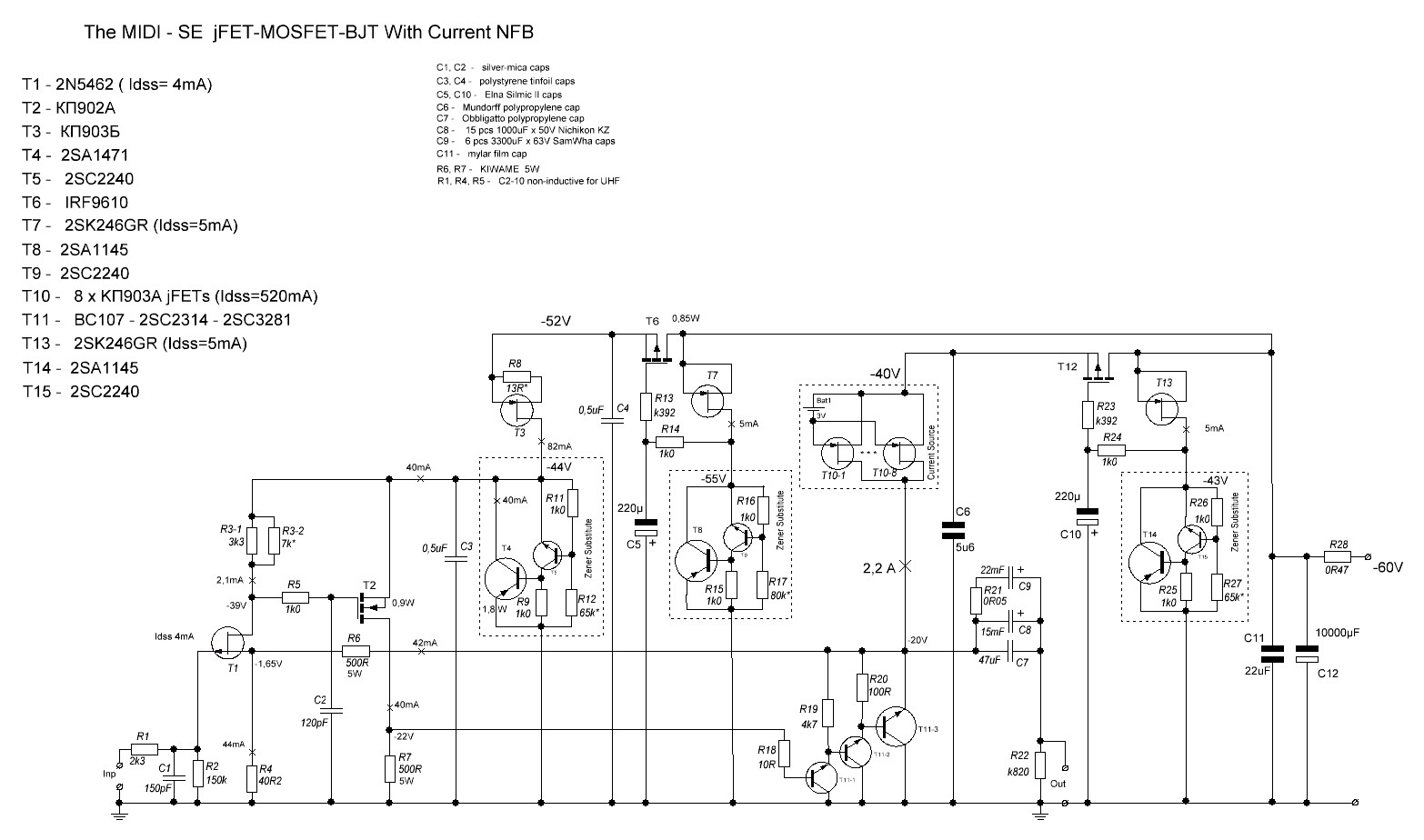

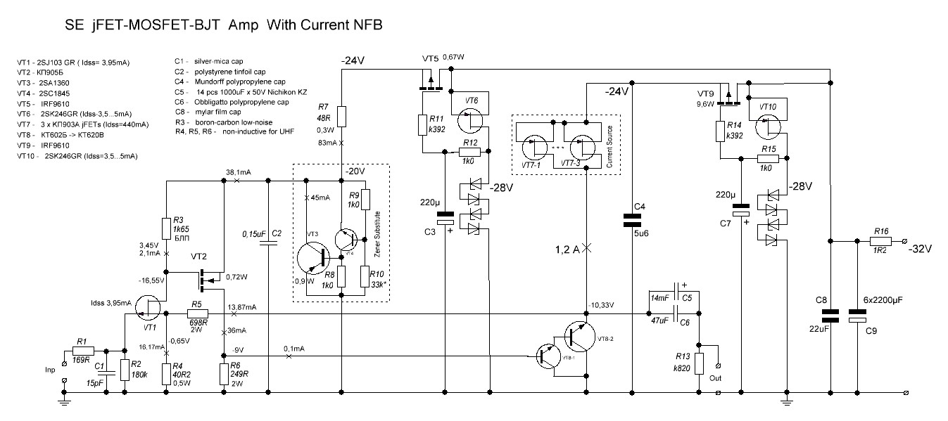

I have assembled and tested another version of the same topology, as presented in this thread. This new version is with BJT active device at the output stage, and the current source is made from three paralleled jFETs. Also, UHF MOSFET was used at the second stage, instead of K117 jFETs.
Using this topology, I was sure, that final sound will be good, and, I was curious in what will be sonic difference, between jFETs and BJTs at the output.

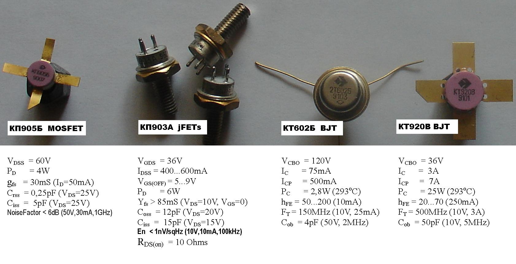

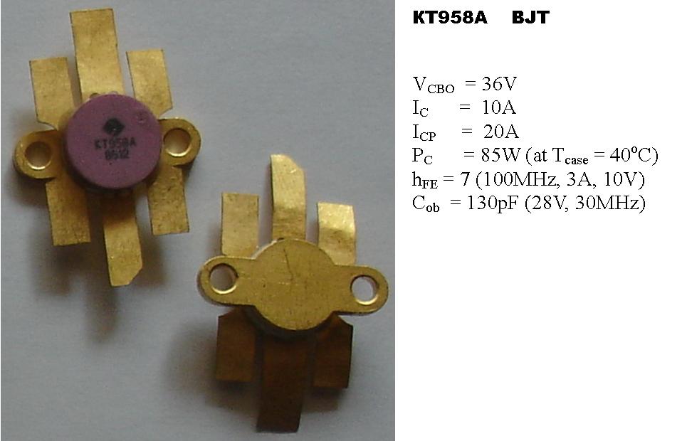

Another side of motivation is that I have got new lots of fancy BJT transistors for UHF applications. One kind of transistors is KT920B (up to 25W collector heat dissipation), it was used in the present version. Another kind of transistors, KT958A, have up to 80W heat dissipation (pins isolated from case), they are to be used in future versions. Apart from good specs, these parts give some additional pleasure, from their yellow-shining view.

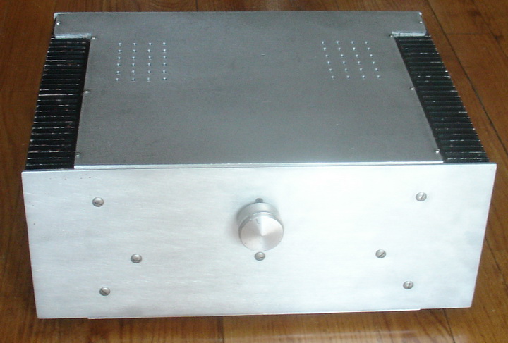

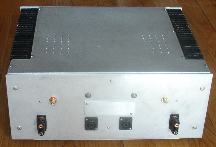

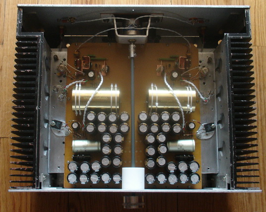

The present version is low-wattage (3…5W) integrated amp, with several audiophile measures taken. Binding posts are Eichmann (gold-plated), volume control pot is Penny&Giles RF15 10K, input wiring is from bulk silver wire in Teflon tubing, output caps are Obbligato Premium Gold 47uF/250V and Nichicon Muse KZ 1000uFx50V. Also attention was given to anti-vibration measured, the PCB is fixed in 16 points, and has downside support in the middle.
Without input R1C1 filter the schematics is very fast, low-signal time shift between output and input sine signals is near 15nsec, but at the maximum volume pot position some ringing is observed on the top of 1MHz square wave signal. This R1C1 makes the situation quiet.

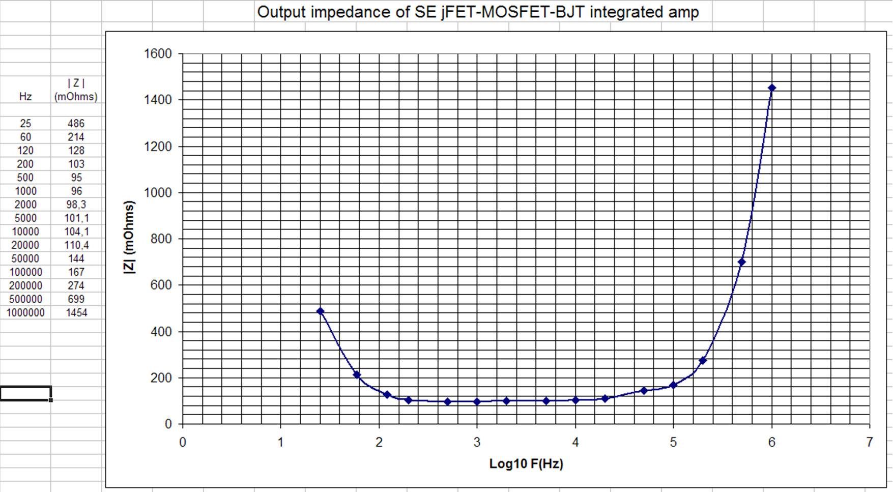

Noise level at the output (max volume) is below 100uV peak-to-peak (thickness of the line at the screen of the scope), complete silence from speakers. Output impedance is 0,1 Ohms.
I expect that it is not difficult to increase output power of this BJT version of the amp.
I plan substitution of VT8-2 KT920B by KT958A, and VT8-1 (the KT602) can be replaced by a medium power transistor with two-three times higher hFE than KT602, like 2SC5694 (hFE=300 is usual for them) or 2SC5707.
Both KT920 and KT958 sure could be substituted by modern parts from NXP or Motorola.
I would like to ask, possibly this question has already been discussed regarding BJT output stages. What is preferrable, a pair of BJTs with higher hFE, or a triple BJT with lower hFE ?
I have read some objections about using high hFE parts, as they have higher base to emitter resistance. On the other hand, additional part is an additional source of non-linearity. Or current matching to driver stage is the only reason for using triples and quards ? Would be grateful for opinions.

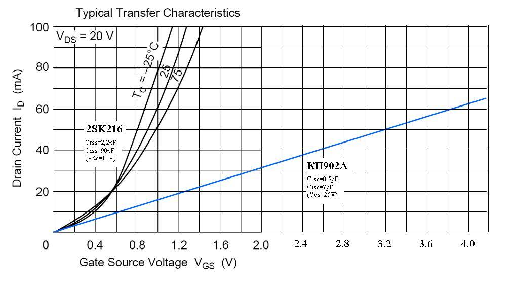

Here is another version of this schematics topology, it provides more power and still similar perfect sound. T2 could be replaced by 2SK215 (with decreasing R3), and T3 could be simply a resistor. T10 could be some other current source, based on MOSFETs or BJTs.
T2 and T3 must be close to each other, mounted on the same heatsink.
Output impedance modulus 15 mOhms (1kHz). At frequencies below 100Hz, impedance has a capacitive character, above 50kHz - inductive. Output power - 20W at 8 Ohms, 10W at 4 Ohms. Important resistors R5 and R6 - Kiwame carbon composition 5W.

Yes, there were some updates. In the post's 1 schematics, I have replaced the paralleled 8-jFET active device by simple triple darlington with powerful bjt VHF transistor (300MHz 300W) at the output. It is russian KT980A transistor for radio applications. This is a version that I enjoy most of all, the bottom end has improved compared to 8-jFET version. At the same time, I can not notice any "transistor" sound artefacts, no any GNFB atrefacts, even mids and highs are the same or better than from 300B SE tube amp. With 8-jFET I had a sound that is very close to the tube amp.
