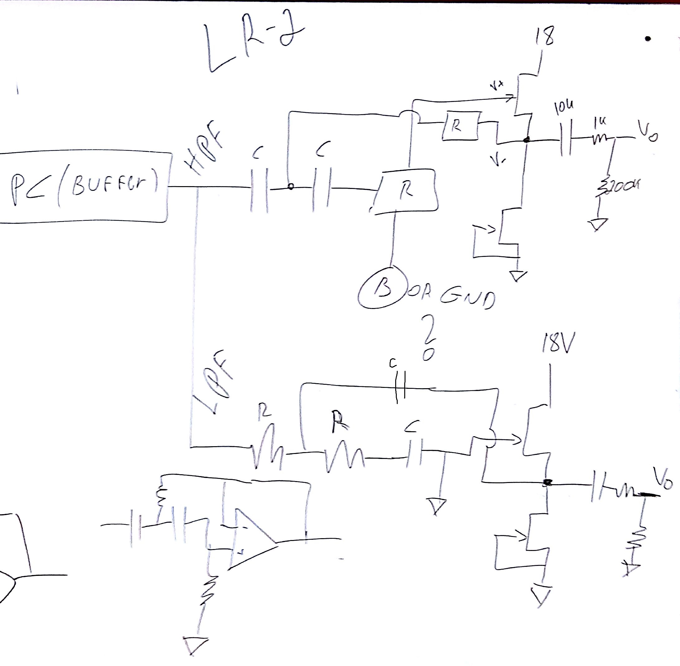

thought my hints would make the issue obvious :scratch:

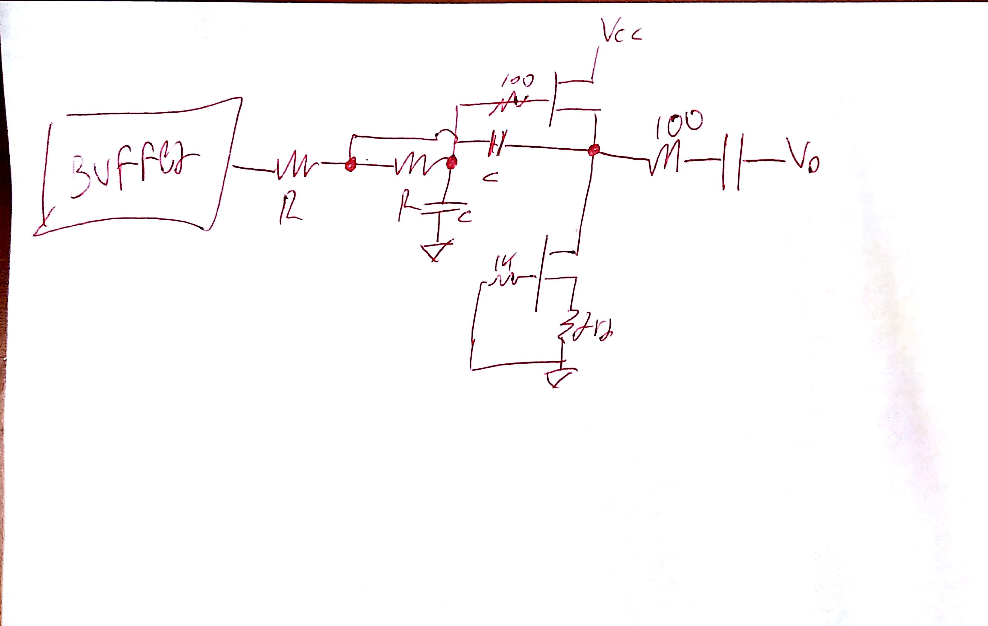

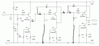

In no4 of #248 the 2R are connected to gnd.
They are part of the filter and as such their value defines the filter function.
In no2 of #248 and #257 You sketched the 2Rs connected to the Bias network, which here adds 10k and 9k1 in parallel to the 2R value.
Seems You somehow guessed something like that, as You didn't use a 330k resistor for that branch.
No wonder the filter behaves not as expected but a lower crossover.
As You need a bias at the gate of the upper JFET connect bias to the 100R gate resistor (add another 330k between bias and the gate resistor)
jauu
Calvin
jauu
Calvin
hi
yasss, its work, so simple !!
But only when i connected the bias to GND, why?
About the bias: connected it straight to the gate trough 330K(or 1M like B1) ? And the R to GND?
(i dont use the bias cap, only 2* 10K)

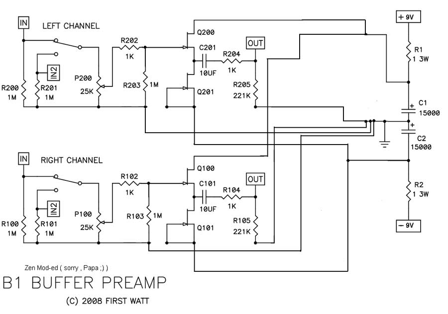

i want to build this filter according to the B1 buffer, so i give up for the stopper resistor, see nelson pass scheme in #248.
results: See the results and the scheme, now its 12db/oct 🙂🙂
What about the curve change in 400-500 Hz? What is it? because there is no bias?
Thanks all

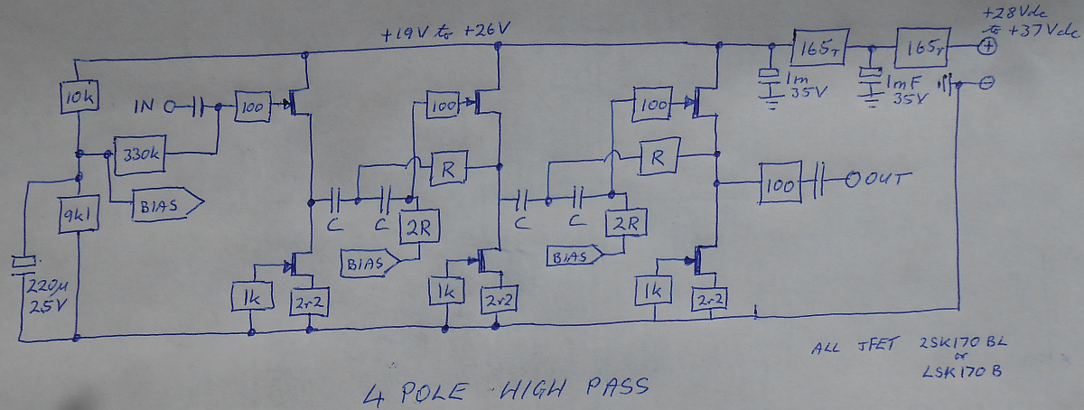

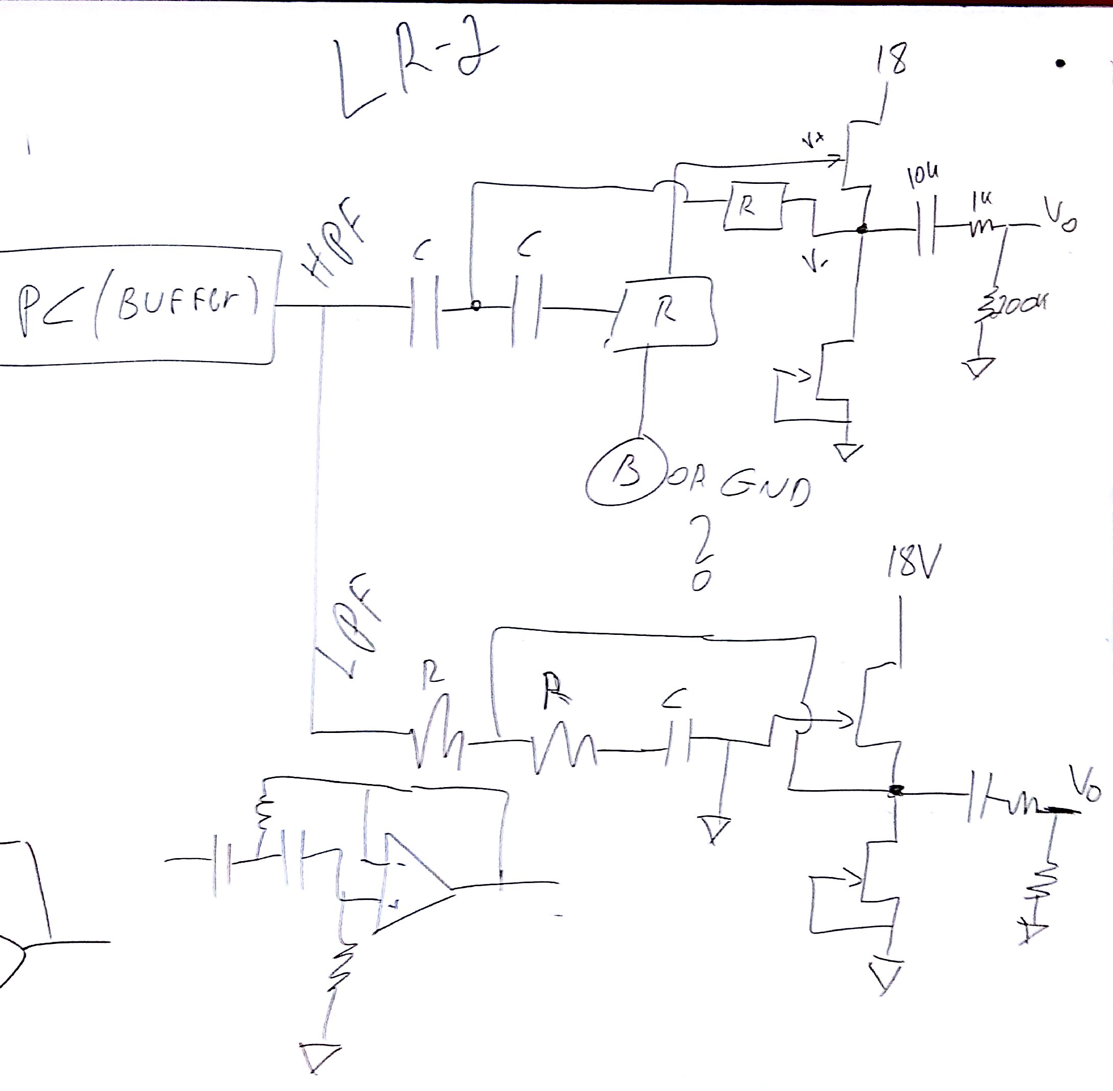

Some progress
i build the HPF Exactly like AndrewT (pic-1), only 2 pole.
The results are best, the 220uf cap is important, the bias need to connected to R and its work, thanks.

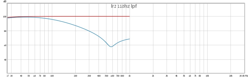

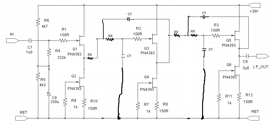

About the LPF i need HELP (pic-2)
Build same scheme like pic-4, only 2 pole. but i have bump (550Hz) in the results(pic-2), try to replace the transistor, caps, resistor, nothing helps.
Whets wrong?

Hi
today i try another option. filter base on dual supply B1 buffer (see picture). the results is same.
the HPF is work great, the LPF is the same (CY connected to -VCC) 🙁, bump in 550Hz. picture in #273
mybe its the 2sk246 (3-4ma IDSS) or Ciss=10pf ?

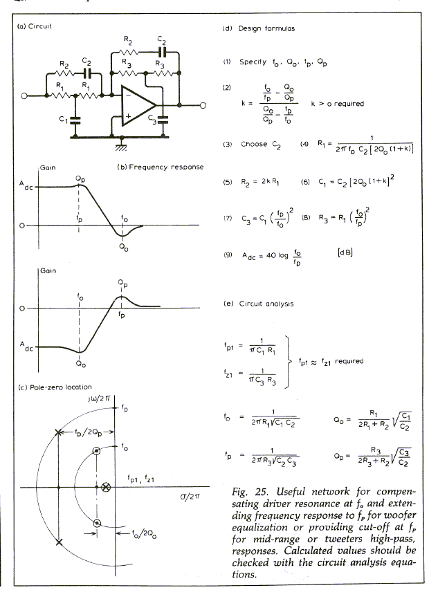

OK i think the issue is start to ending.
according to the theory, my f0=500, fp=50, so the Adc=40db !!!
That exactly my results!
see picture my LPF and the theory
What do you think?

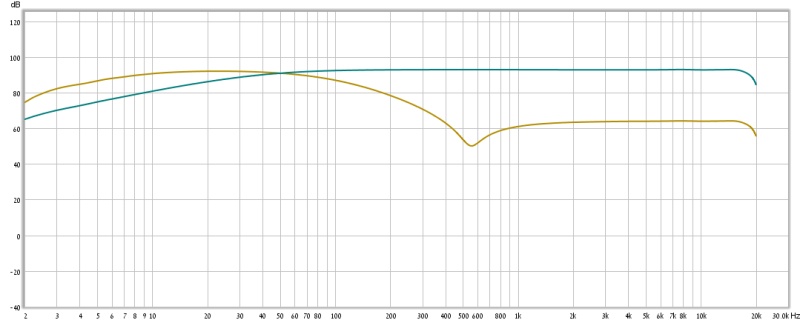

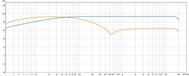

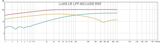

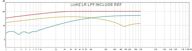

20-40Hz its ~95db (sorry for the Resolution)
1Khz its ~65db
my problem its not the 10db more or less, its the Understanding.
more important, this Phenomenon that the filter stop to fall is normal ???? if it is, i try to change the design until get the results.
Add another plot
thanks
here is a modified B1 style LR4 showing the alternative output connection to avoid the lack of HF cut of the standard unity gain filter.
I'm not sure your result is showing the same problem, or a different error.
I see I downloaded this in February, i.e. after I built my low pass bass only filter.
There is at least one Thread that discusses this.
