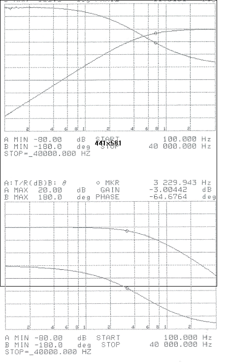

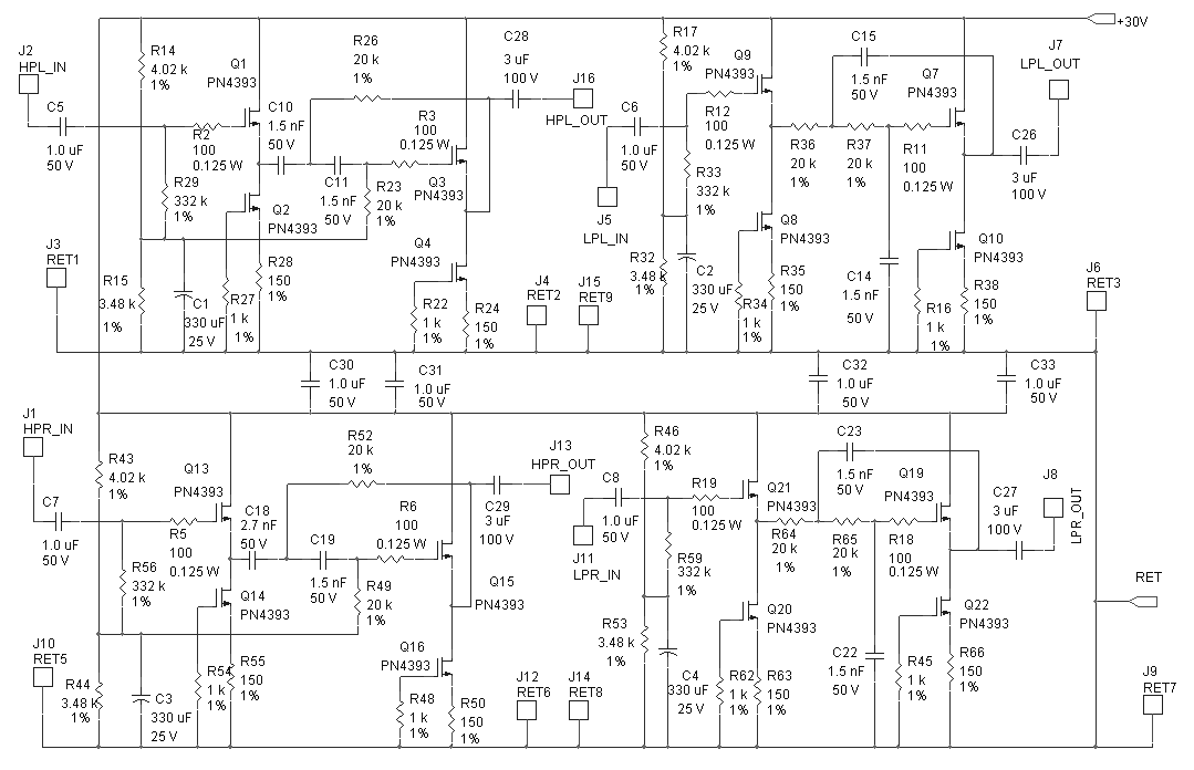

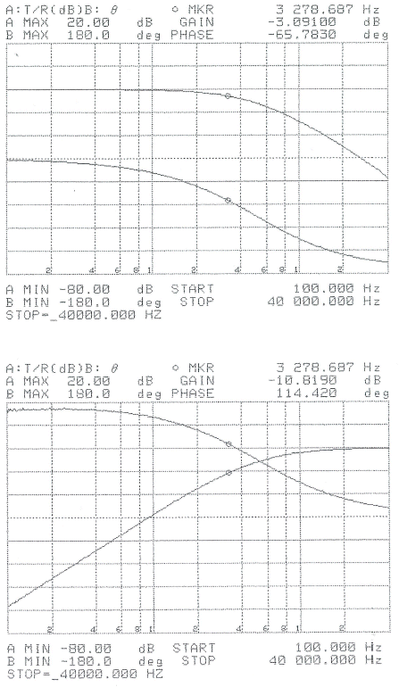

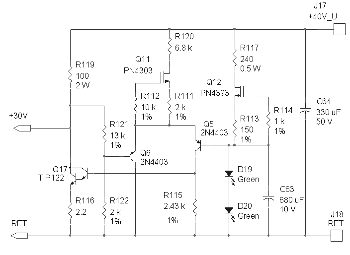

Attached is a stab at an active crossover based on unity-gain Sallen Key filters built around a simple current source loaded JFET source follower. The circuit is designed to run on a single supply to accomodate my preamp setup, which uses simple single ended jfet/mosfet-based circuits running off an external 40V unregulated supply. Each functional block inside the preamp (RIAA amp, line amp) has its own on-board regulator. This will be the third functional block so I can finally biamp my system. I deliberately used a simple follower this time around - one obvious frill would be to add a load resistor and cap to each follower as well as changing resistors R16, R22, R27, R34, R45, R48, R54, and R62 to change the simple followers to "FETWhites" for lower output impedance. Folks using +/- supplies might want to consider complimetary followers and/or servo circuits, as the latter would allow eliminating some output coupling caps.

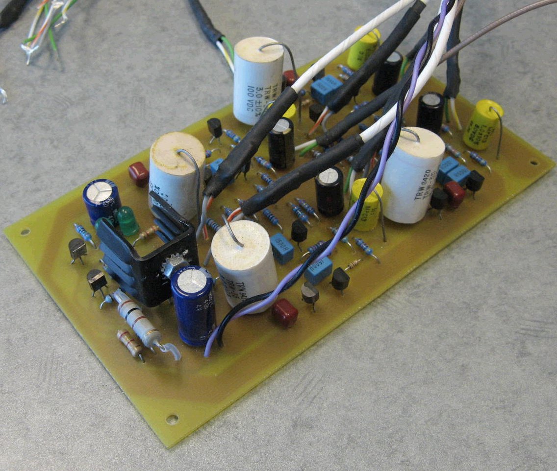

This one is already built up, and will go into my preamp test setup when time allows.

When I finally get to listen, that will tell the tale. I strongly suspect that the difference between biamping and a passive crossover will wipe out subtle (or less than subtle) differences in execution until I get used to the new sound - then It's time to play around.

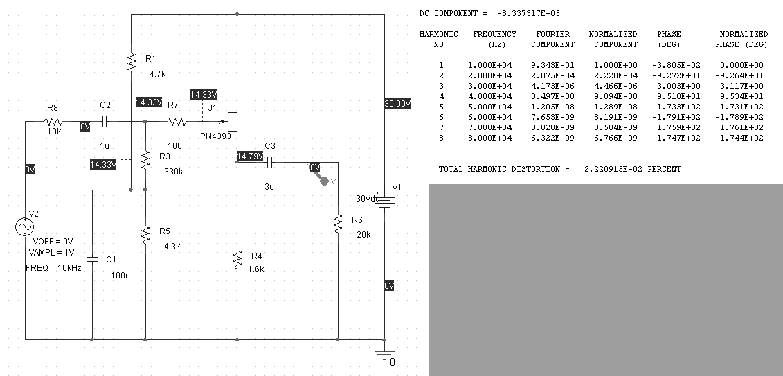

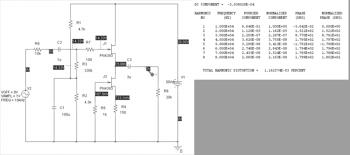

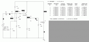

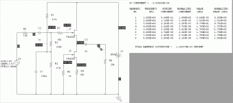

For grins and info, here's a comparison between current source loaded and non-current source loaded source follower with similar bias. Simulation was performed in Pspice with the device models provided there. First, a source follower with just resistive loading.

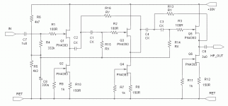

Hi Wrenchone,
For now, i am using 24db L.R. op amps crossovers which are the weak point in my system.
I am interested in transpearent crossovers such as yours.
Trying to understand your schematic...
You use two stages for each filter. Is the first one a buffer only or does it participates to the filtering?
Which slopes do you get? Which alignment?

The two fets in front of each stage are a simple buffer, so that each filter is fed by a low impedance. Since I mean to have a level pot in front of each filter, this part was pretty important. It allows one a lot more freedom in choosing a value for the level pot, so that I don't load down the line amp that's driving the crossover. The filter stages are 12 dB/octave, and the alignment is meant to be Linkwitz-Riley. Right now I have the filters set for about 5kHz.

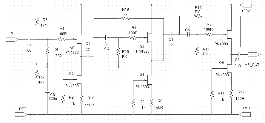

Do you think 12db/octave are enough for a tweeter down to 2000Hz (Fs=650Hz)?
Is it possible to cascade two identical second stages to obtain 24db?
I intend to use a couple of dual pots for my crossover, but there's nothing stopping one from using a separate pot for each filter, so you can both set level and adjust for sensitivity differences between a pair of speakers.
This is just my opinion, but I would want a steep crossover for a tweeter with low resonant frequency to keep it from being overdriven by low frequency. Making a 4th order filter is fairly straightforwrd - use the buffer in front, then cascade two filter stages. The two cascaded stages will need a different Q than the single stage filter for proper alignment. All this is described in concise detail in Linkwitz's web site on active crossovers. Do a search for "Linkwitz-Riley crossvover", and it's one of the first things to pop out. The Rane paper on crossovers is also useful reading.
Here's a representative schematic for a 24dB HP filter in the style I've been using so far. The R's and C's for frequency/Q determination are left open for whatever the experimenter has available. All the Cx values will be equal. The Rx and RY values are chosen and ratioed for the required crossover frequency and Q. The Linkwitz site on active filters (Google is your friend...) is an excellent and concise guide for this.
