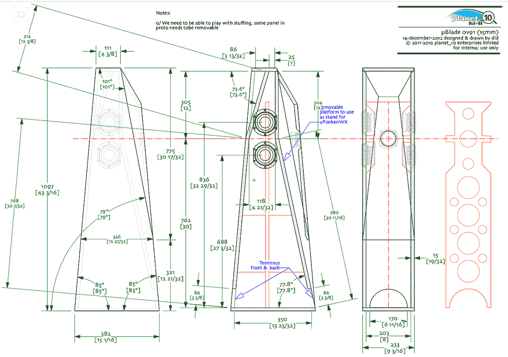

Mass Loading = restricted terminus.
A folded ML-Voigt for the FE108e∑.
Nandape has done a bunch of those.
Here is one we did for 4 Peerless 830870. Here the restricted terminus is just the thickness of the build material. It has a midTL on the front and we had to contort the shape of the Voigt.
And an example of a Woden Festival ML-Voigt
dave
