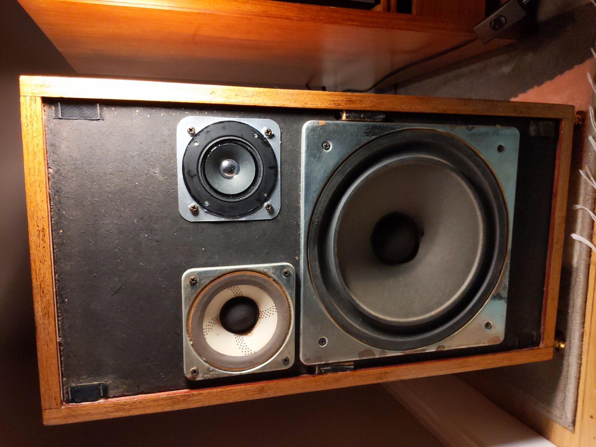

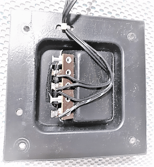

Did you check the speaker terminals cup?Both enclosures had missing caps.
So when you replace the surrounds the compliance may have changed, along with the sensitivity. You might want to tweak the crossover just a little.

P.S. chrisng seems to have solved the mystery of the "missing" capacitor.
What say you now, Cliff?
Hi Galu & Chris.P.S. chrisng seems to have solved the mystery of the "missing" capacitor.
Great detective work.
The caps were well camouflaged, sitting behind wiring & terminal block on the back of the terminal plate.
2.7uF deteriorated to 3.2uF & 3.5uF (on old tester).
I've now refoamed the woofers & replaced the caps with Teds.
2 x 2uF in parallel to make it 4uF to each tweeter.
I hope 1.3uF variation doesn't adversly affect them.
The Jensens are sealed boxes but only had lining around back, top & bottom of the boxes.
I stuffed them with cotton/wool wadding.
Sound reproduction was very acceptable.
I'll also freshen up the matt black on the baffles & re glue some of the vinyl wrap which has lifted.

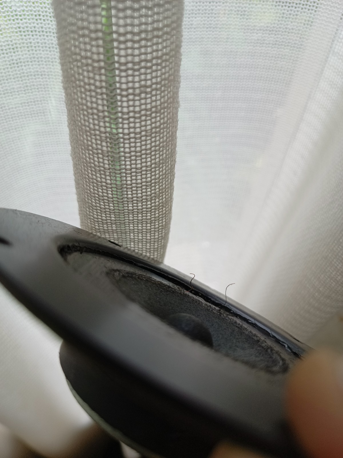

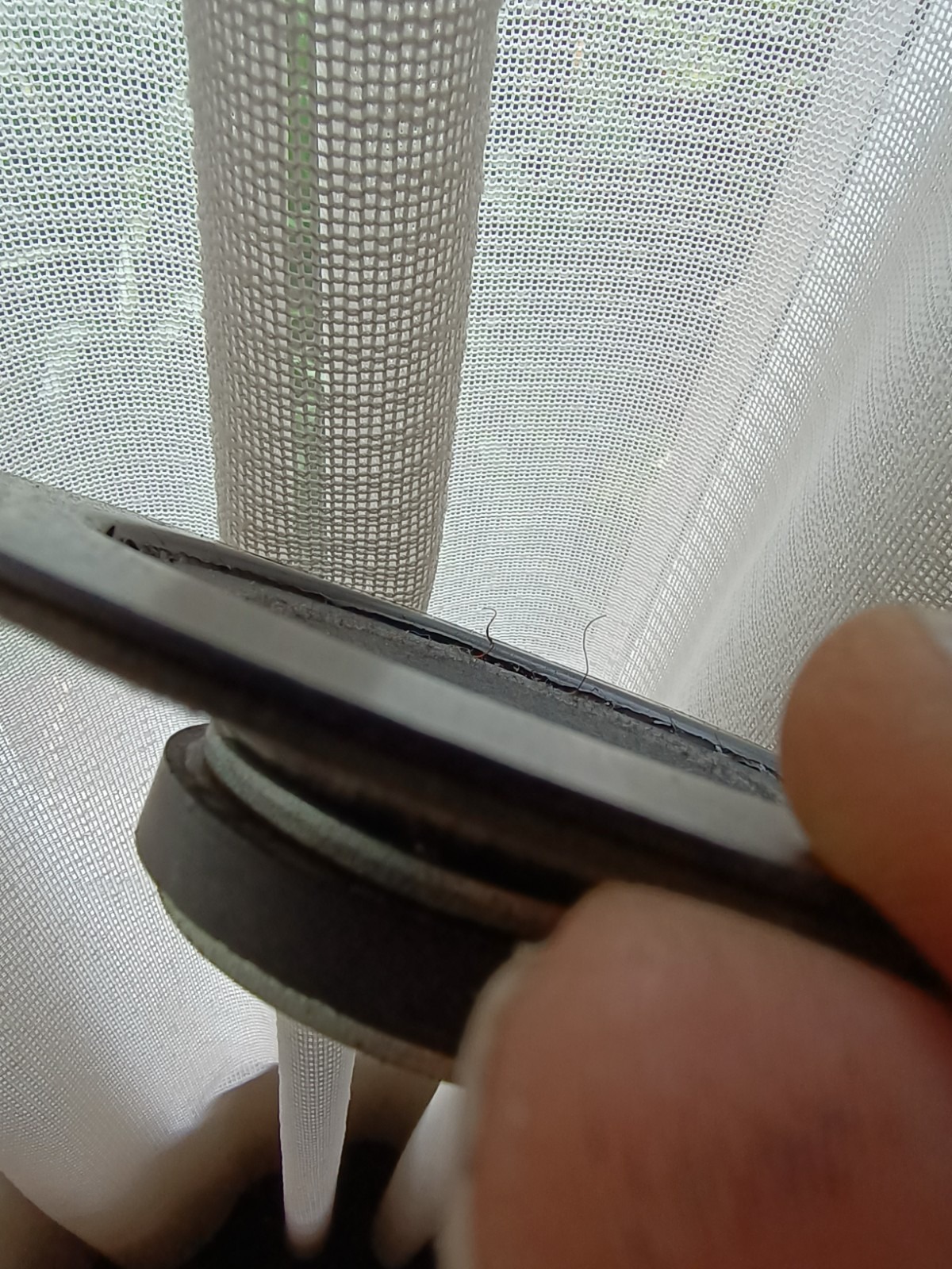

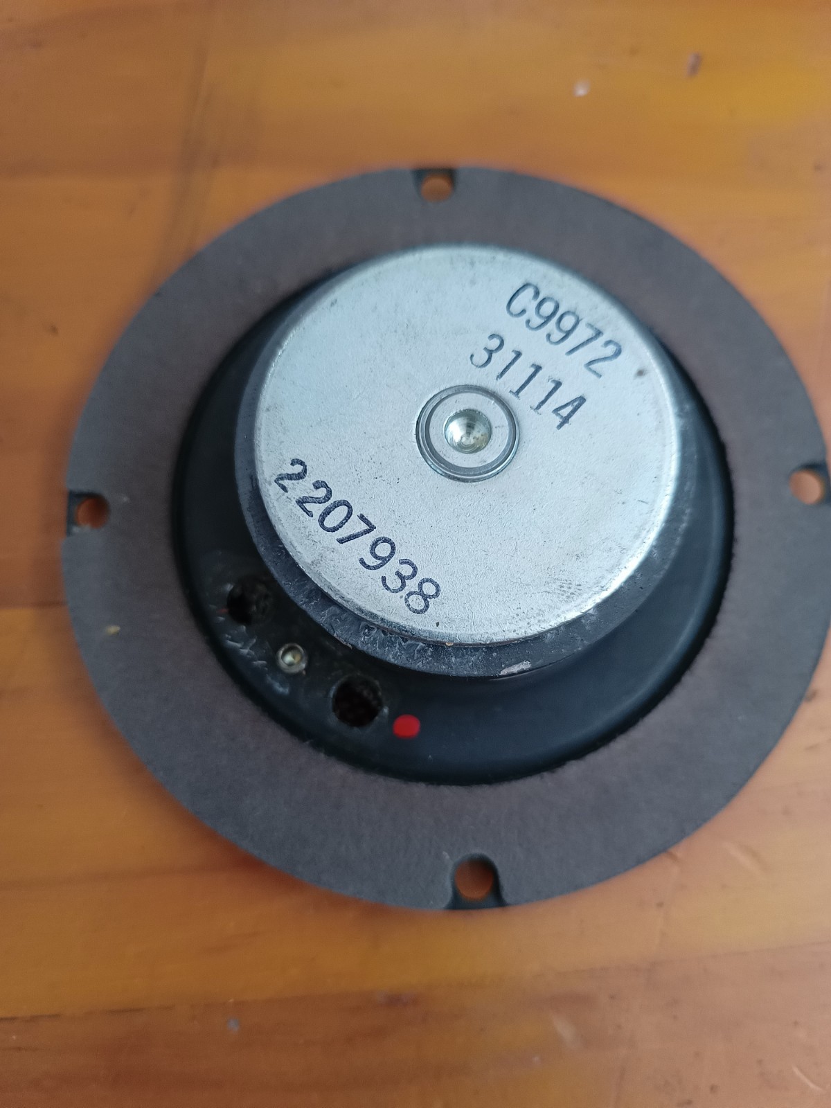

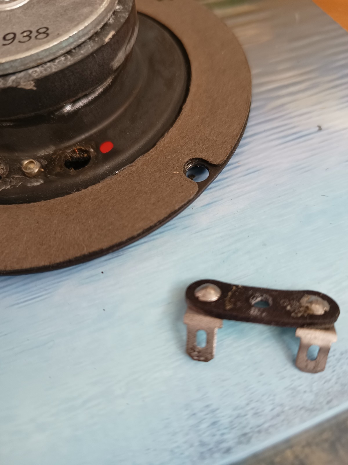

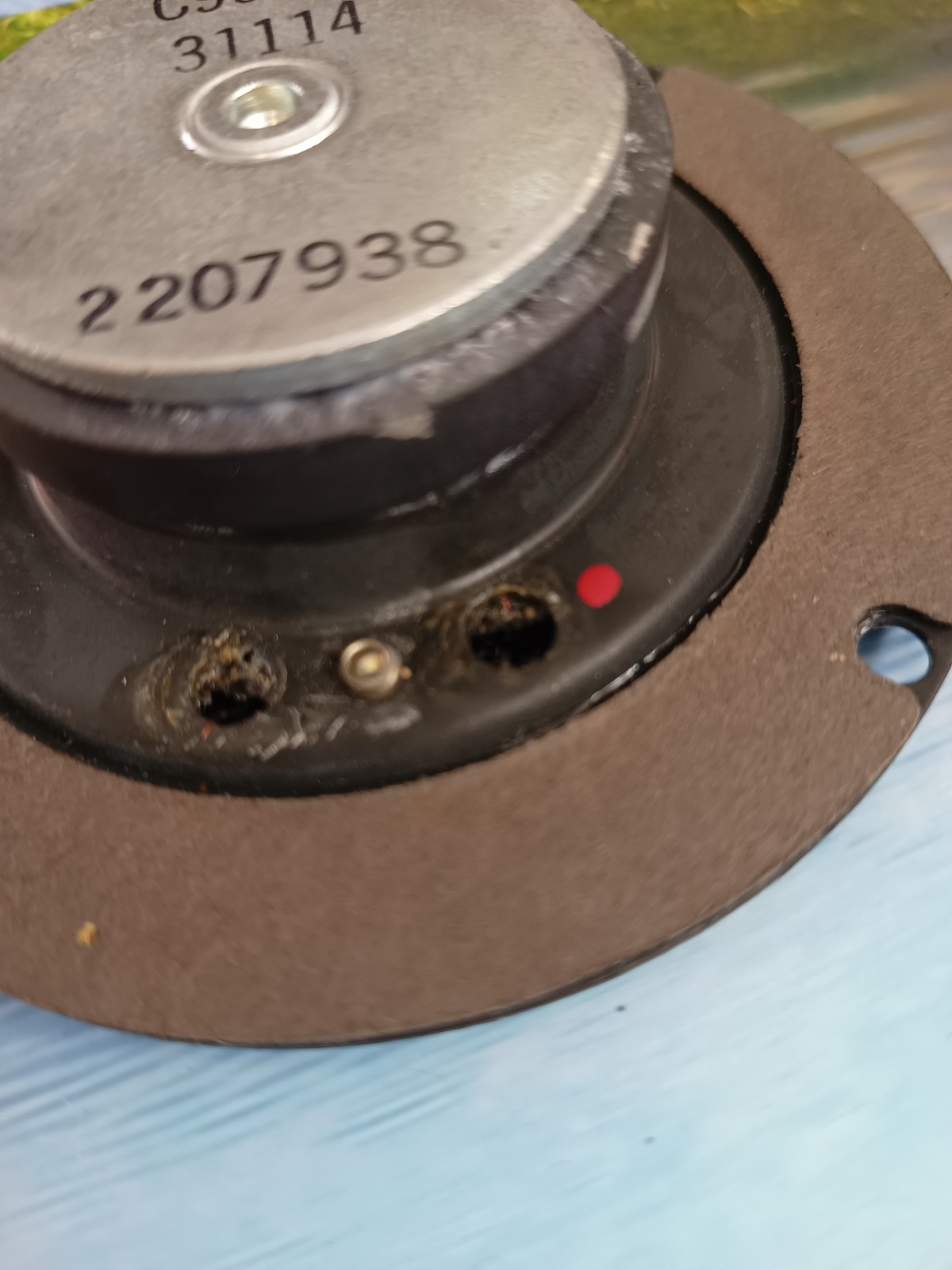

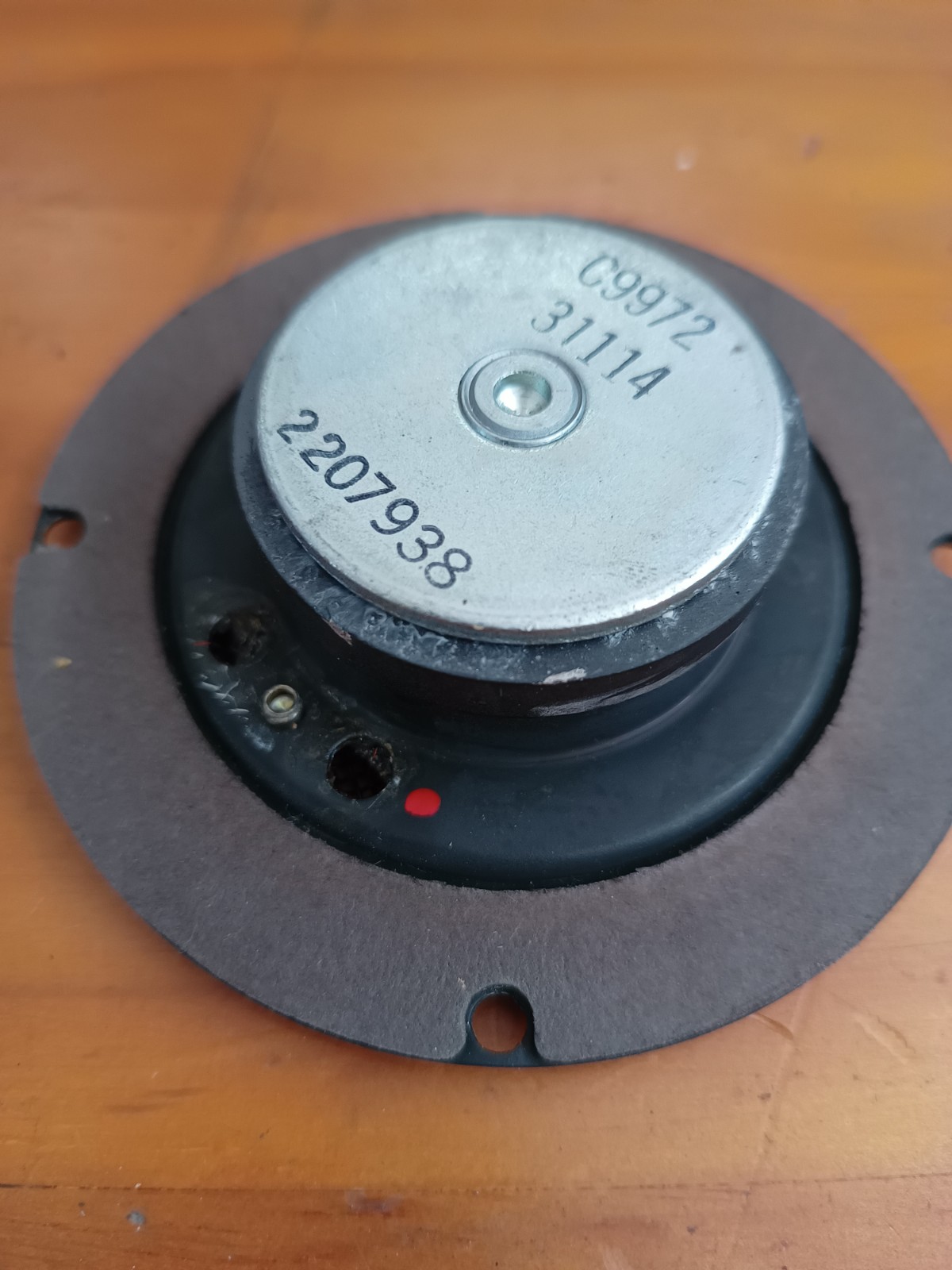

One of the tweeters has had the fine wires from its terminal severed from the driver (see photos).
I think this is a very delicate repair job as the wires are very fine.
Don't know how to tackle it?
So, the tweeter terminals have been competely ripped off! 😱 From your photos, I can't really see how you're going to get access to the tweeter wires in order to solder on extra lengths of fine copper wire. If it is possible to access the wires, you will have to carefully scrape the enamel off the ends before they will accept solder.

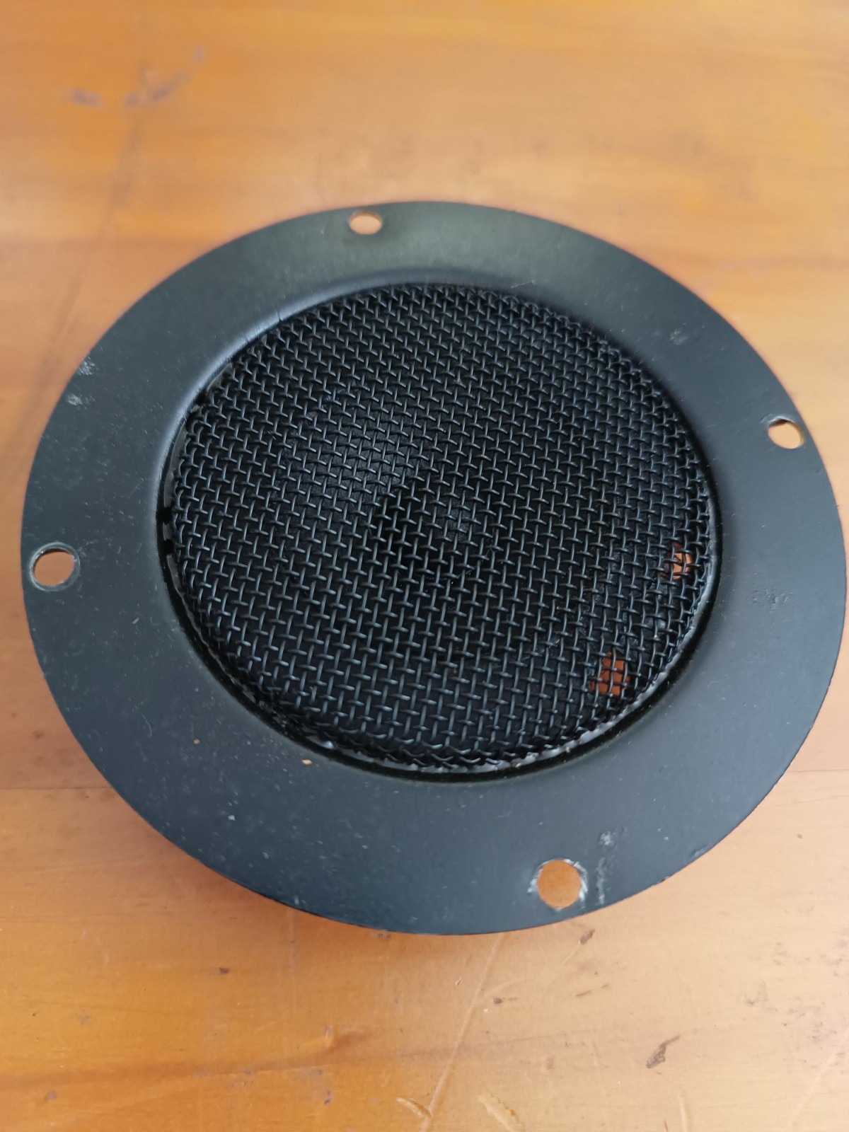

If you look carefully in the photo you can just see the end of one of the wires, with dried silicone around it.
If I could move the grill away I might have access from that side.
Don't know if the grill is just glued in position or fastened some other way.
I'd like to prise it away but not damage it?

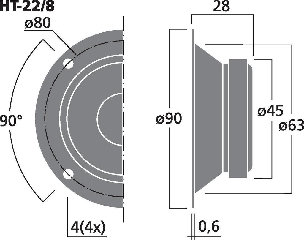

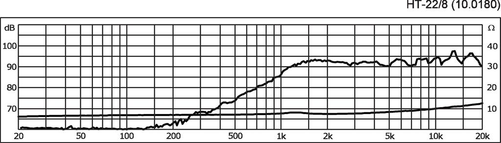

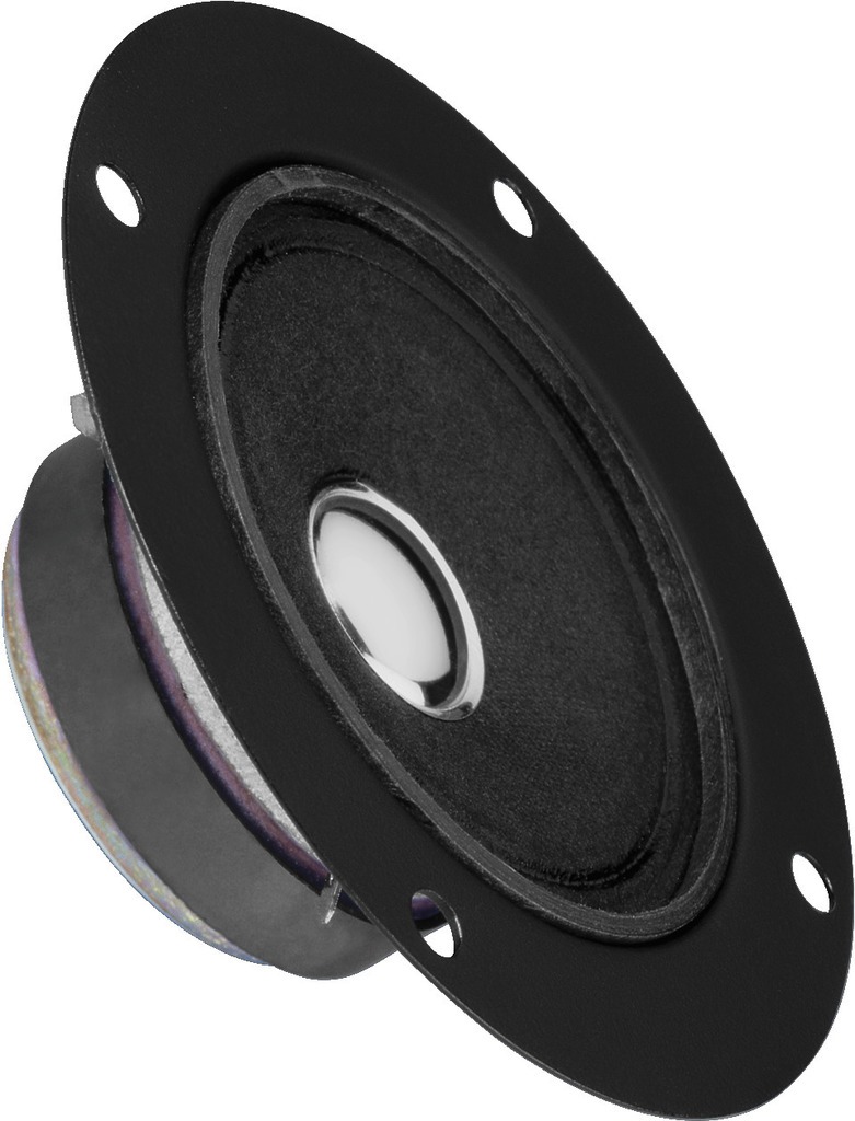

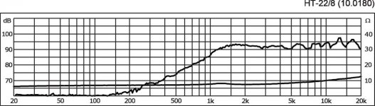

It seems likely that you will be looking for a pair of replacement cone tweeters.
To that end, please measure the DC resistance of the working tweeter and its overall diameter.
The Monacor HT-22/8 tweeter is a likely replacement. Although inexpensive, I suspect you won't think your restoration will justify their cost!
https://www.amazon.co.uk/Monacor-HT-22-Cone-Tweeter-Ohm/dp/B002FB1FYW

The Monacor's look very similar, but the diameter is a little out.The Monacor HT-22/8 tweeter is a likely replacement. Although inexpensive, I suspect you won't think your restoration will justify their cost!
Monacors = 90mm to 63mm diameter rebate.
Existing = 107mm to 87mm diameter rebate.
Apart from making sure there's no protective coating, is there a secret to soldering very fine wires?
If there is, I'm not telling you! 😊
You can always fashion an adaptor plate as shown in the attachment.
I'll go for micro surgery.So, the tweeter terminals have been competely ripped off! 😱 From your photos, I can't really see how you're going to get access to the tweeter wires in order to solder on extra lengths of fine copper wire. If it is possible to access the wires, you will have to carefully scrape the enamel off the ends before they will accept solder.
I can try to twirl some cat6 wire onto the hair like wires which feed the tweeter voice coil and then attempt solder.
Worried heat might melt the copper??
I never gave up on these.The melting point of copper is over 1,000 degrees C.

I worked backwards.
Turned out one of the tweeters had the terminal ripped off and fine wires leading to the voice coil torn.
Cut a long story short, I performed micro surgery today.
Using strands of some very fine copper wiring I was cable to extend the voice coil wiring by soldering extensions.
Had to fool around several times.
The wire was so fine the solder just didn't want to adhere.
In the end success.
After stuffing the boxes with wool/cotton material, re foaming the surrounds on the woofers, replacing the 2.7μF old caps with Teds 2μF caps, and resoldering the tweeter voicecoil wiring, finally the Jensens work.
