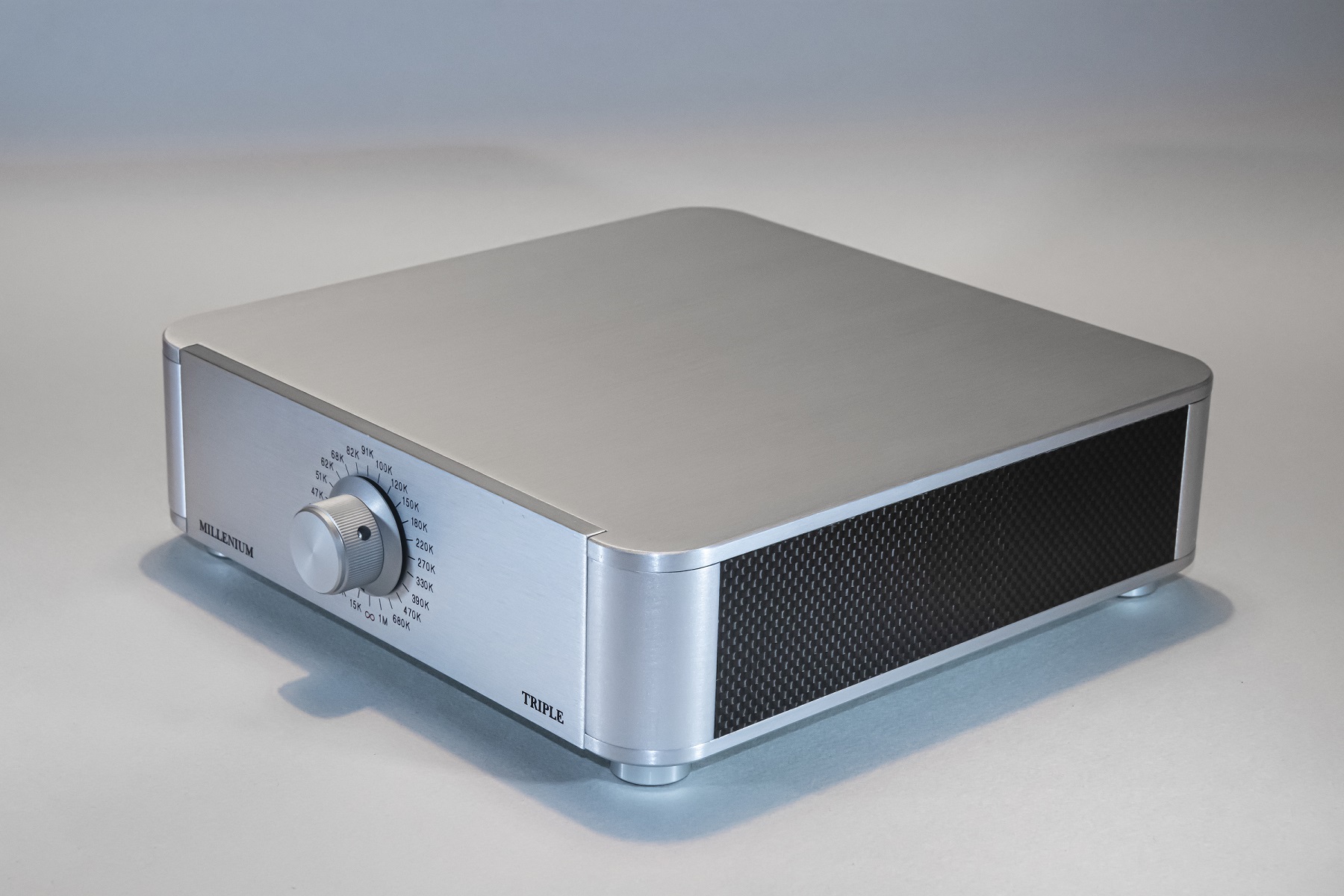

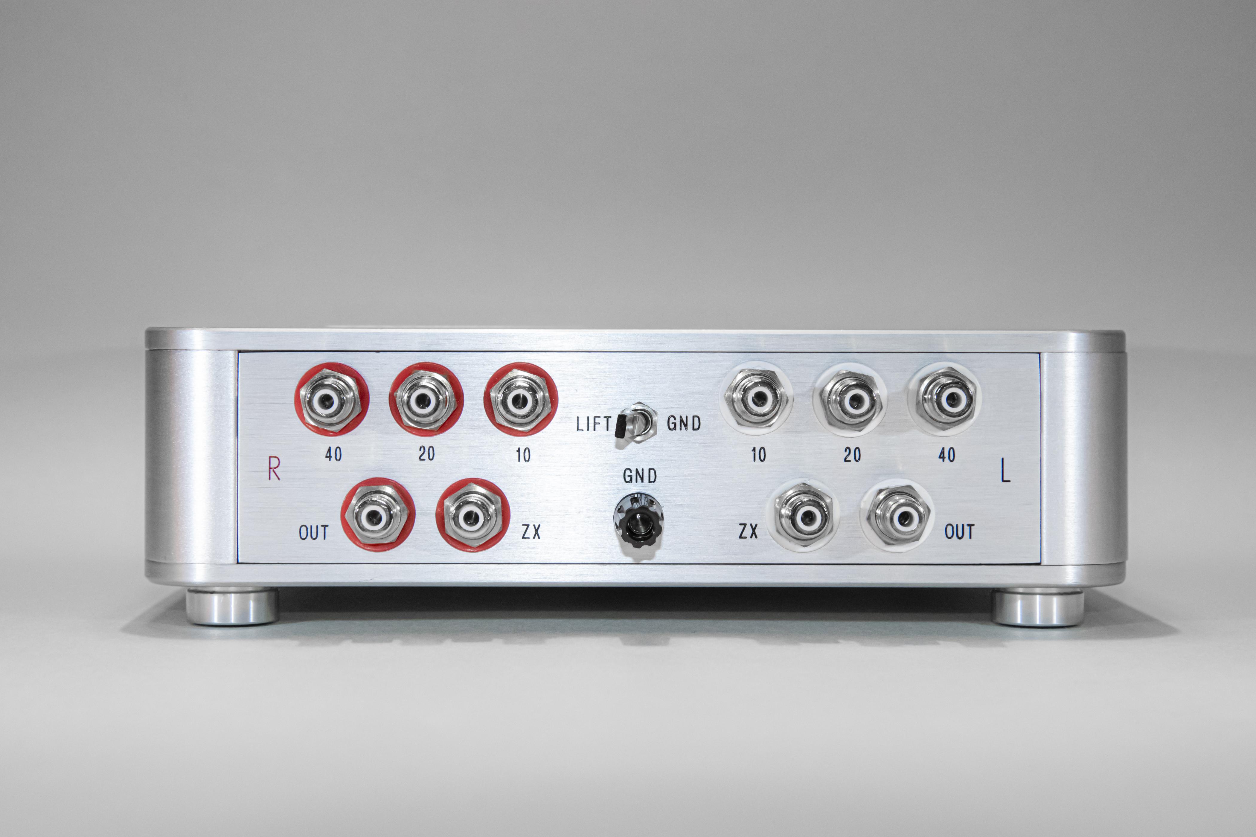

I have a type made for me from Sowter exactly the same of 999.
In attach the freq. response of the three ratios.
I built a step up with the possibility to change the load on secondary to trim the reflected impedance
If interested write me.
Walter
