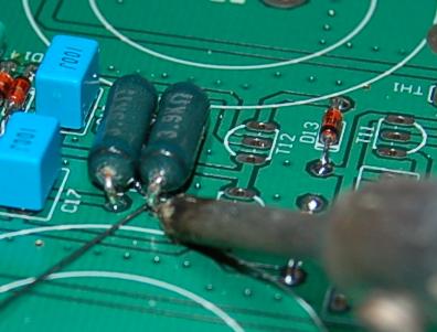

I got my Hakko on sale at Fry's and I'm the one having the trouble. Hmmmmmmmmmm I have to say the tip does last a long time and it does heat up fast. Here's a pic of one of the boards. Any opinions?? pchw- I need 2 boards too- email me!!

BP: We may be able to salvage your boards yet!
Please see the photo on how I start each resistor lead (solder top first, flip board and solder bottom(after trimming lead to 0.25-0.5"). Oh, and for a tightly-clustered bunch of components, I stuff and solder one at a time starting near the center of the group. Time consuming? yes. Problems? no.:smash:
Lesson learned:If buying surplus resistors, check lead material(avoid steel )! Cheaper isn't better!😱

This is what I believe was the the problem. I used a resistor with extreemely thin coating over steel leads. I buffed the leads and Chas did not. He was able to get his to adhere to the solder because he had not buffed the lead. I, instead, tryed to make the lead even smaller removing all the tinned coating. I then tried to solder the the steel wire to no avail. Does this make any sense??

I thought most of the quality resistors we use today had PURE copper leads. Am I way out in left field on this? I always try to buy a major name brand item and hoped for good parts. They seem to bend like copper.
