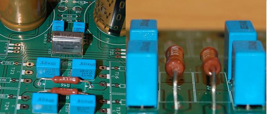

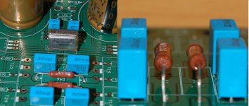

The 5W Mills(MRA-5,$2ea) is SO TINY, compared to the silkscreen layout, I wondered if it's a good choice for the emitter resistors...
The 12W Mills(MRA-12, $3.50ea) is just too big to fit the space allotted.
Is there another resistor, comparable to the Mills, that might be the right size/rating?

chas, I used the 5 watt and they were a good fit. You can still use Panasonics. They are excellent.

Chas,
Short version: the "little" resistors are fine.
Long version:
Modern materials allow higher dissipation in smaller packages. The power rating is based on continuous average conditions.
Actual dissipation in emitter resistors is quite low. Working backwards, with a 0R47 resistor:
We'll use the rule of thumb that you want to keep dissipation under 1/2 rated dissipation.
For 2.5 W you'd need current under 2.3A. That means your RMS current output for the amp would be limited to 11.5A. That's not peak, which would have to be MUCH higher with music to reach that average.
11.5A into 8R is 1058W and 528W into 4R. Five pairs of MJL4281/4302 wouldn't last long in that environment.
Even 100W RMS into 4R means only 1A per emitter resistor, or .47W.
You're right- and there's plenty of space for cooling...🙂
I guess, even though I'm running 75v rails and a 4 ohm load, I'll still probably never smoke 'em.
Thanks for the analysis.
