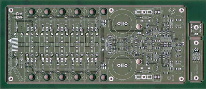

Not quite the same page BP. See http://www.delta-audio.com/Leach-Clone.htm This board has 10 output devices.
Leach clone PCB

BobEllis said:Wiki page http://www.diyaudio.com/wiki/index.php?page=Leach+amp+10+Output+device+Group+Buy+
Brute Puppy - that's the new layout awaiting prototyping. The Wiki has a link to the current board or you can visit http://www.delta-audio.com/Leach-Clone.htm to find Jens' writeup on his design.

OK Bob,
Try the picture below. Now if that is correct, I have a question or three. Can I build an amp with this board using TO-3's and wire them from board to heat sinks? Can I build the board with less than 10 outputs per channel (like 4,6,or 8)? Are there part changes or jumpers required and who, where, will I get direction to build the lesser design?

BP, that's the one.
Yes, as mentioned earlier you can use leads from the board to TO-3 sockets - the original Leach amp did. Stay with slower output devices and short as possible leads to minimize the risk of oscillation, though.
Yes, you can reduce the number of output devices used. No jumpers are required, just leave a pair or two unpopulated. Earlier in the thread a rough 3 plastic devices = 2 metal equivalency was mentioned.
The deign trade-offs are something you'll need to crank though yourself, although you'll get plenty of help here. There isn't a "how to scale my leach amp" reference I am aware of.
In general, at a given rail voltage, the fewer output devices, the less tolerant of low impedance loads the amp will be. You can improve this with more heat sink, but you'll need to run through safe operating area calculations that are both temperature and voltage dependent.
As rail voltage is reduces, the number of output devices needed decreases for a given load. If you want to drive a 1 ohm subwoofer array you'll still need multiple devices no matter what the rails.
While I know many are on a tight budget, IMHO, not fully populating the output section tends toward penny wise and pound foolish (false economy). Even at the single piece price, it costs less than $100 more to fully populate a pair of boards compared to using 3 pairs of outputs (the minimum recommended number of plastic outputs). In return you get a more robust amp that is tolerant of impedance dips at higher output levels. You can even use a bit less heat sink and still maintain reliability.

600VA will support outputs between 300W and 600W economically.
45Vac will allow about 350 to 380W into 4r0.
Stereo will cause quite a bit of voltage sag in the PSU but will still perform adequately.

Bob,
I've got a pair of large (600VA, I think) transf., which each provide
a pair of +/- 72v rails for stereo use.
I can use one transf per channel (two monoblocks), and my speakers are 4ohms nominal, 3.2 min. Any suggestions or forseeable problems here?
Would the 5-transistor boards be ok, or should I go with the 6-transistor boards?

You can go higher than 65, but then a few other things change and you need to watch the load impedance doesn't dip too low.
IIRC Jens is running a 10 output device amp at 75V - adjust the front end resistors R3, R12 for the rails (watch dissipation too), and don't try to use BC546/556- use MPSA42/92. They don't have the gain, but they will withstand higher voltages.
The problems you may have at 3.2 ohms depend on phase and signal amplitude. Unless you really push hard you should be OK if your heat sinks are properly sized.
800VA should run a pair comfortably, but since you already have a pair, why not go monoblock? I have an 800 VA transfomer driving 4 channels at 60V in a biamp setup. I use it at sane levels so I haven't had a problem with rails sagging.
