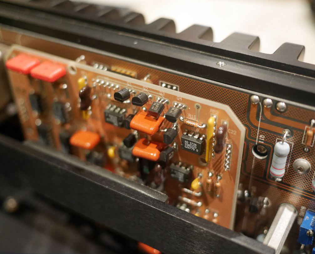

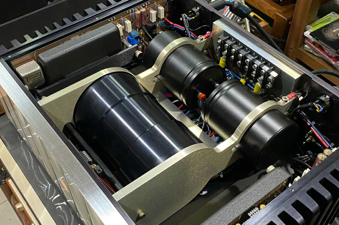

Incredible and rare images of this gorgeous amplifier; However, I am concerned about the use of IGBTs which I believe cannot be found in case of repair (even Mr. Nelson abandoned them ...).
Maybe I should look for the used Model 1 which, I believe, does not use them.

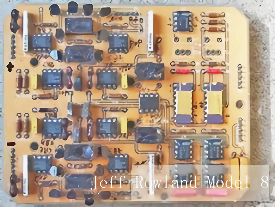

It is difficult to find Jeff Rowland's information on the Internet, and its voltage amplification module is sealed with epoxy ester. It is difficult to disassemble it intact.
But what do you think about Model1, it's a good choice on the used market (sound, reliability...)?

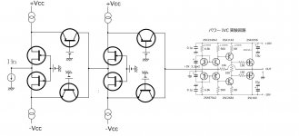

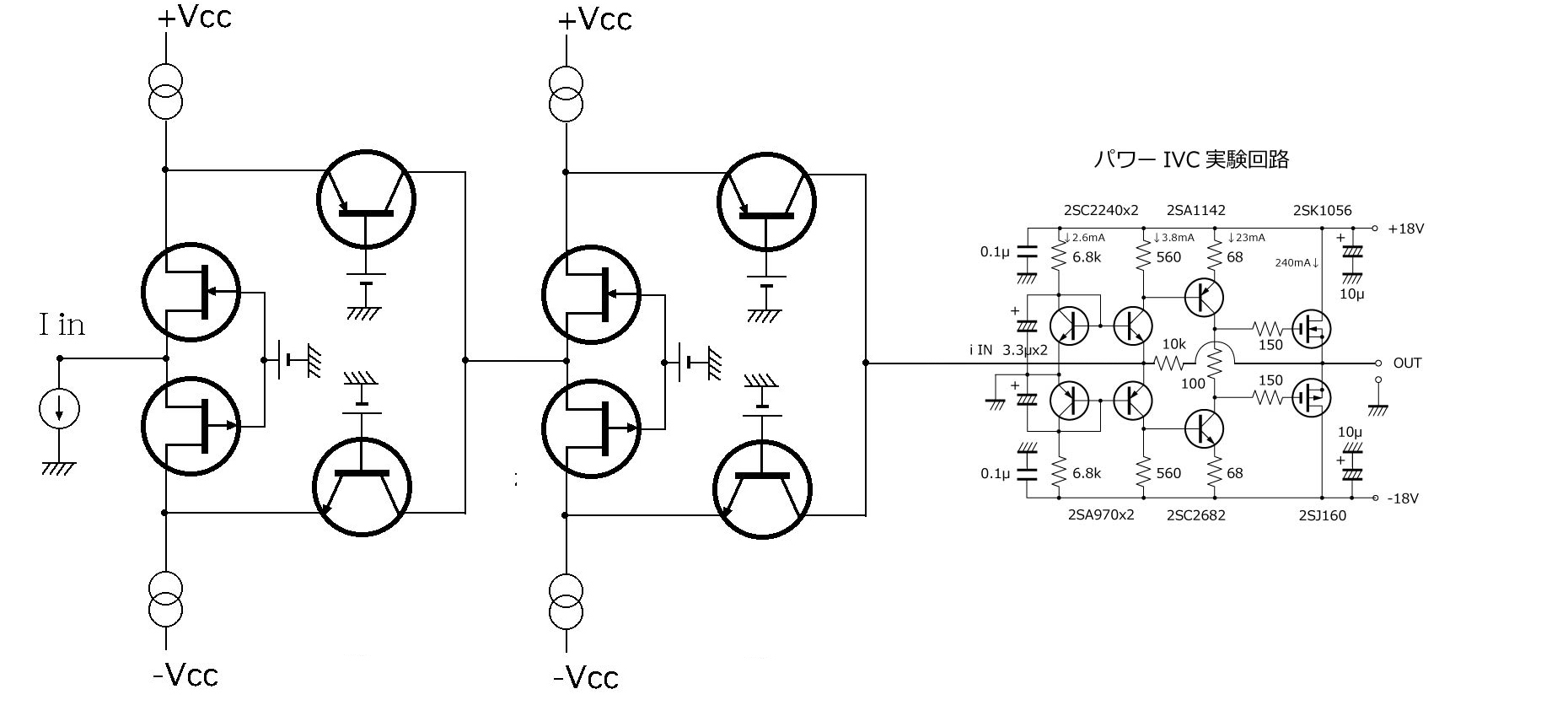

Jeff Rowland model 9 / model 8 / model 2 is a parallel current feedback IGBT power amplifier
