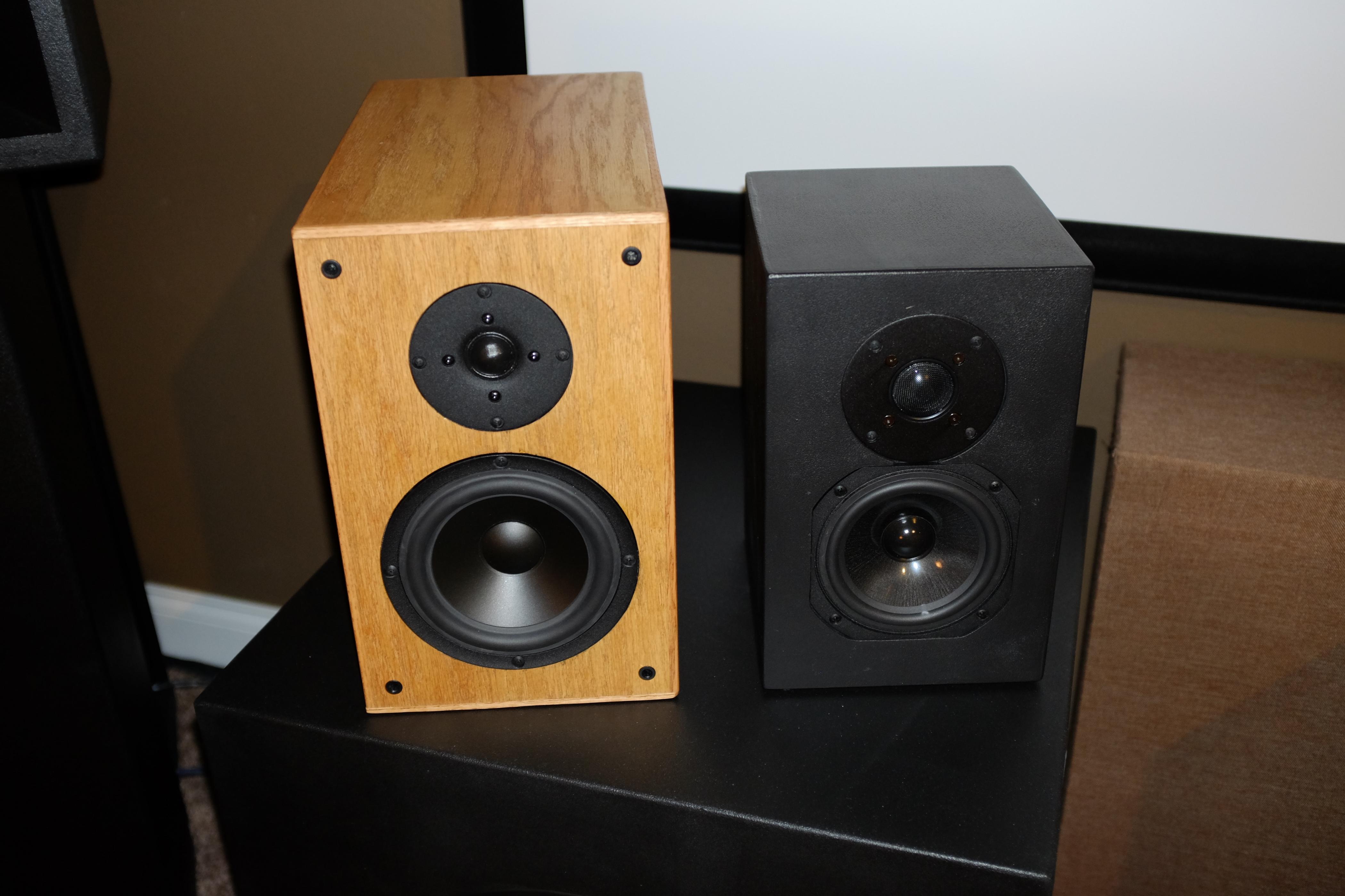

Several years ago I built a set of Tributes and matching subwoofers for a biamplified stereo system. The Meniscus kit used included high quality air core inductors, poly capacitors and metal oxide resistors. The cabinets were very inert, being fabricated from 3/4" baltic birch and including a window brace. The box was rectangular rather than the gently sloped pyramidal shape Jeff Bagby used in the original design. Measurements of the final product yielded a smooth response with good dispersion and low distortion above 80 Hz at any sane level. The Tributes remained in my home theater system for a few weeks and I don't recall any brightness or other anomalies. I did prefer to close the port with a foam plug when using the Tributes with the subwoofer system and placing the speakers fairly close to the back wall. Few small inexpensive designs are as revealing, yet non-fatiguing as these. It sounds as though your tweeters, crossover or enclosure may be the issue.
The attached photo has the Tribute (left) sitting next to a Continuum atop one of the subwoofers in my home theater.
