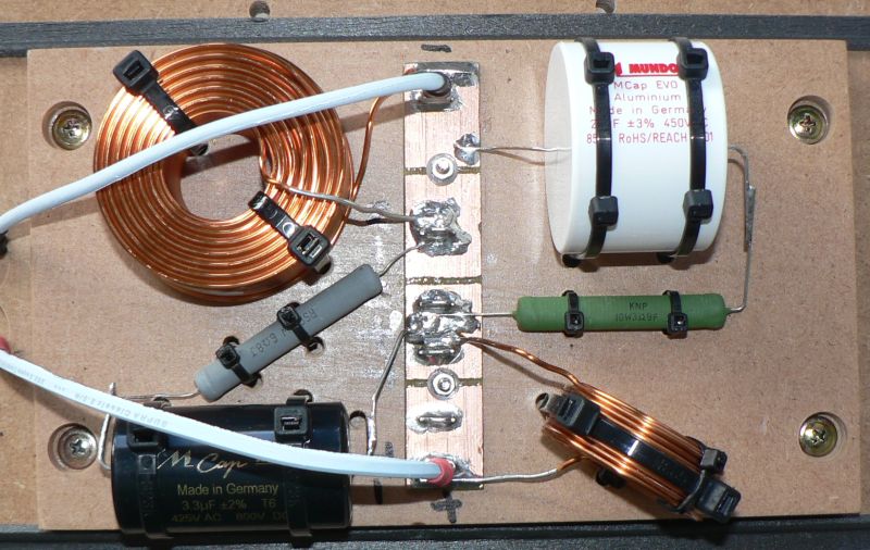

Thanks for posting this MrSllez as I was intrigued by JB's different design of a series xo. I've been designing and building speakers with series xo's for almost a decade and a half with some being classic first order series but most being AR series but had to try out this JB xo.

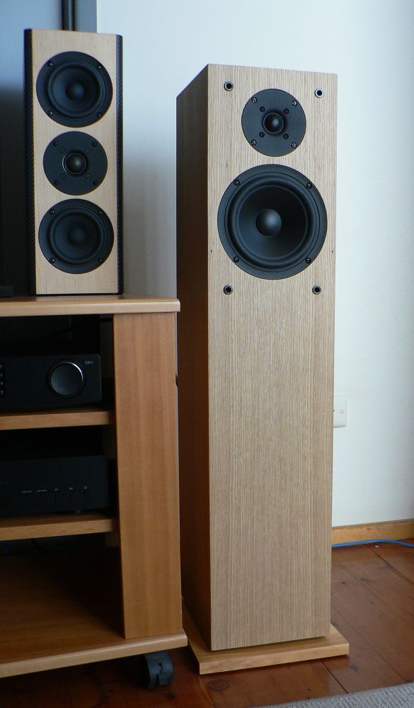

This is the second time I've built someone else's design, the first being JB Soprano when I needed a quick and easy speaker for my study to replace the D27/P13 speaker I designed for the diyAudio ref speaker thread. I had all the parts except for the tweeter, so the Soprano was an easy choice as I do not DIY any more and only had to do a cut and shut on the P13 box.
I gave away my 810921/18W8531/M22WR main speaker as my needs have changed and have been using a small 4" MTM for music and HT driven though a stereo amp. The Tributes allowed me to use the MTM with the HT amp and the Tributes on the stereo amp. All the drivers are less than what I paid for one 18W8531 a decade ago which makes it a bargain and great bang for buck.
All I can say the Tributes are a very good indeed. Very nice tonal quality/balance, enough detail, non fatiguing and able to carry enough body of the music with adequate bass. I designed my own floorstanding box and used standard vented Vb=18 litres, Fb=43Hz. The volume is reduced by an angled panel in the lower part of the box.
I've modelled the Tribute xo in SCD to see how it operates and there is some flexibility in the resistor size but the 3R as per design works well on most music. Maybe in far future I'll try a AR series xo as this would drop the load on the tweeter by around 10dB at Fs and provide an amp friendly flat impedance but would not sound the same as JB's xo nor would have the attributes he was after in the design.
Congratulations to JB for this well thought out design and keeping series xo's alive.

Love the Mundorf MKP caps!! If you find them a little too dark, let's chat. 🙂
But seriously, they are my goto-cap when I don't want to think about it. 🙂 In some cases may be a wee bit dark, but fabulous low level detail. Some of the best Mundorf makes IMHO.

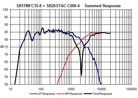

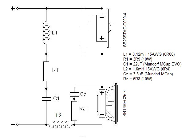

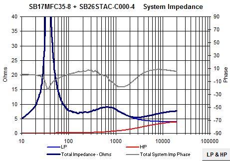

In post #5 I said I my try an AR series xo with these drivers and I've done just that. I'm not saying it's better than Jeff's excellent xo but is different in sonics and is more suitable for my use as well as I am working with different box volume and bass tuning. I won't go into any personal subjective impressions of the alternative AR series xo.
It drops the tweeter to 18dB down at the tweeter Fs, BSC is increased and the impedance plot is smoother and ranges from 9R to 5R45 from 100Hz which is better for my LM3886 based Arcam A19. Phase over the crossover is very good as can be seen in the reverse null FR.
I'm posting this for reference only for any future builders using these drivers and not to disrespect Jeff's excellent design. In fact the xo was designed using Jeff's SCD.

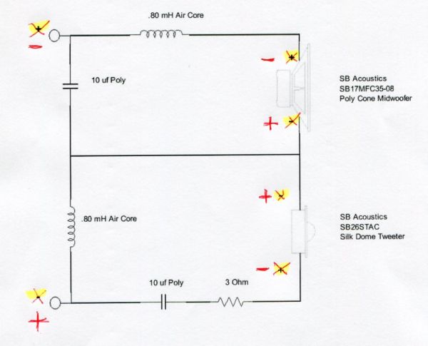

You may want to check your xo wiring as it is a series xo and sequence of wiring is important. I didn't notice JBs xo as being too bright on the top end. I only noticed the tweeter Fs being pushed.
Also check your tweeter polarity. The other thing you can try is adding a 10R - 15R resistor parallel to the tweeter (from +ve to -ve terminal).
Should make no difference but my standard series xo's are wired a bit differently with the +ve input to the tweeter line (not the woofer). i.e. +ve in > 10uF > 3R > tweeter -ve > tweeter +ve > woofer +ve > woofer -ve > 0.8mH > -ve out. The parallel 0.8mH and 10uF remain the same. I've not seen it wired like JBs before with the +ve in to the woofer.

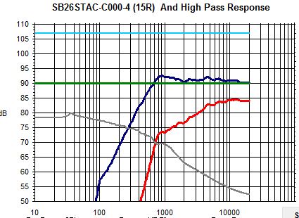

The AR series xo would be fine in the Tributes box as the effective baffle width is the same but you can do some changes to the existing speaker.
Your use of the tone control to lower the top and increase the bass does point to some things you can try.
1. Check your wiring and driver polarity.
2. Add the 15R resistor parallel to the tweeter as will attenuate the tweeter without upsetting the filter, phase etc. It also has the added benefit of helping with a bit more BSC and driving the tweeter lower at Fs plus the roll off is smoother (see graphs for tweeter without and with 15R). If you need more, then use a 10R.

Thanks for sharing all of this! I've spent the weekend soldering and listening.
1. The wiring for the original Tributes crossover looks to be proper when comparing to Jeff's document (with the - to the woofer, not as you've mentioned with the + to the woofer). I have not tried it that way... yet.
2. I went straight to adding a 10R resistor in parallel to the tweeter and wow, now things are starting to come together. I still feel things are a tad on the bright side, but things are sounding quite workable. I wonder if the current drivers have different sensitivities when compared to the ones Jeff used when voicing the Tributes?

Jeff's schematic I have has +ve to the woofer so there may have been some confusion in my alternate description. I've add his schematic (yours may be different) with polarity changes I was on about.
Glad the 10R parallel resistor helped. If you want to attenuate the tweeter a little more, change the 3R to 3R9 which doesn't upset the filter characteristics (could go as high as 4R7 only if absolutely necessary). Any cap or inductor changes would be detrimental to the design goals. I have never noticed SB Acoustic drivers having great variations (very well made).
