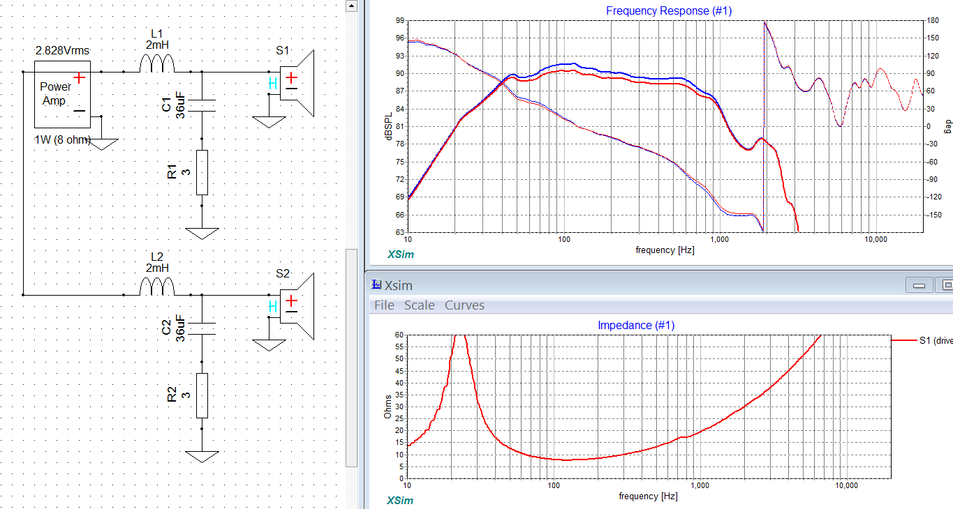

@ Kevin, indeed. I've rigged up a test, it's a random driver and crossover. One inductor has no resistance and the other, 1 ohm. While the responses are not the same, I'm thinking that maybe you could get away with treating them as though one has fallen slightly in level.
