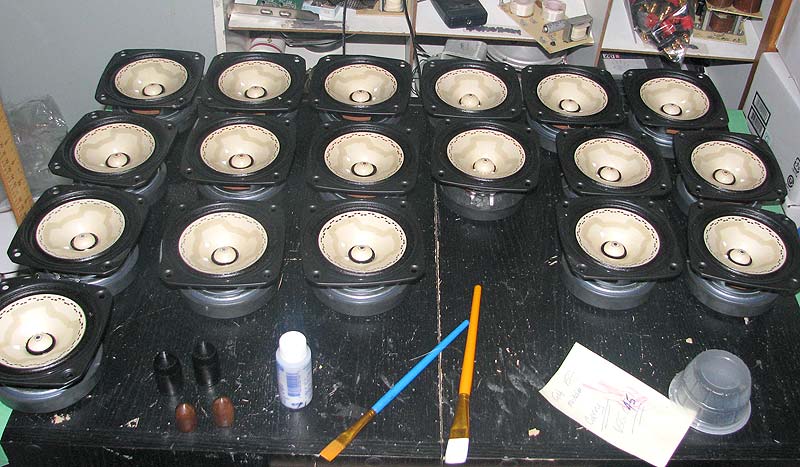

EnABLed 166
That's what I really want.
To EnABL the FE166ES-Rs in the pair of ron's Austins that are my main speakers.
Has the pattern for 166s been developed yet; is it available for us mortals?
Robert 🙂

Robert,
Just to wet your whistle. Go here to see how and where EnABL patterns would be applied. The cone for the 206 is the same design as found on the 166 and the patterns will be identical.
http://picasaweb.google.com/hpurvine/Fostex206ERev/photo#5138741727456026706
You could adapt the Lowther PM6A pattern guides to this cone, just by % of size change in the acrobat printer controls.
Also, you might trek over to the Hawthorne site. In their forum on speakers I have posted to of three primers on EnABL materials and techniques. I will migrate them to the EnABL thread here at DIY when they are complete.
Mostly, you want to practice a bit, on some really cheap cones. You will be delighted with the results.

I've done 2 pair of FE167e (so yes, i have patterns), and have a set of FE166e on my bench (for Ron C). My next order i'm going to get another set of FE167 and a set of FE166 (for Clark if someone else doesn't scoop them up 1st). I've yet to talk to Bob )a local) about doing his FE166eSR. I'm doing a set of FF156K for Frank to try (after which i wouldn't be surprised if i get a shot at his FE206eSR) ... it just takes time.
dave

EnABL patterns
So... should I just use the Lowther PM6A pattern on my FE166ES-Rs?
Thanks, Robert
Thanks, Robert
Yake any of the disk patterns and scale it until it just fits the part you are going to EnABL, Then shrink it to 85-87% of that to give enuff room to actually put the pattern.
I used A4 tip (with fat strokes*) for the main rings, #56 (or rapido) for the inner dots, A5 for the whizzer edge and under the whizzer (the hardest part). I do under the whizzer last & use the patterns already on the cone as guides.
