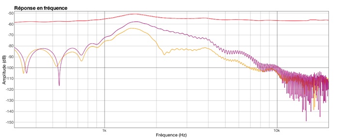

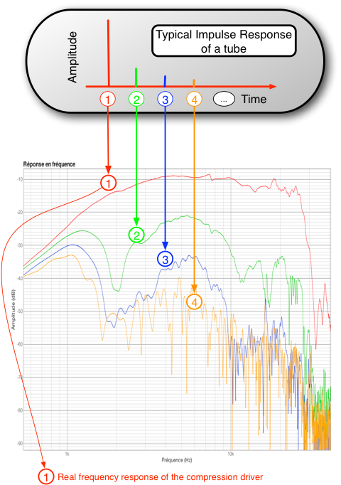

Thend - what are you calling Fs? Is it the resonant frequency of the driver with no horn or tube attached? That often shows as 2 large peaks, the Fs being in between those two.
Fs is just only the resonant frequency of driver, just the mass-spring system that is not really visible in the case of compression driver (cavity).
And I assume that Fa is the cut-off freq. of the horn?
Yes:
We note also, the horn reduces the amount of energy which returns in the approach of its acoustic cut-off frequency (Fa) as explained on its page of origin.
In view of this two documents, we can conclude that the acoustic energy returned by the horn can be absorbed by the compression driver at its resonant frequency (Fs).
I'm trying to search something more clear, idea?
How is that determined?
By conception (I'm not specialist), by manufacturer documents or by measure.
But instead of get an Fa depending Fs, maybe we get a Fs depending Fa by changing the rear closed volume like a closed box and its Fc.
I only have BMS driver and it's not possible with it.

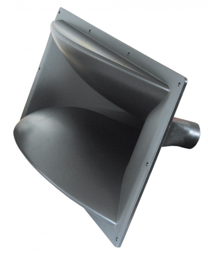

Hello Earl,
The mentionned OS waveguide has the curved mouth you recommanded.
This rounded mouth you recommanded appears to not be efficient to reduce drastically reflection of waves at the mouth.
Even if a round mouth could solve that problem, the throat impedance of the OS waveguide will still be at best comparable to the impedance of a short hypex horn calculated for a tweeter.
A Le Cléac'h horn of the same size will bring to the driver a perfect acoustic load at a frequency 3 times lesser and this is quite well reflected in the measurements (e.g. waterfall).

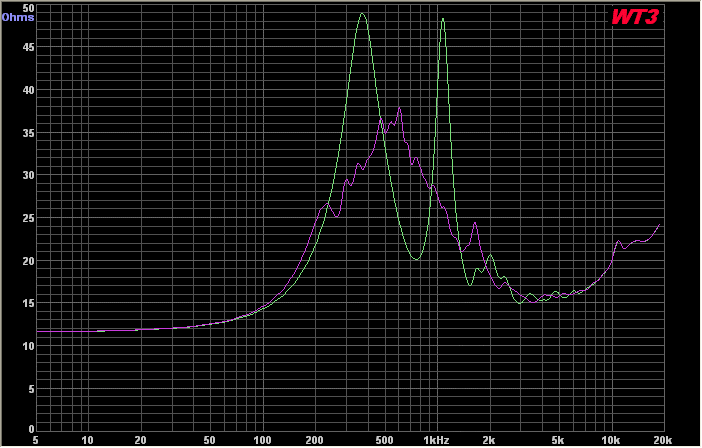

Hmmmm......, Hmmmm.... Yes maybe. But how to know what is Fs? Electrical measurement? Below is a graph of an Altec 291-16K driver in free air (2 peaks) and on an Altec 803B horn (1 peak).
I believe the Fa of this horn is about 130Hz. It's meant for use down to 300 Hz. Would be interesting to see what a larger rear chamber does to the impedance curve.
Precisely on that page, I shows 2 differents ways to know Fs.
An acoustical, see the green curve:
And an electrical, the maximmum of energy captured (absorbed) in the first echo (purple and orange) corresponds to Fs.
Note: This BMS have one peak at Fs (red, pure impedance curve with 1 meter tube long).
For more detail, see the rest of my site.
I dont know, maybe the "free air" Fs of this driver is above Fa anyway.
And a classical compression driver which can reproduce the 130hz without ditortions, I do not really believe.
To measure impedance, it's better with tube for discriminate the reflection of the driver mouth.
