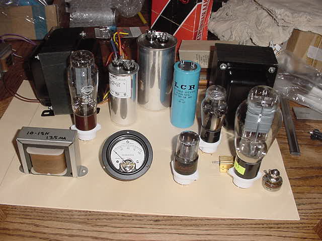

Well, the tranny's arrived in a timely fashion. Some shipping damage. Some of the laminations shifted, I called Jack at Electraprint and he said that I could loosen the bolts on the trannys and put them on a solid flat surface, gently put them back into shape. Seems ok to do this.
Ordered the copper plate (12.5"x 16" x .125") which leaves lots of room to manuver the various parts.
I have posted a pic of a temporary layout for this design. My question is, should the signal tubes be grouped away from the rectifier tube and the a/c mains input?
I know to orient the pwr and ot tranny's at 90 degs. to each other, the little one is one of two chokes for B+, the other one is small, so I will mount it underneath the top of the chassis. where can I buy a shield for the bigger choke? Hammond make some thing ?
Any way here is the pic, any suggestions? comments?
Thanks again

Hello,
Nice stuff you got there.
Yes,that is good practice.
Input close to front,work your way to the back where you can put on/off switch close to power inlet on one side and speaker connectors close to the OPT.
No need to shield the choke unless you're concerned with the look of things,you re doing fine.
You can also have a cage made out of sheetmetal to go over the grouped iron a la Audio Innovations.
Regards,🙂
The layout is probably fine. However when I used to build everything on one chassis (I use a seperate PSU chassis now), before I drilled holes for the power and OPT trans, I would power up the PS, and adjust the orientation between the two of them, and often the choke too, for minimum hum at the OPT. With the OPT not connected in circuit, check the primary and secondary on a DVM and/or a CRO for minimum 50/100Hz. Ninety degrees will probably be fine, esp with a PP amp, but a fine tuning of the position can kill a hum that you may not otherwise easily remedy.
Ideally I would complete the entire circuit, run it for a day, trim the hum with the cathode humpot, and then, tweak the positions of the tranny's for a null in the hum.
