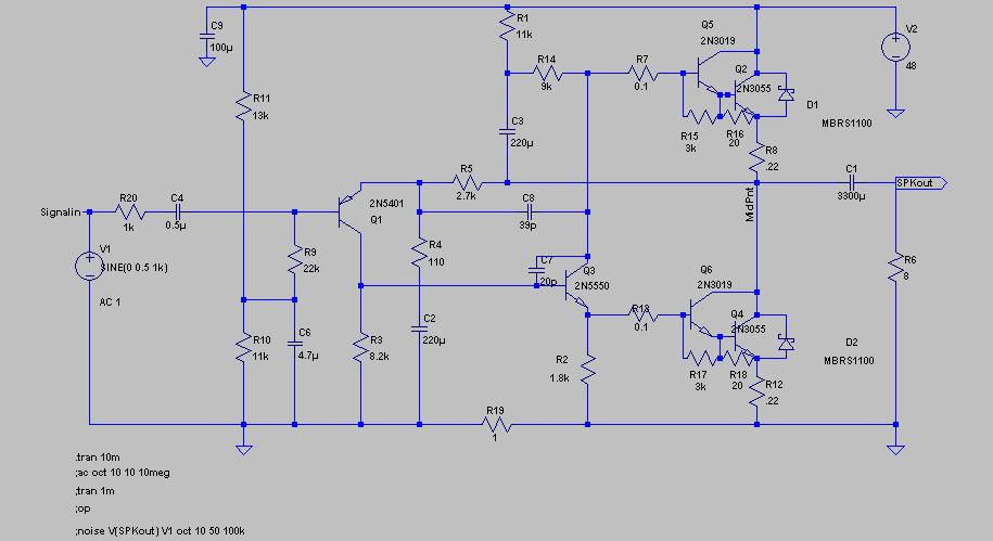

Interesting, can you help me learn more ? ....The input device develops a voltage across R3 which is fed to the base of the phase splitter/driver device. But R19 kind of gets in the middle here, not sure the rationale for R19?
And I don't understand how this design is different from JLH other than the Darlington outputs - the JLH itself does not go nicely into ClassB so what is different here that I've missed which makes this suitable for use with low bias current ?
Good question! R19 is only for modeling and test purposes, otherwise it is difficult to know the current through this section of wire or how ripples will affect the performance. In the real implementation R19 should be replaced by a jumper. The JC2012 output stage is composed of a Darlington pair which allows the amp work in class-B. Hood's 1969 design is not able to do so. In other words, if you bias the JC2012 in class-B(typically 30mA), it works almost as good as a class-A, but the power efficiency is around 70%. However, if you under bias Hood's 1969 design, you will get serious distortion.
Its not different, its just Darlington. The drivers in the Darlington
pairs are still JLH Class A (at a much lower quiescent than usual),
the output of the Darlington pairs are current dumpers in class B.
Nothing wrong or cheating about this solution except calling such
pairs with two transistors and two resistors apiece "discrete".
By such reasoning, I can design an entire JLH headphone stage
from one 74LS04 hex inverter and thereby call it one "discrete".
And yes, I actually did that sometime back, intended only as a
joke. But look sometime the internal schematic of that chip and
tell me it isn't JLH, just waiting for a feedback loop to be closed...

The JC2012 is essentially a Death of Zen with Darlington outputs. The DoZ is similar to the JLH but swaps a CCS for a driver, with bootstrapping added to drive the upper half. Both concepts have their problems with load immunity, though in case of a Class A headphone amp the JLH gave better simulated performance due to higher O/L gain. B/AB operation is a different story.

The JC2012 output stage is composed of a Darlington pair which allows the amp work in class-B...
ah, I think I see what you are doing. You have a JLH Class A, the output is connected to the load and you have in parallel a pair of power devices biassed in Class B also connected to the load whilst being steered by the Class A drivers. Broskie might call it an 'impedance converter'.

What I can ensure everybody here is that this structure does work in reality! Although I have no instrument to measure the distortion, the spice simulation result show that this design has a distortion < 0.03% while outputing 9W to a 8ohm load. This is working in class-B, in which the quescent current is less than 100mA for the whole amp. You can expect even lower distortion when this amp works in class-A. The only thing that you need to take care is to control the themo dynamics within the amp. This can be easily accomplished by using Iq control circuit. Enjoy DIY.

New simulation result. The open loop gain when using TIP142 is 96db, while the open loop freq response (-3db) extends to 16k. Compared with the original JLH1969, which has an open loop gain of 55-60db and open loop freq response extends to around 100k, the darlington output design still has its advantage. The only problem now is that I seem to cannot make the 142 work thermally stable. This problem does not show up when building the darling by using two separate transistors.
Does anybody have any idea how to stablise the darlington output stage?
Jazz
Your problem is a fixed bias into drivers that are not at fixed current gain.
Because they share the same package as transistors doing the hot work.
You cannot rely upon a fixed sum of steered bias currents (R14?). You may
need to add current sensors of low power dissipation, external to the output
devices, to feed back temperature independant information for bias control.
Then you have a choice to series limit or shunt away your excess bias.
You can either shoot for class A, and bleed away excess bias to shape AB.
Or shoot for Class B, and add extra bias to shape AB. Either way, you need
a quadrature (at 90 degrees angle to voltage) feedback loop to control the
bias that R14 is now bleeding at some thermally blind constant.
Your other option is to keep all current gain devices at known temperature.
Darlings won't cooperate with that scheme, as you already know. Rely upon
hot devices to shape AB, its probably gonna run away...
