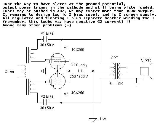

I was wondering about two potential issues with this circuit:
To which potential do you bias the heaters? I always disliked large voltage differences between heater and cathode, especially large signal swing. Not necessarily an issue with all circuits and tube types but a potential source of problems which I prefer to avoid.
Second is the signal swing which is imposed on the secondary of the input transformer. Not sure if that might be of any relevance. At least there is a shunt capacitance from grid of U2 due to the capacitance between the windings of the transformer. The impact of this depends on the quality of transformer I guess.

The schematic that Jaap posted makes much better practical sense than the earlier B- version.
No input xfmr capacitance loading issue, the pentode is actually running as a pentode here, and a CF is used to handle the high Z output from the 1st high gain stage. Only thing missing is a gyrator mod to the Mu follower/CCS, or some type of servo feedback to the pentode screen, to keep the idle output voltage of the 1st stage under control. Looks like the Aikido type CF stage got used for PSRR.

hey all, thanks for checking this out. thomas asks a fair question and the answer, on the surface, is a bit dodgy. it all depends on the application. i have to say that just asking this question indicates a much better knowledge of tubes than most. i will start by saying one thing: grounding the heater is never a good idea... it should be lifted or dropped, or left floating, always. get it away from ground. the heater draws 10 - 100 times the current of the amplifier stage... you want that circulating on ground?
as to your question, is it a preamp you are talking about? drop the heater to the level of cathode of the first stage... you're done. it will be -150 to -70. the swing is a volt or two, max. you think the parasitic C of the trans is any different floating than fixed?
is it an amp with a large signal swing? you need to think about it. a 6922 is not a good choice for a 300B amp... 50V max heater to cathode V, 100Vpp. you need 180PP to drive the output tube. your question is spot on.
a 12AU7 (and nearly all other commercial small signal tubes) has 100V heater to cathode rating (200Vpp). you're at the hairy edge here. ever consider a directly heated tube? a 2A3? no problem. TV sweep tube? doesn't even notice... etc. 6L6GC? you get the idea.
many people are blissfully unaware of the parasitic diode that exists between the heater and cathode sleeve in an indirectly heated oxide coated vacuum tube. and even fewer know what it does when you exceed this rating. the heater is made from nichrome variants and is smothered in aluminum oxide before it is pressed into the nickel sleeve of the cathode. these chemicals are always good quality, but there are always traces of other metals and semi-metals. its nearly impossible to get it 100%, not commercially anyway. not even WE.
the work function of nichrome is extremely poor, but it is very hot. 1100+ kelvin, roughly. at that temp, even nichrome has an emission. if you get the voltage potential high enough (exceed the heater to cathode voltage rating) , ions are drawn to the cathode, through the "insulating" schmutz. as someone once said, "everything is electrical" and that goes for insulators too. the few (large) positive ions that are freed can "poison" the environment of the vacuum tube with pure evaporated metals. one positive ion can do a lot more damage than years of high voltage acceleration of the negative ones... the common ones are aluminum, molybdenum, and of course, silicon (effing bad). the temp of the interior is not hot enough to make nickel or iron gas, but these other lovely things make their way to the other side of the cathode where they form an "interface layer", a semi conducting or outright insulating layer of stuff on the active surface of the cathode. emission goes down, noise goes up, and the tube dies. this is also quaintly known as "cathode poisoning". makes you wonder about marshall and mesa boogie using cathodyne phase splitters with grounded heaters and 260 volts at the cathode of one section of a 12AX7... hmmm. do they ever read a tube manual? oh yeah, that's a guitar amp. if you ever wondered why the splitter/tone stack tube dies out with one bad section, that's always the same section... oh yeah, its those damned russian 12AX7s.
anyway, the circuit is fun and makes it possible to do some very simple dc circuits. if you do phono, the trans is a great help because you can maximize noise performance, block hum, and get a built in rumble filter with one handy part. of course it has to be good. you want to use bad parts?

In that circuit I would connect the heater circuit to one of the cathodes, but I'm not certain which one.
U1 cathode would prevent the heater-cathode insulation from forming part of the load for U1 - h-k insulation is never perfect so you don't want a non-linear resistance from the cathode to ground. Normally, grounding a heater circuit is a sensible thing to do but not here. Note that grounding a heater circuit is not the same thing as injecting heater current into the ground, unless you do it wrongly.
U2 cathode would make it harder for the heater circuit to inject noise, as this is a low impedance point. So the choice is: do you prefer noise or distortion?

The usual textbook concept of (signal-) ground and algebraic signed supply voltages is a rather arbitrary one, I am sure you would agree.

Hi JC,
thanks for your reply. I regret that I couldn't make it to the ETF this year.
As for referencing the heater: I routinely bias the heater slightly positive above the cathode, around 20V or so. Exactly for the purpose of biasing the parasitic diode from cathode to heater, so that it doesn't conduct. I avoid larger differences in the order of 100V, even if it is within tube ratings. Might work out for some tubes, but many develop some problems after some time with such voltages between heater an cathode.
I was not sure if the circuit shown was for preamp levels or if it shows a driver and power output stage. In the latter case, the signal swing imposed on the sdecondary of the input transformer could be in the order of 50 to 100V RMS, depending on the voltage swing required on the grid of the second tube. I agree, if we're talking a Volt or so, I wouldn't worry about this.
