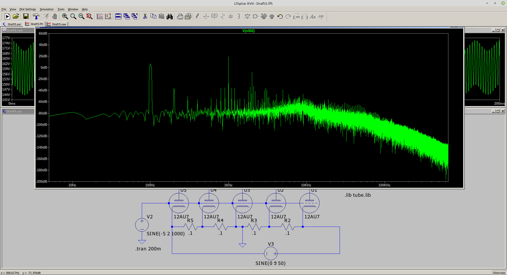

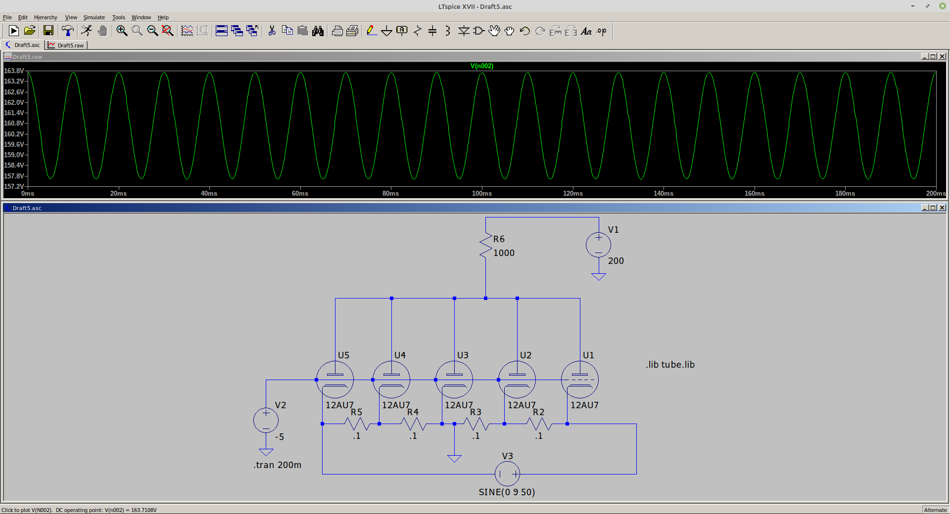

Does the filament go back on itself and does this have make a difference to the effect or does the filament behave as two separate cathodes.
I put this on another thread - I idea is to model the distributed cathode/heater with 5x12au7 in parallel. It compliments Mr Summers' fine explanation rather well.
baudouin0,
Perfect!
I never could find the new thread, so I came up with this:
That is a great idea, and a good application for simulation software.
(and I do not even like simulation software, or any software)
I am not certain, but it seems you have 200V on the plate load resistor, and -5V grid bias.
I suggest putting a "desired" 0.707Vrms 1kHz sine wave signal (1V peak) in series with the -5V bias.
I do not know the meaning of: sine 0 9 50. 50Hz?
A 300B filament is 1.25A at 5V, so it is 4 Ohms resistance.
I suggest using a floating 5Vrms 50Hz sine wave across the end-to-end 12AU7 cathodes.
But change the resistors from cathode to cathode to 1 Ohm each resistor (0.1 Ohm needs too much current at 5V).
The 5V floating sine wave will never be more than 2.5Vrms (3.54V peak) above 0V (at either 'end' cathode).
So, -5V bias +3.54V peak = -1.46V on the grid with respect to the cathodes that are on the end.
And that leaves the 1kHz 1V peak sine wave on the grid to bring the grid to within 0.16V of the cathode.
Now the question is, what is the FFT result of simulating it that way?
I bet there will be 900Hz lower sideband, 1,000Hz desired signal, and 1,100Hz upper sideband.
That will simulate a response of a 300B with AC filaments.

Sorry sin 0 9 50 means sinewave 50Hz with pk of 9V (approx 6.3V rms). I used .1 R resistors. It does not actually matter the idea is that the cathodes get the correct ratios of the hum with the centre valve getting none. Its like breaking the heater/cathode into 5 sections. The 5x12au7 is not the same as a 300b its just to illustrate.

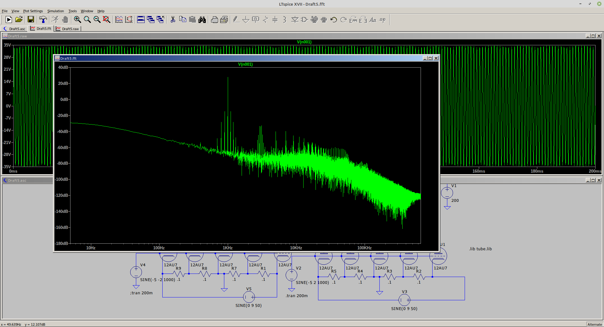

Here's a 2v peak sinewave added to the grid.
This is a PP version. The 100Hz cancels but the 1KHz side bands do not.
