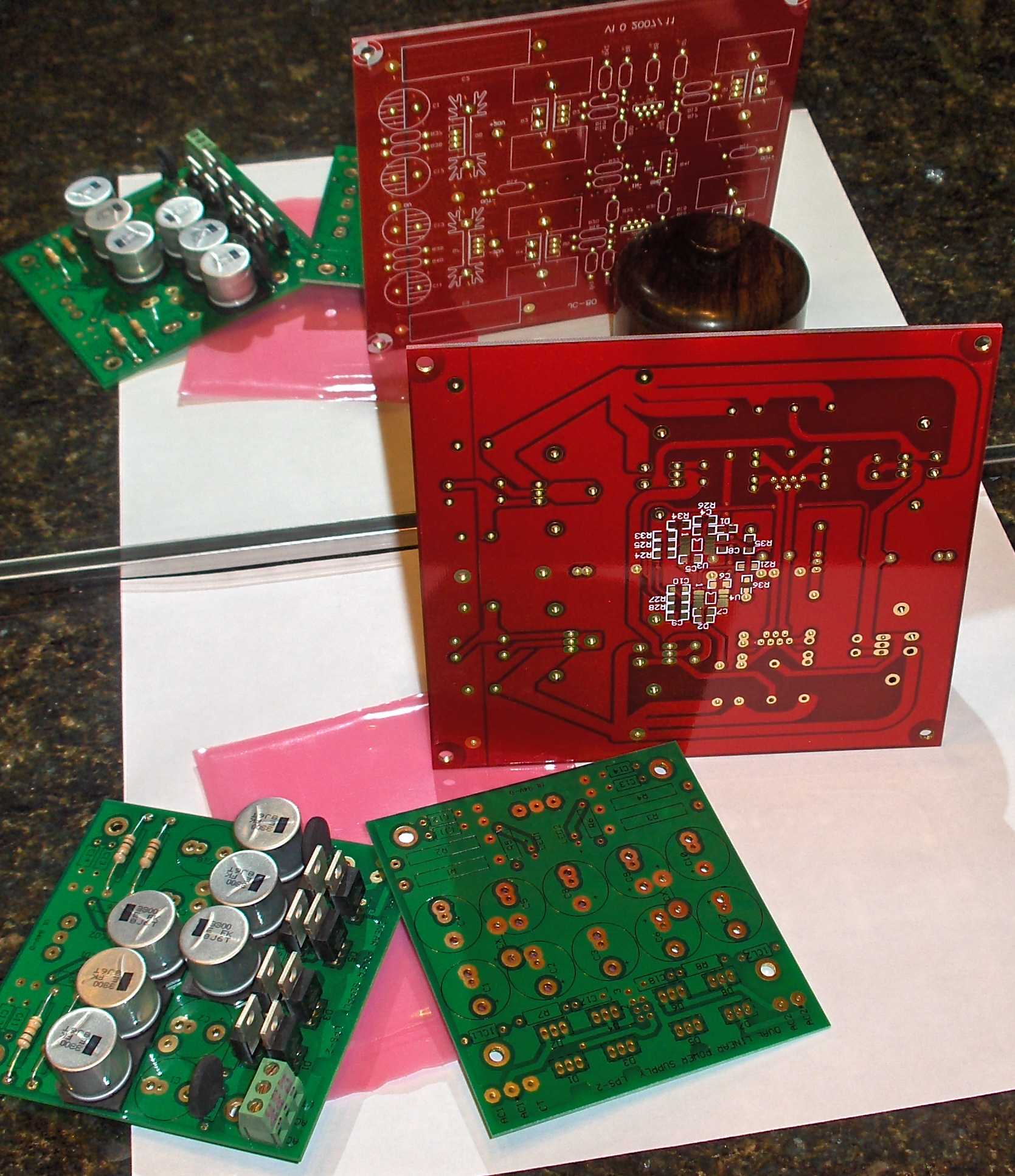

Images of JC-80 (servo in middle) & candidate PS
@kamis -- "resistors across the CM chokes coil?" should make sense to me because I am reading very carefully. Is that a reference to material outside this thread?
I will reread TorchPartI for details of the caps 'n choke combo used because I do not yet understand it well enough to spec parts. The PS PCB I had started is sufficiently flexible to allow for all of the requirements I understand except, possibly, the choke. I am attaching a photo of that board in the hope that a reader may know a source for additional copies. It is gold plated on a nickel substrate and measures 92x95mm.

From ticknpop, "just the film cap is required - the value or tolerance isn't critical it's construction (film and foil prefered) [is]" There are LOTs of available Soviet teflon caps ranging from 0.01 to 0.1uf. The smaller values physically fit better and are silver. They are NOS "well aged" about 20 years. A .022 fits perfectly and the shipped cost is below new tin-polyprop. Is this a good choice?
Have ordered enough used 22R Caddocks and NOS Toshiba 2SK2013/2SJ313 for two PCBs. The caps are the last non-PS part to not be ordered thru DK or Mouser. Anyone wishing to build can use the BOM supplied with the PCBs to identify components not specifically called out in this thread. The PS will need some special parts and I plan to eventually upload a BOM for it. I shaved about $50 off the cost of a pair of these boards by "going cheap" -- that's about 25% cost savings -- but hope to have not compromised the build quality.
I have attached a copy of a schematic from TorchPartI as a basis of reference for discussion. It does not show resistors for the CM choke referenced earlier by @kamis. I would like to cut back to dual secondaries on a single transformer, same diode count, CM choke, single pair of LM317/337 (i.e. shunt OR . . . left out) and no linear on PS. Is there a different, more representative, schematic I should have used? Am I wanting to leave out too much? Where should the anti-ringing resistors be added if required?
