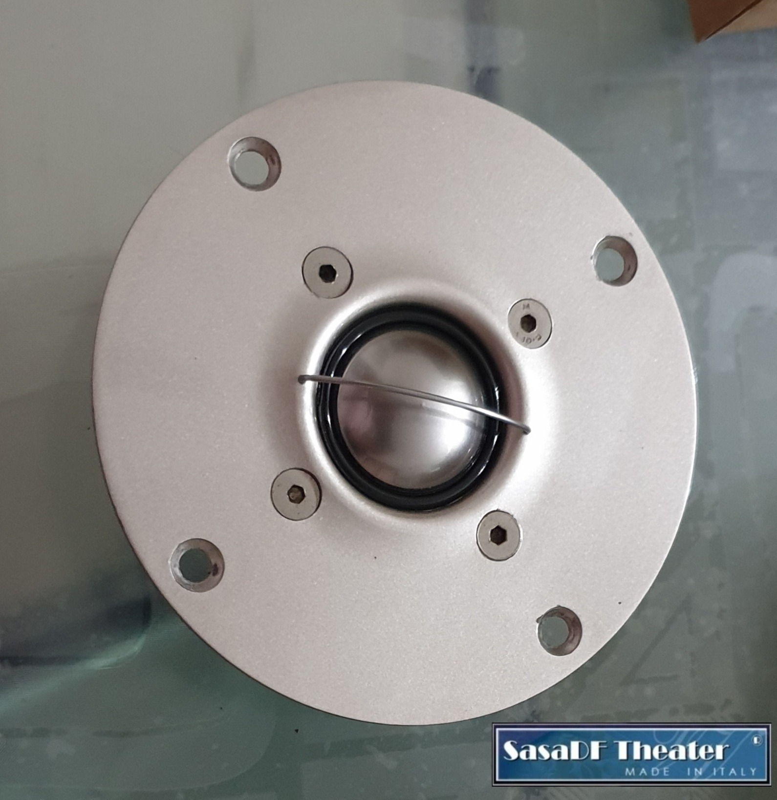

The Audax are the same identical tweeter yet installed.

they are not Focal
tell me the reference of this tweeter Focal
are Audax from the Harman Kardon factory
the tweeter grille can be changed to the original silver one
I rectify
the JBL TI6K tweeter
After measuring the 2 tweeters, the DC gave 6.7 ohms and 7.1 ohms
conclusion; they are 8 omhs Audax
This one;
